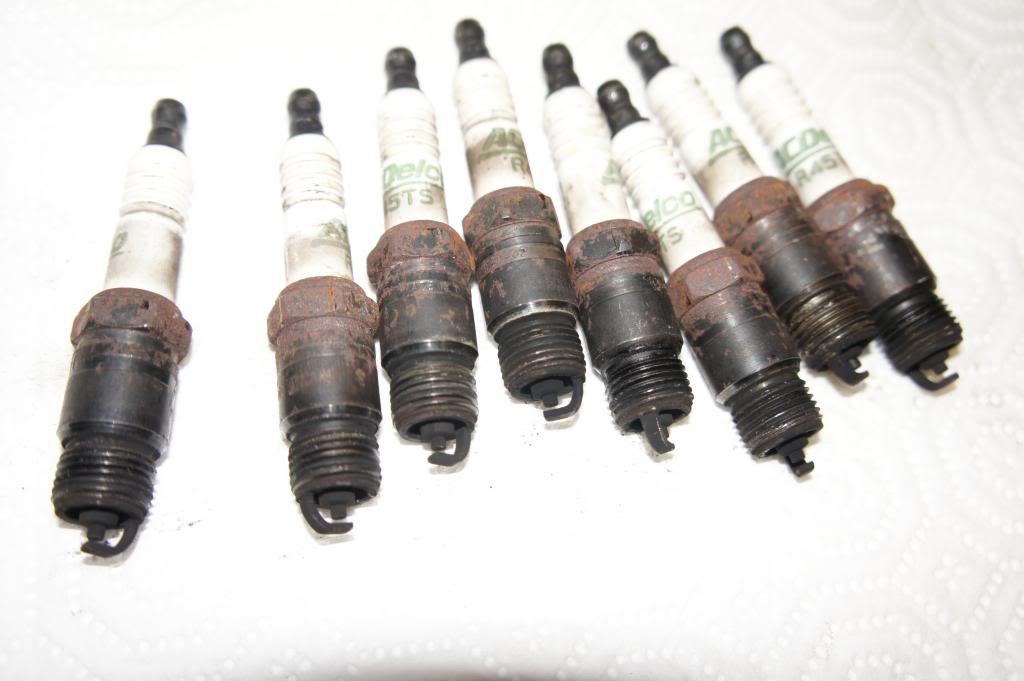

Old Dec 11, 2012 | 09:05 PM
Zach/90\irocZ's Avatar
iTrader: (6)
Joined: Aug 2011
Posts: 2,381
From: San Diego, California For Now
Car: 88 Formula, 90 Iroc RIP, 92 RS Sold
Engine: 305 to 350
Axle/Gears: 10 Bolt
Re: yet another issue cranks not start is wet fouled the issue

Old Dec 11, 2012 | 09:09 PM
Tuned Performance's Avatar
Community Influencer
iTrader: (95)
Posts: 16,926
Likes: 1,016
From: Mile High Country !!!
Car: 1967 Camaro, 91 z28
Engine: Lb9
Transmission: M20
clean up the center and ground electrode man thats alot of fuel soot.
Old Dec 11, 2012 | 09:17 PM
iTrader: (6)
Joined: Aug 2011
Posts: 2,381
Engine: 305 to 350
Axle/Gears: 10 Bolt
yea i know lol i was expecting that tho so thank god no surprises lol i dont like those im going to call it a day tho flashlight one hand and wrench in the other it was dark when i got home and its kinda chilly outside
also is there anything i can spray inside spark plug holes to clean up chamber i was thinking seafoam or b12 chemtool which ever is at the auto store ?
edit: like you said in pm i crank engine with gas pedal to the floor after i removed spark plug it just seem the right thing to do
