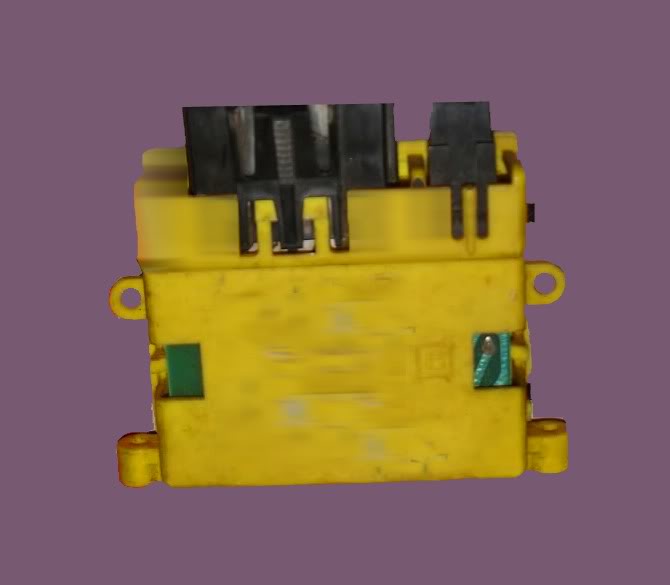

Speed Reading
Gain access to the buffer which looks like this:
It’s located behind the instrument panel at the right.
Connect an audio amplifier to terminal A
yellow wire to make sure it’s getting a steady signal.
Ground to ground, the signal wire to terminal A
yellow wire of the VSS.
With the car on jackstands listed for a hum from the amplifier when the rear wheels are rotating.
If you do, then find out if you get a hum from terminal C
tan wire.
The
tan wire then goes to the speedometer unit.
If it gets to the speedometer but the speedometer does not work, have it repaired or replace the unit.
Happy Racing!
