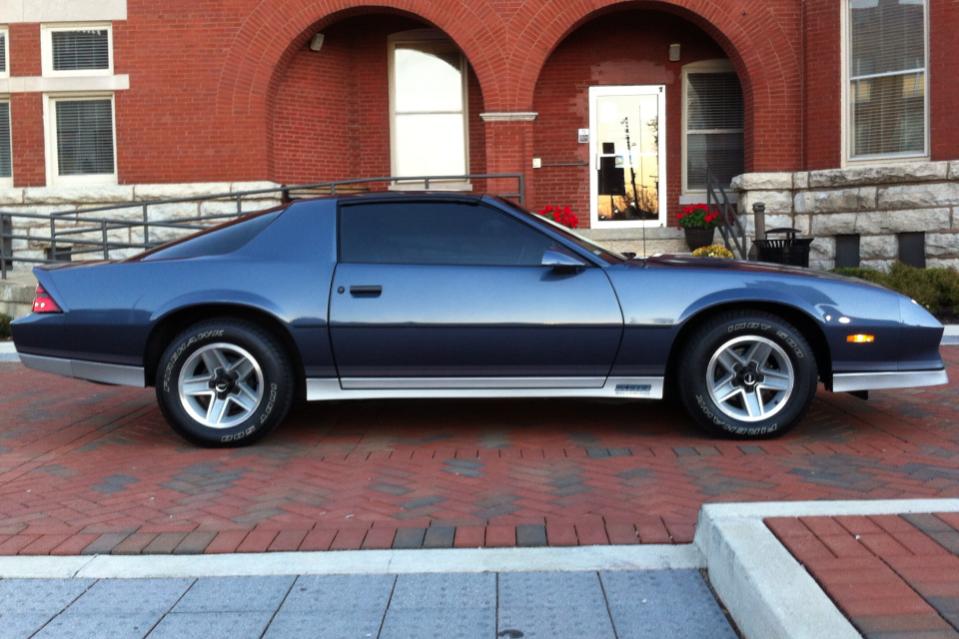

I, too, have a 84 Z28 with original 305 and 5 speed. Mine is even the same color! Nice car by the way!
Attached Thumbnails new to this need some help, thanks-img_2772.jpg   new to this need some help, thanks-img_2771.jpg   new to this need some help, thanks-img_2249.jpg

Dang man yours look a lot better than mine then when I bought mine...mine was a Piece of SH*T...but gradually ive been working on it...Ive put a lot of hours into and and dont forget the money..starting form my sound system, to the intake manifold...its a work in progress....
I really like the color of your car though the only difference with mine is thats it's white (obviously) and that I took the stock bumper off and threw on one of the late 1980's bumper on it..cant remember what year though.
