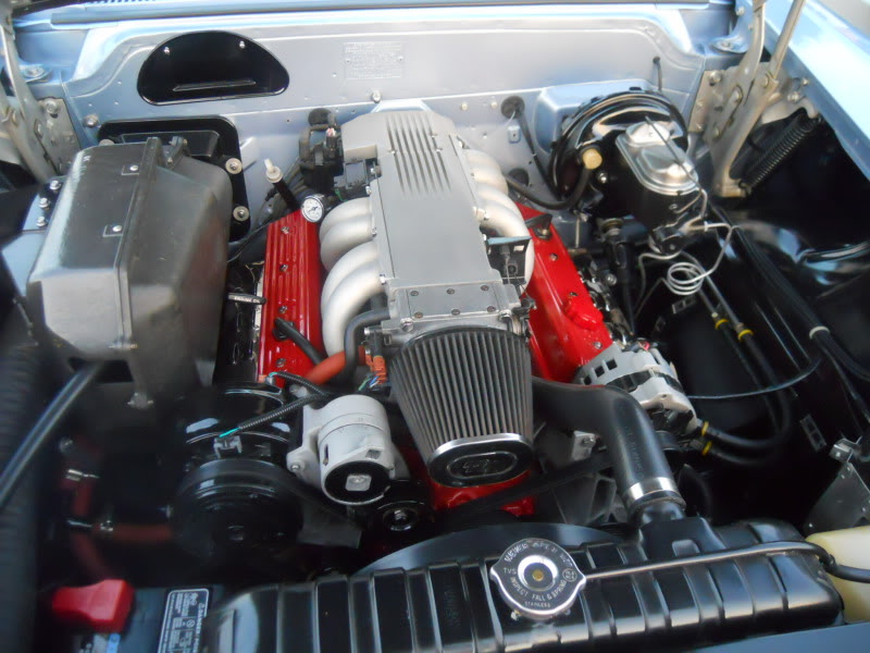

No shame in TPI. Runs really nice, it just can't scream up the tach like some other designs can.
But don't forget about the TPI best feature - it's beauty. I usually leave the hood open on my son's GTA just so I can look at those pipes when I'm walking through the garage.

The TPI is the best looking engine GM ever designed. here's one in a friends 58 impala. Sure, taking out the 348 caused the value of the car to plummet, but he loves driving the car now
