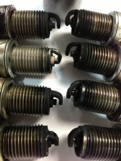

Just pulled the spark plugs and looks like most of them have been hit !
Gapped them all when they went in and only 2 look ok now - ignore the colour !!!
Is there a short plug?
What would the engine builder have done to create this problem or is it something else?

You can't set timing at idle sometimes with too large of a cam. The idle may surge too much and act too eratic.Try getting it close enough to rev up, hold the throttle open a bit and using a timing light with an advance wheel and set the max advance.
Might also make sure that aftermarket timing tab if it's adjustable is actually set to TDC properly.
Looking at your plugs though, you definitely have a dead hole, or eight! And wtf is up with those plugs!? If your plugs look like that, I would tear down and inspect the entire motor. Sounds like you got ripped off. If your plugs are that mucked up, I can't imagine the build quality (or lack there of) that went into the rest of this motor. This motor is fubar.
600cfm carb and 500hp...That's also a big negative.

ouch! what plugs are you running now? what style pistons do you have?

heres the suggested plugs for your heads from summits site.
http://www.summitracing.com/parts/ngk-7938/overview/
IIRC, ngk plugs go the opposite numbers for heat range. a bigger number is a colder plug.

Just fitted a set of Bosch plugs BR9DC i think with a copper washer under the standard washer to check if it is a clearance problem.
The plugs dont have any impact marks on them so it must be a slight touch if thats what it is?
Its fired up and idleing smooth at the moment - not given it any revs etc but need to move 3 cars out the shop to try to set it up/

They have the same 3/4 inch reach as the ones that are damaged.
hopefully the copper washer should prove the issue.....

In all seriousness. If you were lied too that this is worthy of 500hp and you just pulled out plugs that look like that. STOP! New plugs are the least of your concerns.
You need to thoroughly inspect this entire motor before going forwards, or else you may just end up with scrap metal.

Take the plugs and find some shorter ones. It doesn't look like they would have been hit hard enough to cause serious damage because the porcelain is not even broke off the plugs. Just go to a local part store and have them get you the next size shorter plug. The block could have been zero decked at the rebuild and causing the plugs to be too close to the pistons especially if they aren't flat top pistons. Don't go ripping the engine apart just yet

Metal shaved off+long reach plugs+pistons= smashed spark plugs. It's only caused by a clearance issue. The plugs are just too long

Its running much better with copper washers under the new plugs.
Ill try to track down some shorter ones next week.

Glad to see its getting better though. I wouldnt run it much without finding a shorter plug if it was me. Also nice to see you didnt go ripping the motor apart for no reason.
