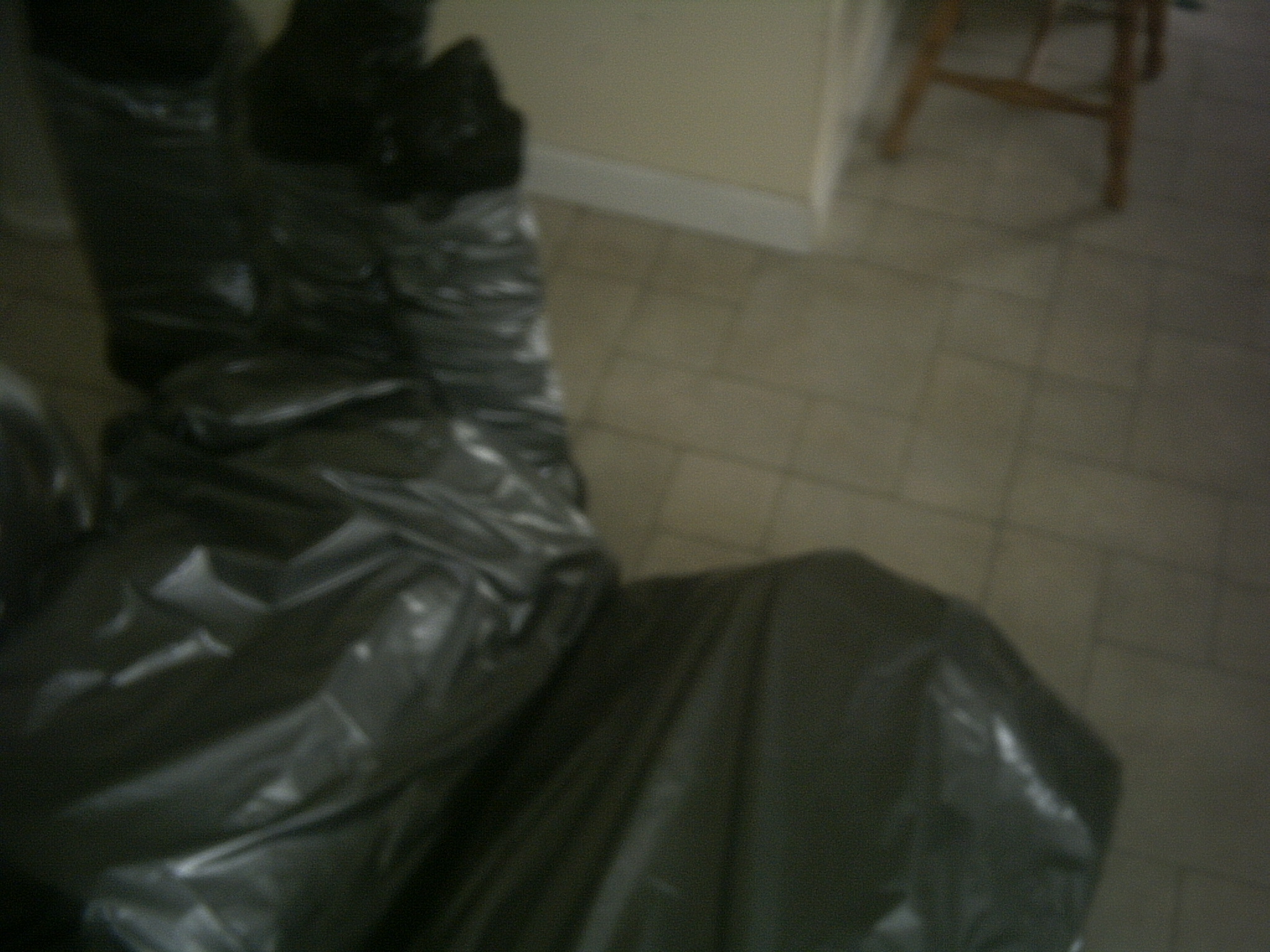

Re: need to store some engine parts and was wondering if this would work
Got the LSP 3, spraying the stuff down and putting it in trash bags and put them in my basement.
The LPS 3 you want to spray upside down like you would a paint can once done spraying to help from clogging.The bags we use comes from Home Depot which are the large contractor heavy duty thick mm plastic that comes on a roll.The 22oz size will go a long ways.Your notice while spraying it goes on like syrupy which is the paraffin content of the protection.As I said the next purchase we make will the bulk container size because it does go so long that storage over the "yrs" became a issue with the cans clogging up.
