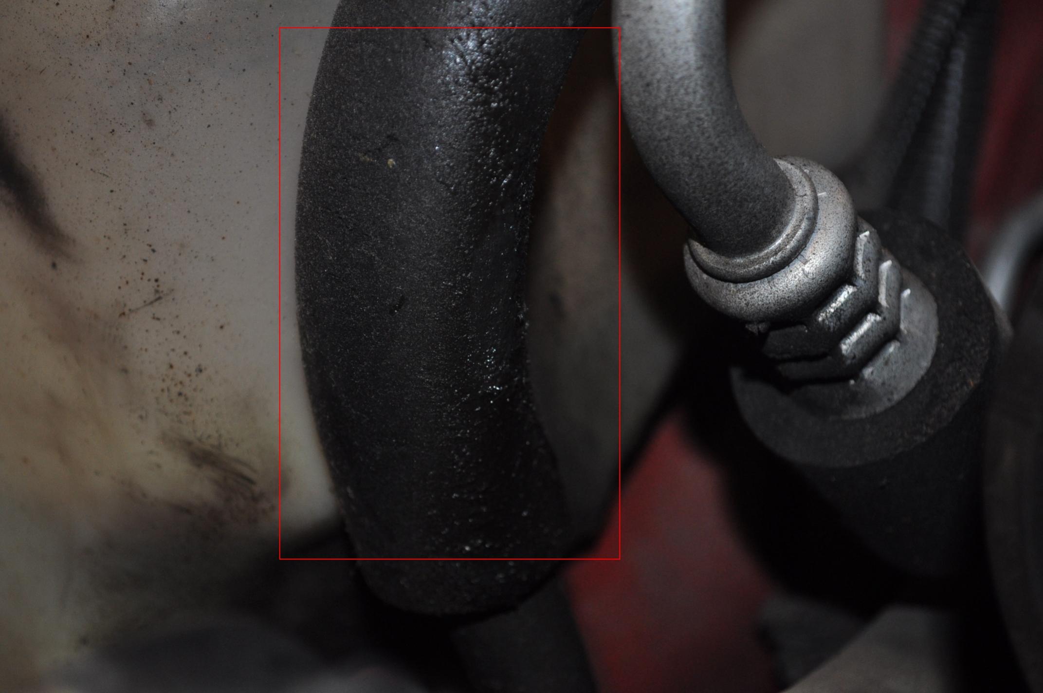

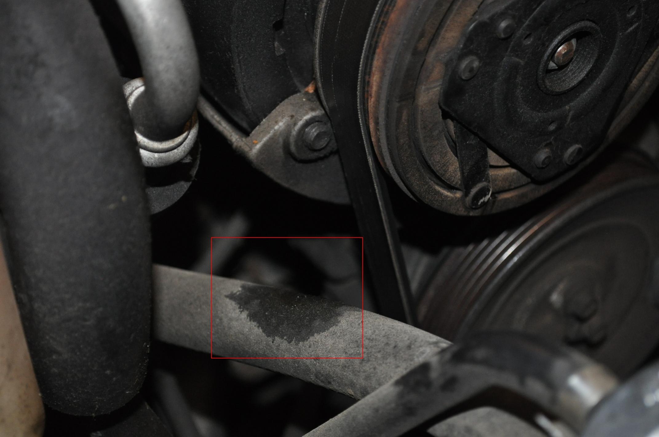

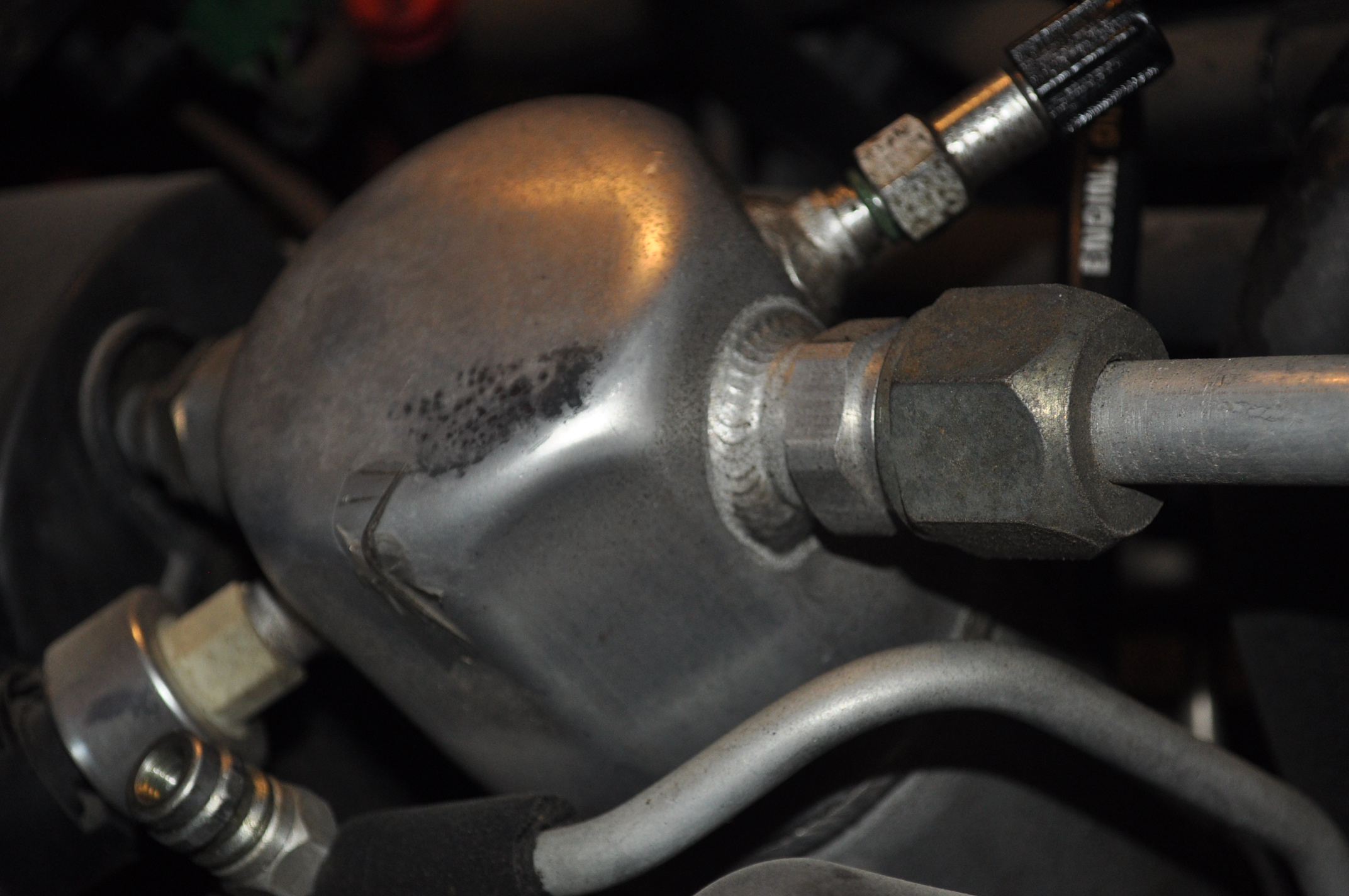

O.K...So my 92 RS has been converted to 134A and when Ibought the car a few months ago the guy said it leaked. Today the compressorlocked up!!! So my plan was to replace the compressor, A/C Hose Assembly, OrificeTube and maybe all the o-rings. However, all the new parts come with o-rings.So I have a few pictures and would love to confirm what was leaking and causedthe failure. Check out these pics!!!

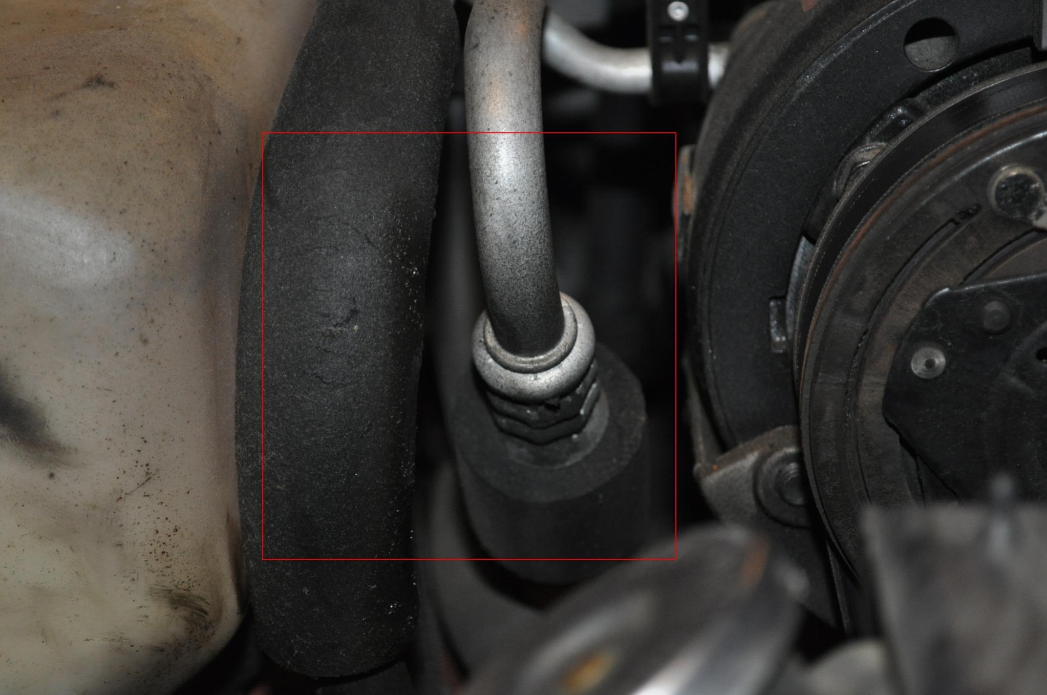

I need help!!!
Few more pics...After replacing the parts I'll have it professionally charged!

The only way to find exactly what was leaking is to charge the system with about 300 PSI of nitrogen then spray everything with a soapy water solution. That way you only need to replace the bad components that are leaking. It might be something as simple as an o-ring.
When switching from R12 to R134, the accumulator needs to be replaced and the oil needs to be changed in the compressor to a R134 compatible oil. Adapter fittings for R134 can be installed but when I converted my 91 pickup truck, I found the fittings always leaked so I had a local AC shop weld on some proper R134 fittings right onto the lines. It only leaked once after that and it was the o-rings on the back of the compressor. Replaced them, sucked the system back down into a deep vacuum then recharged and it's been fine for years now.
