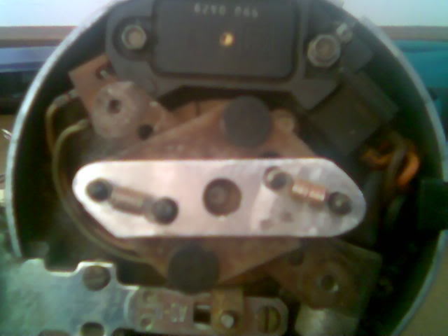

take the weights off... make a sheetmetal plate to hold the pins in the same place relative to each other like the drag racers do when they lockout the timing..
it will look like this image i found after 2 seconds of typing into the google search box:
hell, a small zip tie holding the posts tight would probably be good, and you might have to only remove the springs to do it..

Removing the weights/springs and securing the pins with a bit of safety wire or a cable tie sounds like it'll do the trick. It IS only a test as I'm suspicious of the calibration of the old Sunnen distributor machine at the shop. I have a fully adjustable vacuum advance mechanism for both set point and total amount. A run through the machine indicated that there was 12° of advance available with maximum vacuum applied. That's 24 crankshaft degrees. I'm not certain if there's that much available. So another test is required.
