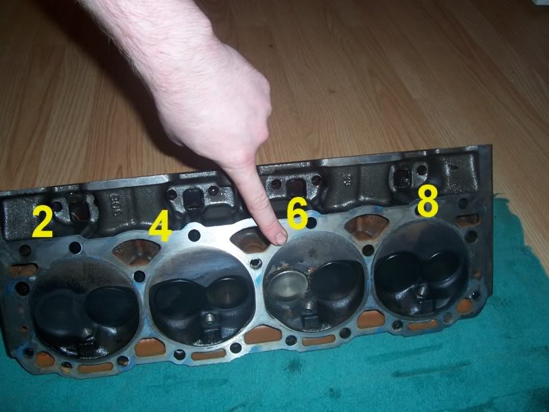

Pull the heads off and look at each cylinder. You can just pull plugs and look, but if you're gonna pull the heads off anyway you can at least get a good look. If you've got a crack in the cylinders or deck, or a warp in the heads that will reflect in at least 1 cylinder.
It's maybe uncommon to have a cracked block, but it may be just the reason the guy surrendered the build to you. I would consider deliberate dumping of a doomed engine to be possibility number 1 at this point. I'd be looking for another core engine.
Is there anything of value on this engine? Or is it your typical 882 heads, RV ca,. and edelbrock carb + performer intake with crappy headers engine?
I had a crack in a cylinder bore from an engine that was .060 over. WHen I pulled the heads off I found this:
That's actually a REALLY mild "steam cleaning" from water in a chamber. There was no white smoke out the back either. But you can see the exhaust valve is SUPER clean compared to every other cylinder. Thats the kind of thing you're looking for.
