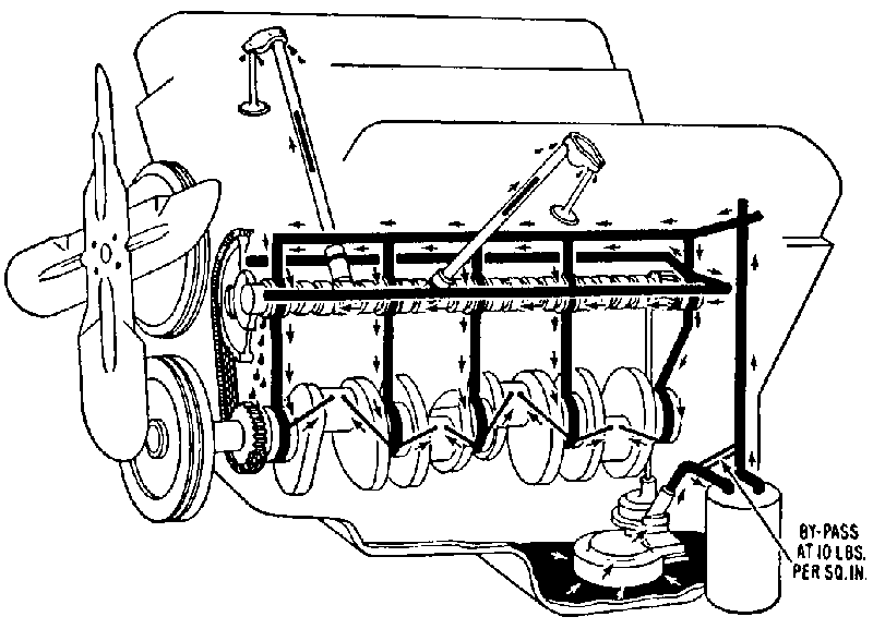

for your reference.
this is why initial priming of new build is critical.
priming on a new build ensures the oil galleys are clear and the oil circuits flow as supposed to. You will not wash away all the assembly lube because the engine in not rotating you are merely spinning the oil pump.
http://www.cranecams.com/uploads/breakin/548e.pdf
On a camshaft with "flat" tappets you HAVE to break-it in on initial start-up.
This process ensures the flat tappets are properly broken in with the cam lobes.
Priming and cam break-in are critical steps, they are not superstitious beliefs.. there are some well intentioned cyber mechanics that unfortunately give out advise that is not based on any actual experience.
DO this wrong and you WILL wipe the cam lobes.
