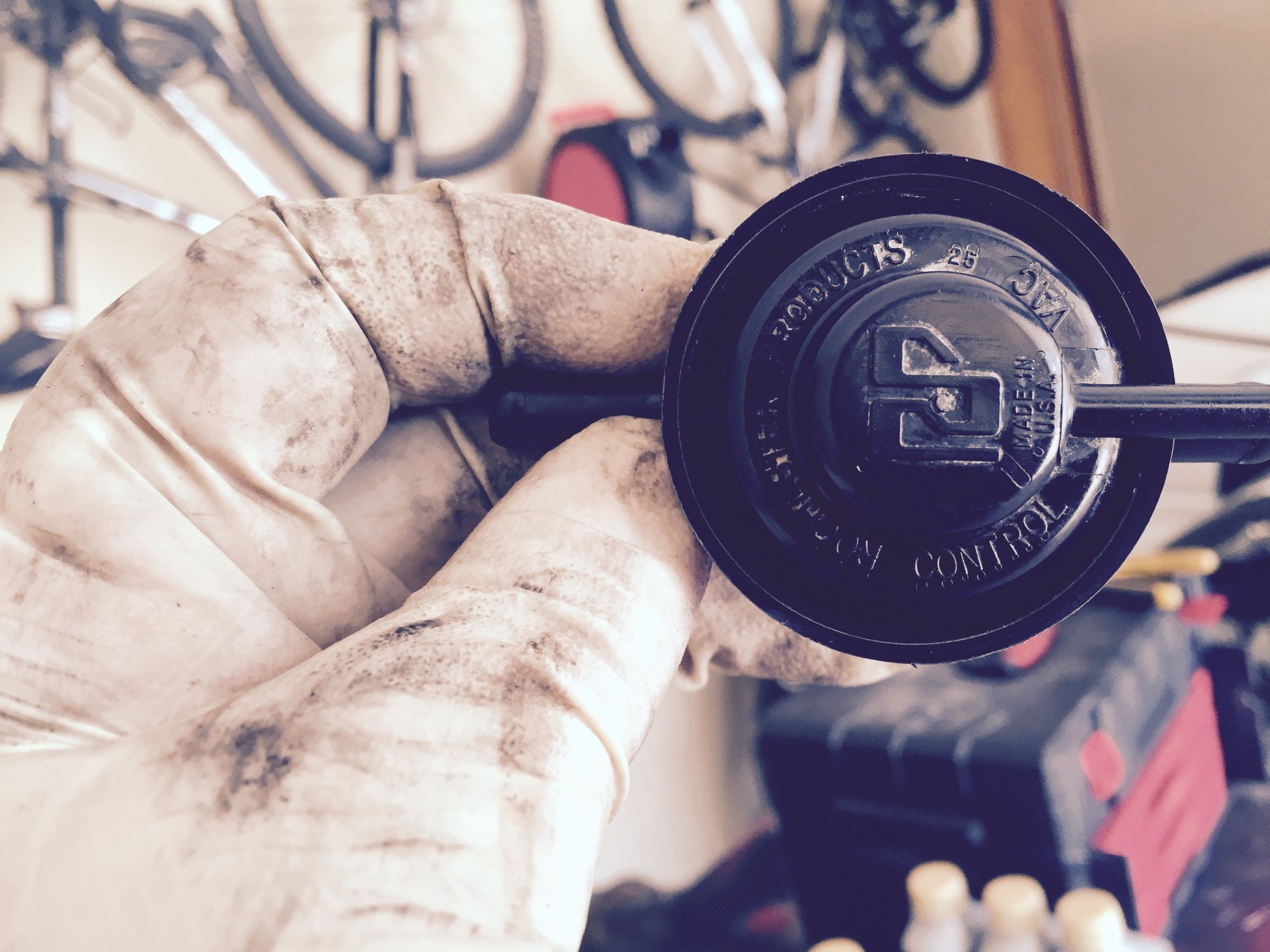

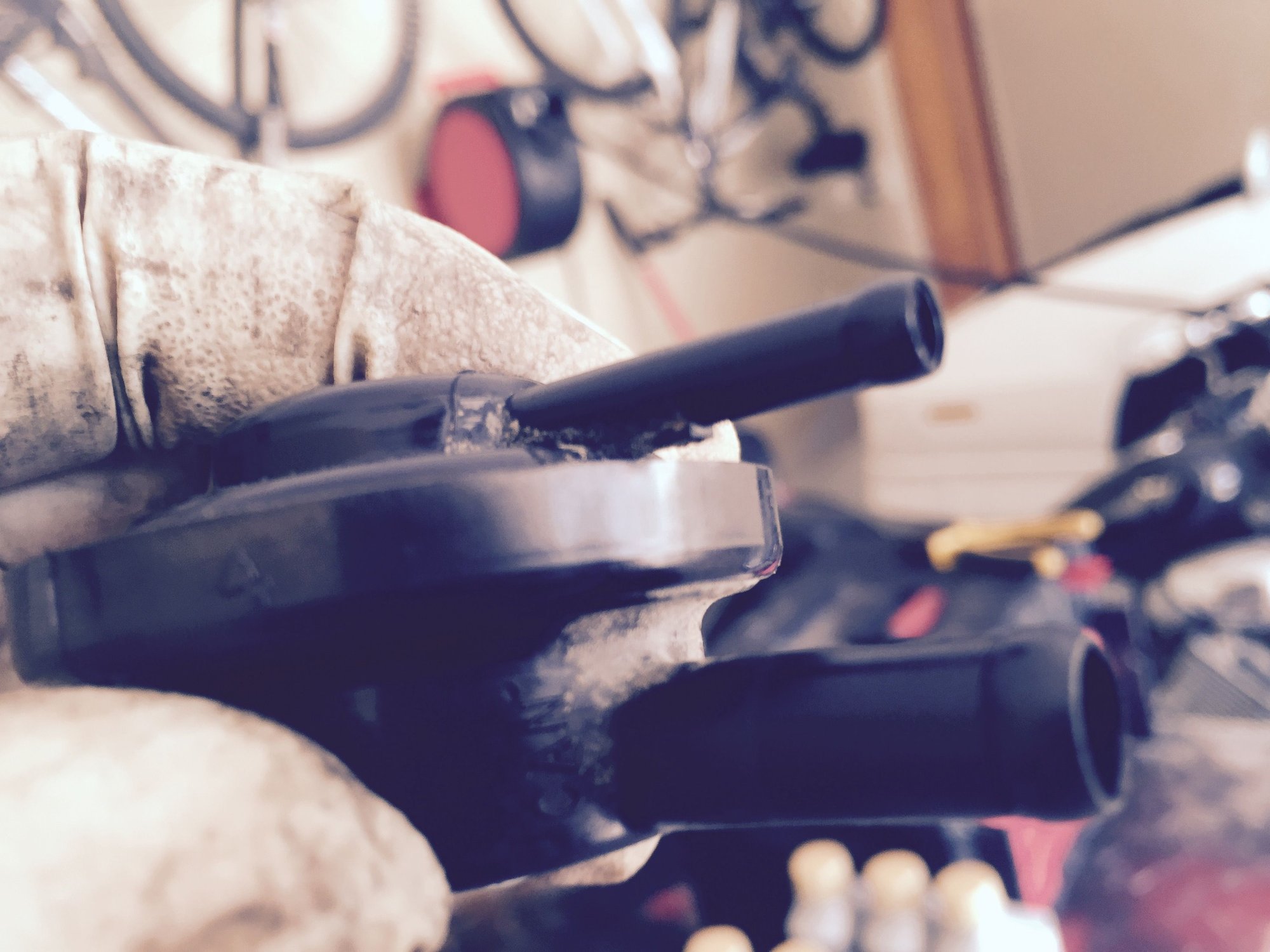

Today I put up the tank with the new pump Inside. but before I whanted to check the fuel lines so I put some compress air true them and the main an return where OK but when I blow true the emission line I heard a Pop and when I investigate their is a kind of check valve that brake open because the pressure I apply. I mount the valve again and it take a lot of presure to open it so I'm wondering if this is the cause that the tank overheat and overpresurize the Fuel Gas.
Taking a coser look at the diaphragm it looks like a fabric with litter holes in it and fragment of rubber so I belive this is the cause for the block of the fumes to the canaster because the rubber part is gone can't seal properly so I believe the new one will solve this problem.
Check Valve Before Canaster Part Number
Check Valve Before Canaster Top Side
Check Valve Before Canaster Canaster Side
Check Valve Before Canaster Tank Side

Check Valve Before Canaster Opend the diaphragm is missing it rubber part so it can't seal so the tank fume pressure can't open it a new valve will solve the issue
