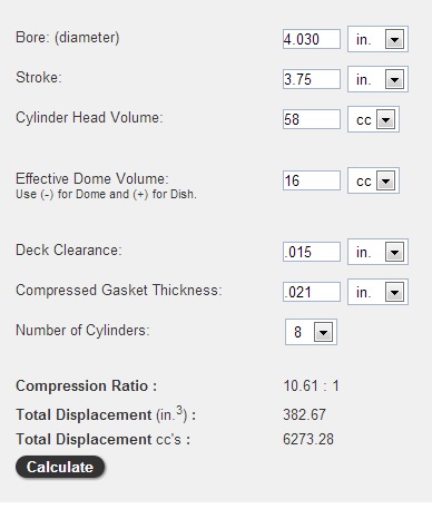

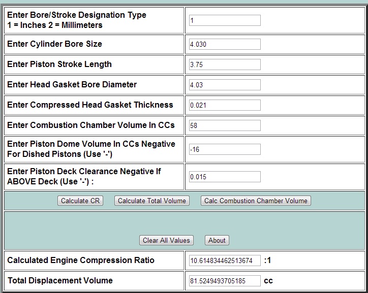

Re: Roller Cam in Non Roller block, Whats need it and is it worth it?
A 383 with a 16cc dish off the shelf piston and 58cc head is 10.6 with a quench of 36. With an 18cc piston as you sarcastically suggested it goes down to about 10.4. That's pretty spot on compression for an aluminum headed pump gas motor.

The same calculators everyone else is using! I think it's your calculations that are off! Or you just assumed you are right and didn't even check it.
O and using funny emoticons doesn't actually make you right
