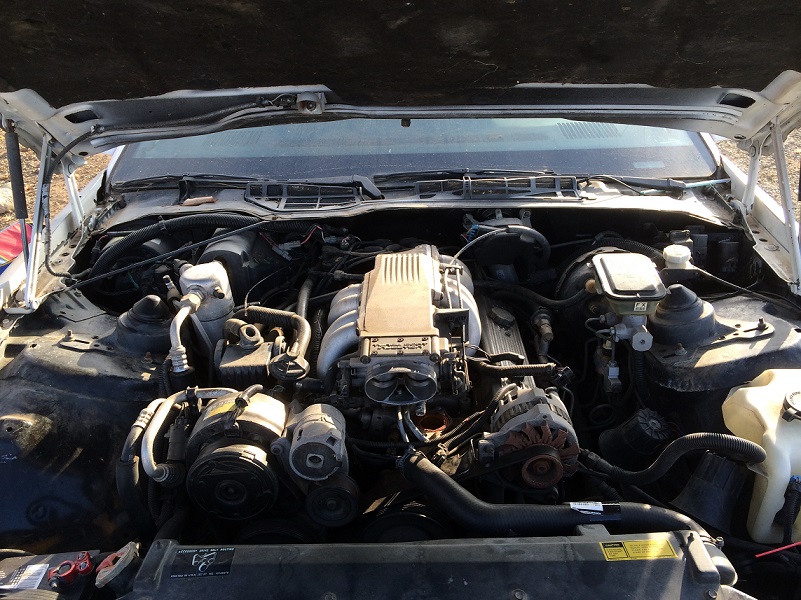

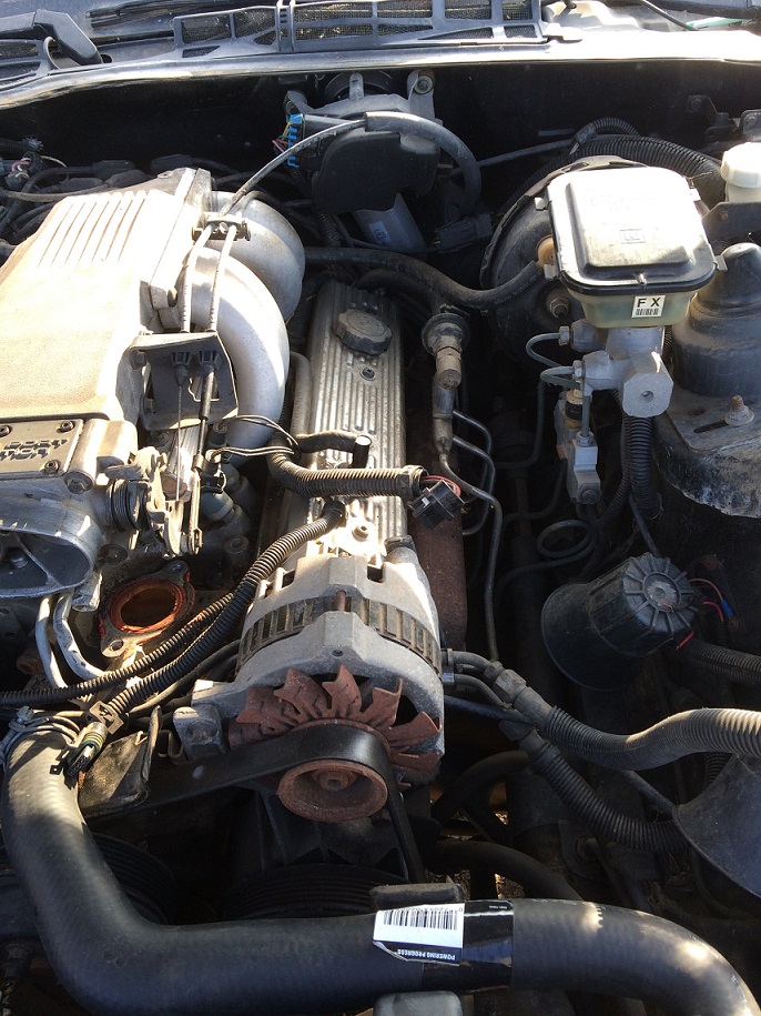

Heres the top view, and serperate left and right views of the engine.

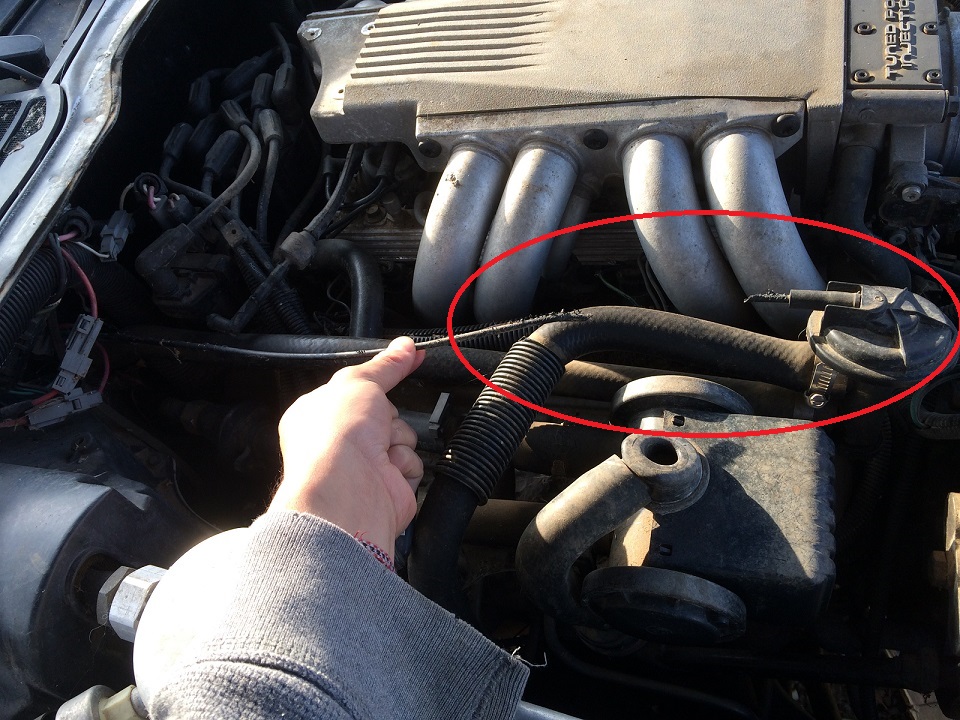

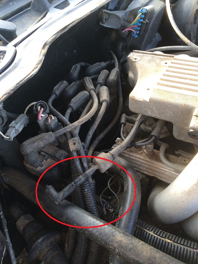

Due to being in a garage and sitting in a ranch for so long rats began to inhabit the engine and chewed on a couple wires. heres some pics and the issues in the red circle. any help as far as function and suggestion of replacement parts would be greatly appreciated

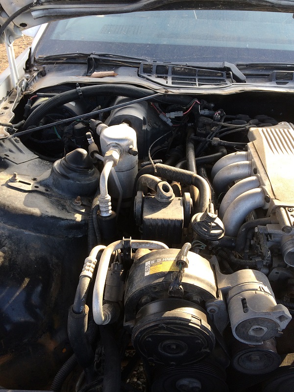

Finished the with all the radiator stuff. Any other suggestions as to what i can tackle next to get the engine running smooth?

I see Tstat housing is off, the wires you circled are critical, they go to injectors, take an old one to auto part store , they have them/can order ...
splice them in. Shop vac the engine, get all the critter nuts out so they don't come back.
You can splice the vac hose, get new piece at AP store along with a coupling.
Typically usual trouble makers are EGR valves, IAC dirty, Throttle cleaning, vacuum leaks, TPS needing adjusting or new, PCV valve and hose leaking, O2 sensors, all cheap and easy to replace/adjust .... Haynes Manual or Chilton always a good investment. Then Fuel injectors/fuel pump and pressure should be checked. Injectors can be OHMed out as a starting point, Add injector cleaner like Seafoam or Lucas.
