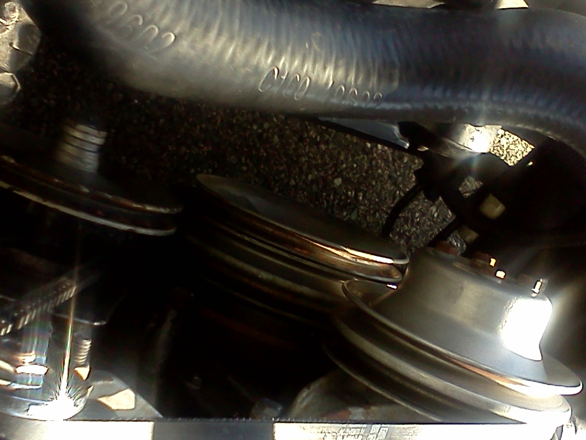

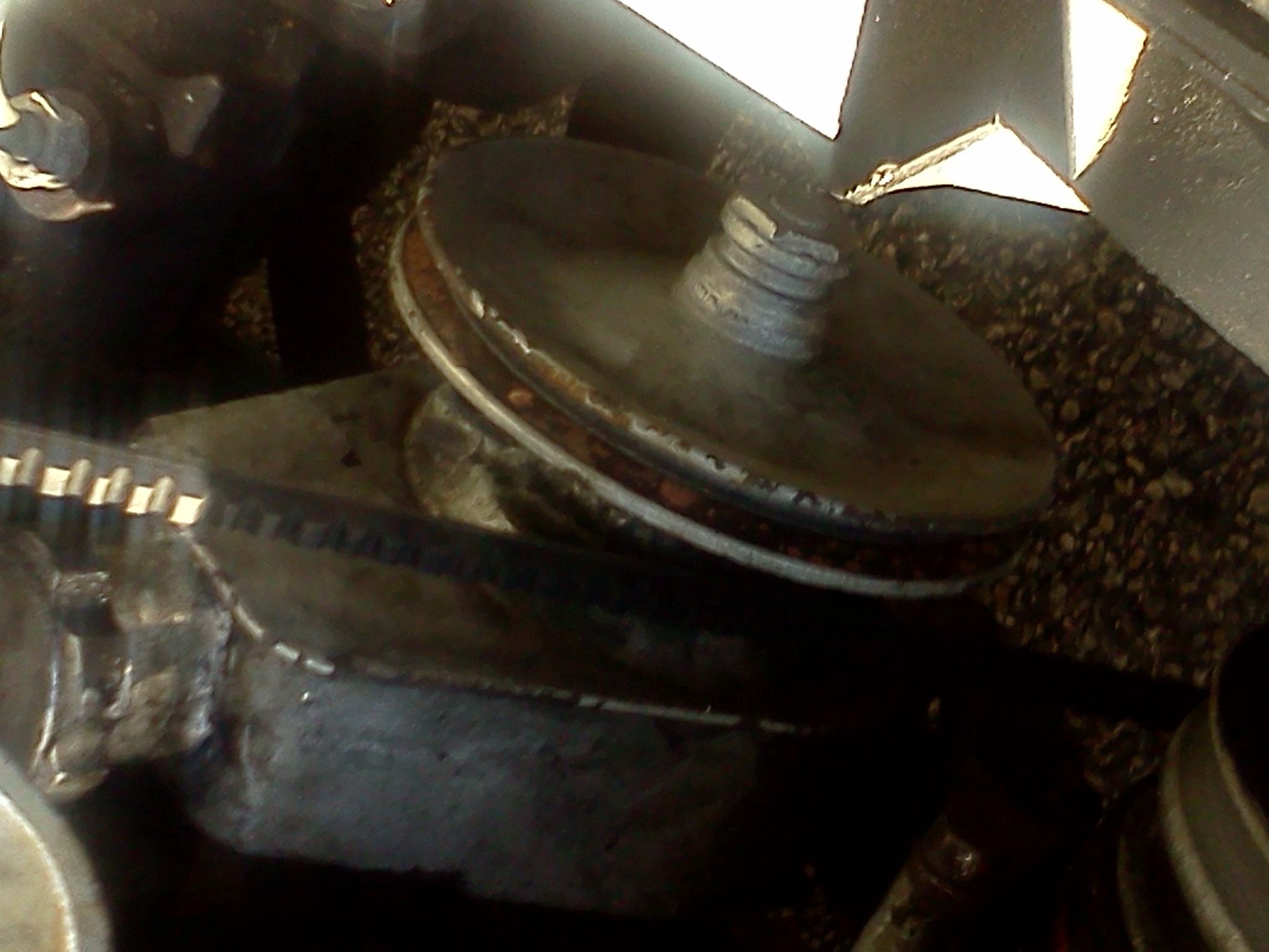

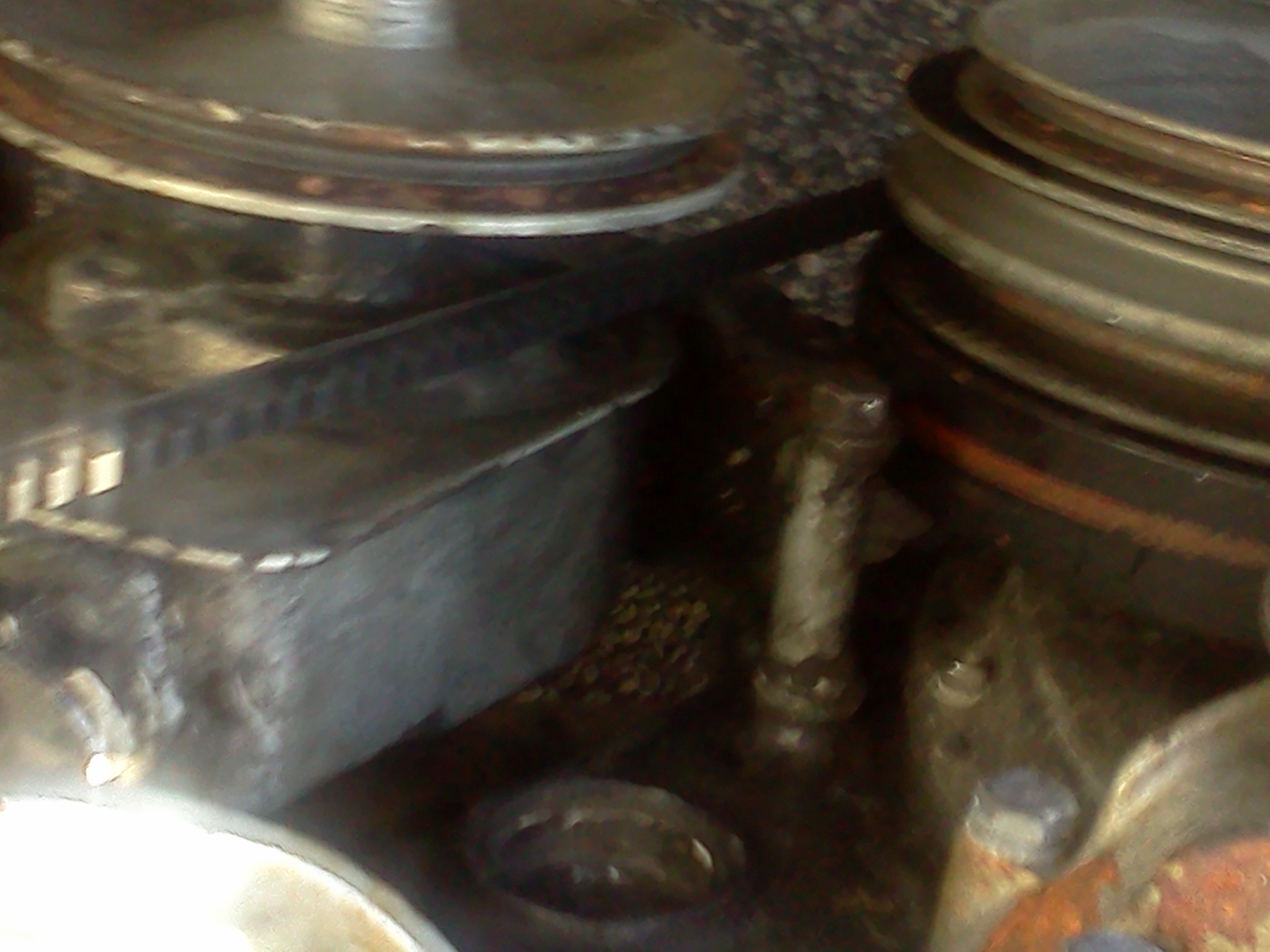

So there's the belt I gota put back on but the bolt is so damn tight is there any video or picture to show me step by step how to put back on I tried youtube
Attached Thumbnails help-securedownload.jpeg   help-securedownload-1.jpeg   help-securedownload-3.jpeg

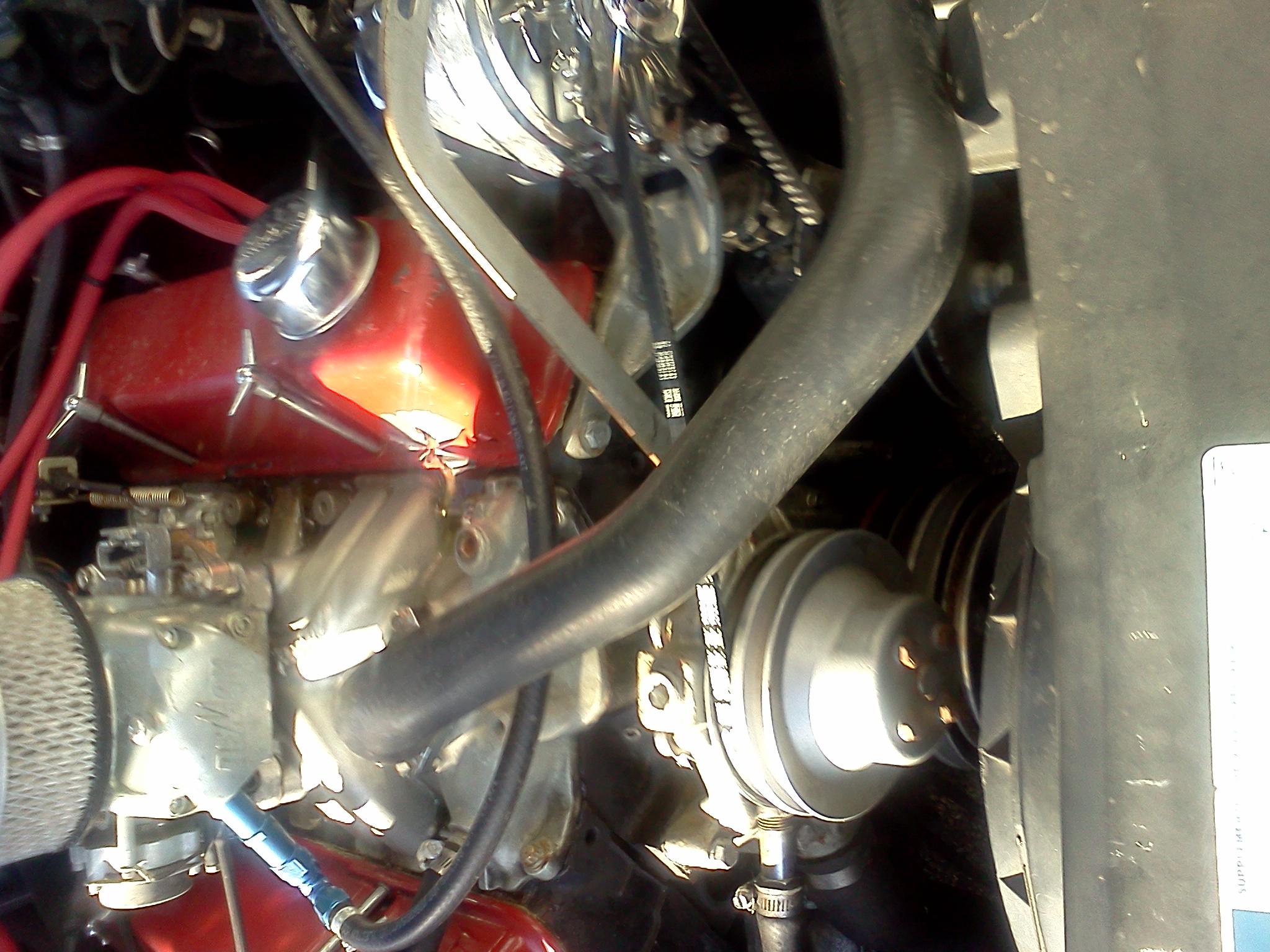

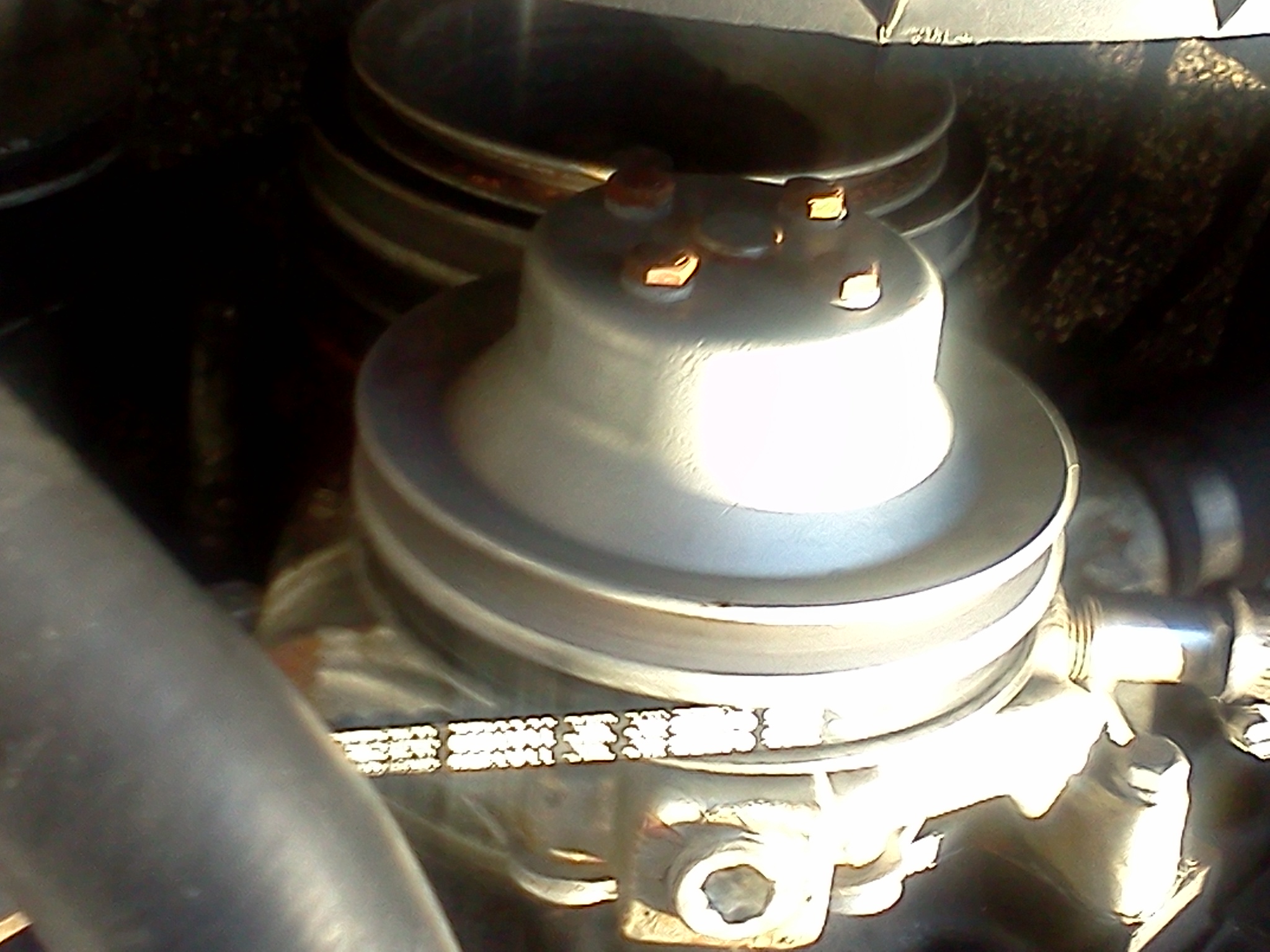

Couple more pics does anyone know the exact engine it is lik I know it's a chevy 350 small block is there anymore info I can put in to get the Manuel to engine
Attached Thumbnails help-securedownload-2.jpeg   help-securedownload-4.jpeg   help-securedownload-5.jpeg

All the nuts need to be loose on the power steering pump so you can move it left to right by hand. PB blaster(in a aerosol can found at parts store) works good on bolts to break them loose.
Next install the belt on the crankshaft pulley(The bottom one centered with the engine) then loop it around power steering pump.
Slide pump toward driver side of car till belt tightens around pullies. Tighten all pump nuts and bolts. Your going to want a little play in the belt after everything is tightened.

All small blocks are basically the same from 1955 to 2003 in vehicles factory equipped with the gen 1 v8(what u have). Last I checked a GM subsidiary in Mexico still makes the engine as a crate engine for replacement and hot rodding purposes. Anyway a small block chevy performance manuel may also be needed to help you with engine specific problems you may incounter.

Don't need a video , it is pure logic!
(something that seems to be lacking in the current generation of new owners , need a video on how to wipe their ar*e)
Gotta get the bolts loose 1st so the PS pump can be moved closer to the water pump in order to the belt on the 2 pulleys?
Once the belt is on, you pull the pump back out to achieve correct belt tension and tighten it in that location.
Not exactly rocket science is it ?
Without further investigation by you all we know is it is a SBC.
May not even be a 350 , could be a 283 or a 400, all you can tell is the heads are off a '86 or earlier.
'000 of books around on SBC engines but they mostly deal with the internals and rebuilding which I suspect is out of your league if you are struggling to work out how to put a belt on ?
The correct year factory manual will be a big help with the car ( wiring etc ) but as you appear to have few 3rd Gen parts on the engine won't help much there except for diagnostics
The guy said it's a jegs gm crate motor 350 chevy 5.7
Any paperwork or receipts ?
Given all SBC's from 283 - 400 look basically identical on the outside and many seller think they have a 350 in place of the stock 305
the casting # at the rear of the block will at least give a indication of what it might be,
