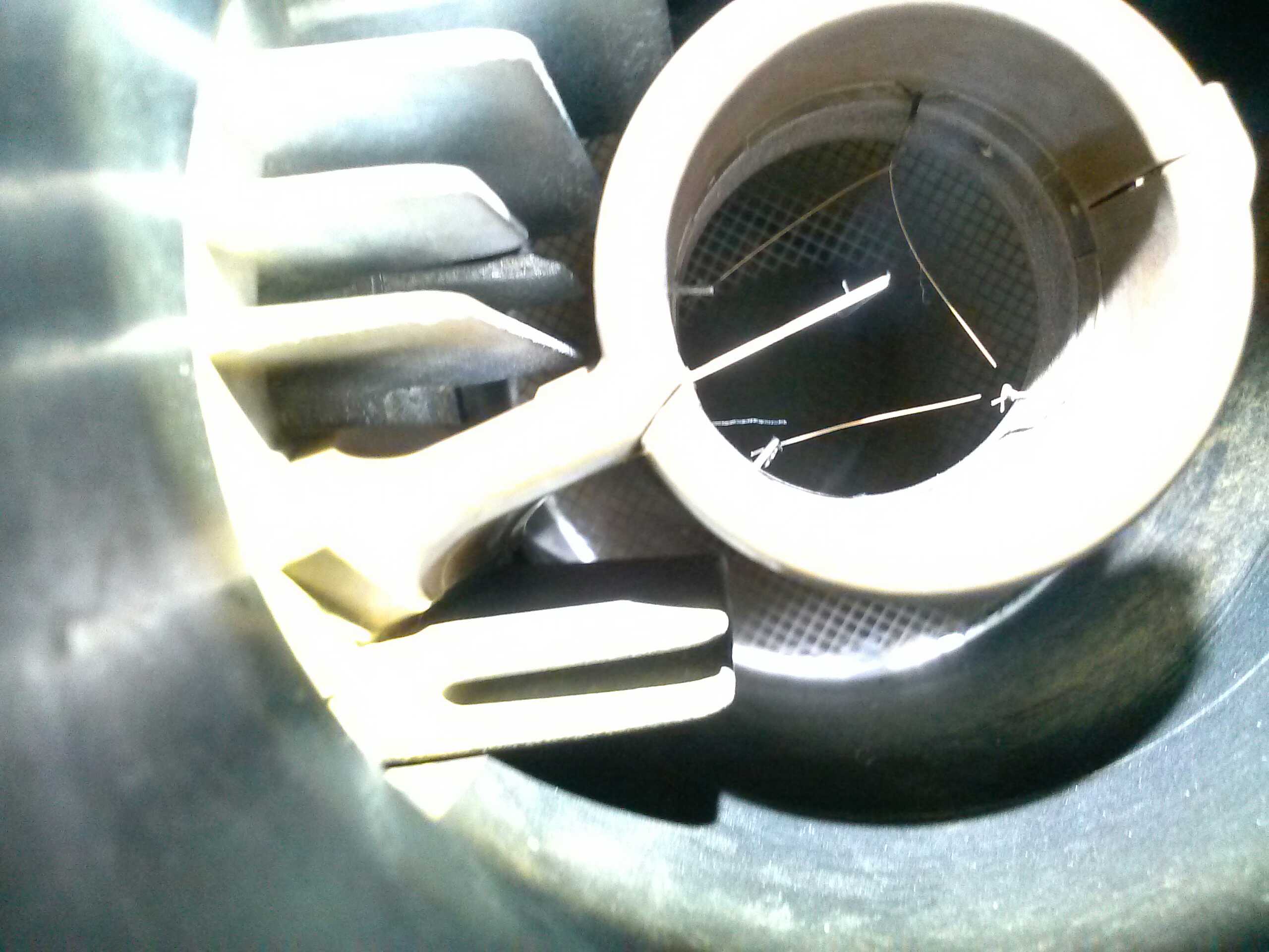

I have read this through, I have one question: is it possible for a k&n filter to be the sole cause of a code 36, if the car runs perfect but the ECM sets hard code 36

I wouldn't think so, I was getting code 34 and that was a bad maf sensor or power relay. When I unplugged the Burnoff relay, that's when I got the code 36. Did you check that relay? I know if you switch the fuel pump relay with the burn off relay and the fuel pump doesn't prime then its the relay. Did you clean the platinum wire? mine was broke

Yea I played with the relays, I had a new ac delco one laying around. I actually performed a test on the relay to make sure it was functioning correctly, all three worked fine. The thing is I didn't touch the maf yet, I, like many have the misconception that it cant possibly be the maf. lol.....until I saw this thread

I would check the platinum wire inside and if it looks fine then clean it with maf cleaner. Did you ohm your wires at the pigtails? mine had black goop in every single slot. Also did you ohm your wires from the relays to the maf pig tail? make sure your grounds are good. in my pursuit of finding the problem i some how fixed a ground issue with my stereo...weird. How is your car running?

The maf sensor looked pretty good last time I checked it. I didn't see anything burnt out. Now as for the terminals, I was thinking of replacing them (not cut and splice in a pigtail, but rather just replace the terminals. In other cases in this car, there was some separation from age and what not causing intermittent to no connection at all (notably steering wheel control for radio) And the maf ones were a little loose for my liking. So that is one thing I have to pursue. I didn't ohm all the wires, I guess that is another thing I have to add to the list to finish. The car runs beautifully actually. The occasional fake out with stalling (she fakes me out) while at a red light (and difficult at lower temps to start her and keep her running for the first few seconds) , but otherwise, she runs good. I do plan to tear down the engine bay a little, clean it up, etc. I was kinda hoping that by cleaning the maf it would solve my problem, because I did run a K&N filter for a while. Actually it was around the same time that I installed the K&N that I began to experience this problem. After performing the FSM diagnostic tests several times it set another code, 34. And this was after unplugging, replugging everything, so I thought there was a correlation (loose terminal pins). Another thing I do have to add is that I had a performace chip on the prom. Could the chip affect the programming on the prom. I replaced ECM - thinking it was the problem (b/c it would not ground for the burnoff) but not the PROM. Could the PROM cause it not to ground the burnoff- just a thought ...And that's my rant

I would definitely ohm your wires from the relays to the maf pig tail. I noticed some of my pigtails at the relays looked almost frayed, almost to the point like they could be touching or morning dew could have caused a short. I had cleaned my maf about 2 months before it broke out of the blue. Did you clean your IAC? I once had a problem that a wire on my iac was touching the alternator causing some very strange problems like stalling at lights and hard start, I heard the IAC can cause code 34, same with a vac leak or tps. Which im sure you know are very easy and fast to check. Also before my car went in to straight limp home mode, I noticed my car was getting very hard to start and idle extremely rough when cold. I have always had a K&N filter with oil, but i purchased a non oil filter now to be safe. I know that oil on the wire can cause havoc being as though it doesn't evaporate and dirt sticks to it. you didn't switch the burnoff with the power relay, or did you? I am no good with proms though im sure they have a thread about that here at thirdgen. If i had to assume, I wouldn't think the prom itself would cause a bad ground. I'm leaning more towards relays and wires.
