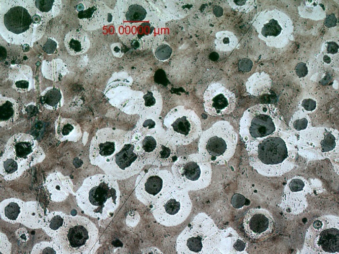

So it has been a long time since I first started this research project and seemed to forget I had started this thread. I completed this project a few months after beginning this thread, but never shared details of the results on here. I thought some of you might still be interested, so I'm going to give a couple quick main outcomes. If anybody is curious and wants to know more, they can PM and I'd be happy to talk more about it. I found the results very interesting and hope to get more samples some day so that I can do further testing to verify my results.
The best way to quickly discuss the results is to show the micro structures from the samples. I attached 4 images to this email.
The first two pictures are images of the graphite nodules for the samples. The first image is of the GM sample. There is an overall higher nodule count along with larger, more uniform nodules than the Aftermarket. The second image shows the Aftermarket sample. As you can see, the sample is indeed ductile iron, not cast steel. This sample has similar nodules, but they vary more widely in size and the nodularity (roundness) is not as great.
The next two images show the samples' microstructures. Again, the first image is that of the GM sample, while the second image is that of the Aftermarket sample. In short, the Aftermarket sample has much more pearlite (dark area) than the GM sample. This typically results in greater hardness and strength.
Tensile bar samples were taken from each of the crankshafts. The GM sample broke at an ultimate tensile strength of 80 KSI with an elongation of slightly over 6%, while the Aftermarket sample broke at an ultimate tensile strength of 90 KSI with an elongation of just under 3%. These numbers follow the expectations from the microstructures.
I concluded that while the Aftermarket sample did provide greater strength which is contributed to greater alloy additions, the GM sample was "higher quality" ductile iron. The Aftermarket sample tensile test specimen did not meet the minimum elongation for a ductile iron grade of that ultimate strength, while the GM sample met the minimum elongation requirement for that grade. This could be attributed to the nodule quality.
These tests show that while the material used in the Aftermarket crankshaft is not steel, it does have an ultimate strength greater than the GM crankshaft. On the other hand, it lacks the elongation of the GM crank, which could mean it may be more likely to suddenly fail catastrophically if stressed beyond its yield point. The last point to think about is that these tests do not take crankshaft design or machining quality into account at all. I am by no means a mechanical engineer and would not be able to make a judgment on overall crankshaft performance. This was purely a study of material characteristics.
