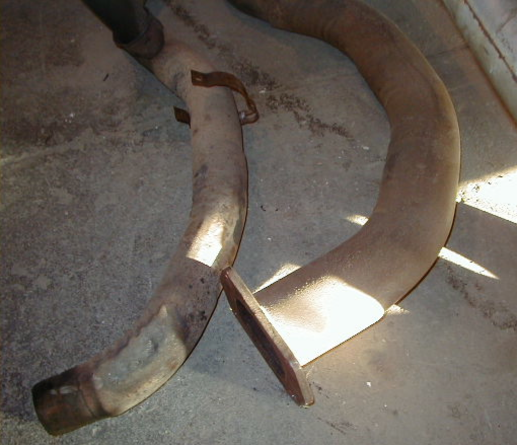

My '83 Crossfire had the same exhaust as the the LG4. I've replaced the 2" LG4/LU5 exhaust manifolds with L69 2.25" manifolds, 3" exhaust and SLP 2OTL, and it made a big enough difference to be worth it.
