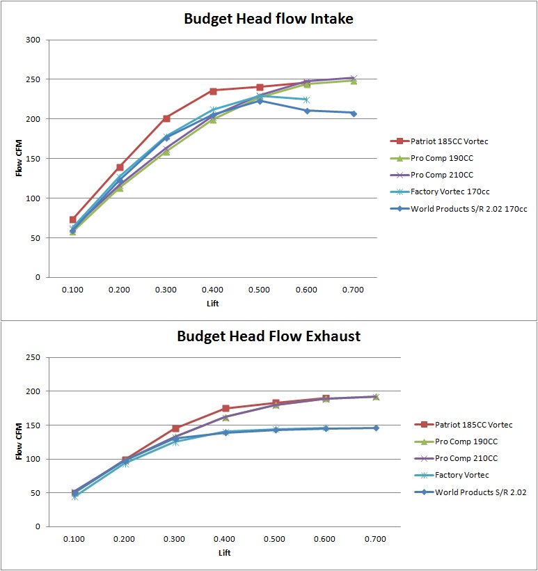

With all that said I would not bother with that much lift on factory 882 heads.

Originally Posted by Mcmxgateman
Swapping out to World S/R Torquers...
Are you porting them?
If not they lose flow after 500 lift
http://www.worldcastings.com/engineb...adflow2010.pdf

Yes, I'm having some port work done. Mainly in un-shrouding valves, bowl blend and clean up the valve guide bosses. Gasket match. Nothing fancy. They do fall off over .500 lift in stock form, but I've read that they respond well to some mild porting.
