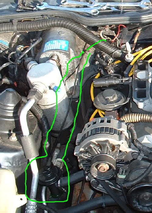

Re: ac blower won't change from the window defroster to the dash vents
Here's a picture of the heater control valve
ac blower won't change from the window defroster to the dash vents-heater-control-valve-vacuum

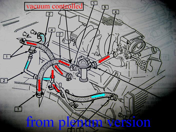

OK, Start with this.
ac blower won't change from the window defroster to the dash vents-firebirdcamarocoolantflow.jpg
You will need to go to the store and get the hoses, Heater diverter valve, and clamps to get the system "back to original".
Then we'll work on the vacuum line/lines to control it.
Attachment 280370
Thank you so much it's making some sense now lol... Do I realy need the heater control valve to make it switch from defroster to vents? Can't I just plug the vacuum line that goes to it? Is the heater control valve needed?
Without it, you will have hot coolant flowing to the heater core all the time. It diverts flow so it wont; it's less than 20 bucks; where are you located?

no mine I hear a hissing from the climate control panel when it is on, so I know it's a vaccuum leak that is not allowing the flap to divert the air from the blower to where I want it.... my heater core is currently bypassed due to it leaking, but my vaccuum line to the heater valve is still attached, so I doubt it's the heater valve under the hood since it control coolant flow, not the air direction.
Correct IROCgiraffe; 2 hard lines..........1 straight to the heater bypass control valve for LIQUID FLOW, and 1 line from vacuum source from plenum/vacuum ball to operate the heater "FLAPS in the dash. Like I said, "back to original". He don't NEED it, but he needs the OTHER line to operate the FLAPS for the vent
