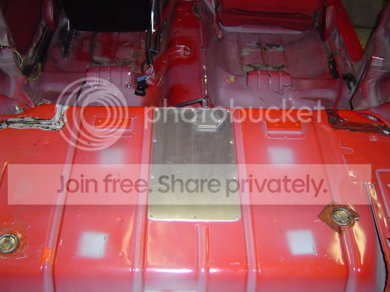

Third gen owners seem to turn their noses up to this method (quite hysterically i might add given what people are comfortable doing to thirdgens) but it really makes no sense to do it the "right" way.

Look at how HIDEOUS that turned out! Almost looks like.... uh.... it should have come from the factory that way....

What's under the cover? Cut lines? It's certainly viable but there is effort and more skill required to cut the hole in just the right place, not cut any lines and make a cover. Also, by taking the tank out, you can inspect the inside and remove any debris.

Close to the edge but still fp replacement related. Eyes open air marshal!
