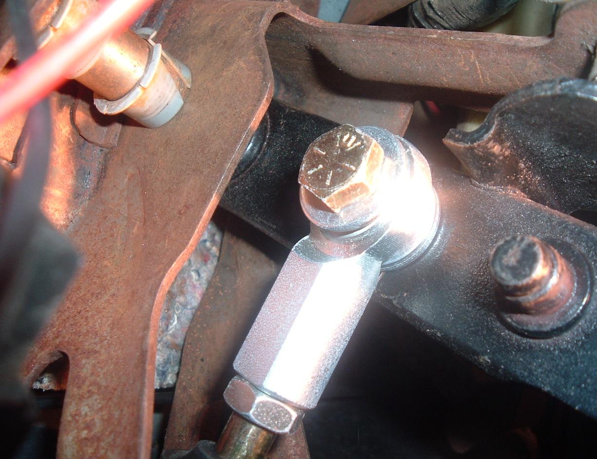

Thanks guys. I'll try messing with the timing a bit. I have the 1.032 Strange Master Cyl with the stock Prop valve and higher tension spring in valve. I just raised my MC rod on brake pedal another 1/4 inch and I'll see if that makes a difference. I did keep most of everything to put it back to stock so I'm still contemplating...
I really need to measure line pressure at calipers to see where I'm at. Also looking into the LS1 brake setup as another option. Manual brakes with my stock setup is no where close to safe on the street.
Re: How to improve vacuum?
Most cars that have the option of either manual or power brakes will have 2 pin locations for the master cyl. rod hook up. This would give you more mechanical leverage for nonpower brakes.

I have the same master. #B3360T 1.032" bore. I can't remember how far up I moved my rod but at time of install I did the math on it and drilled stock pedal and used a rod end and bolt on end of master's pushrod.
Here's a couple pics of where I drilled new hole.

That's exactly where I had it. Today I drilled another hole and moved it up another 1/4 inch leaving maybe 1/16 inch clearance before the bolt hits the upper brake pedal mounting bracket. The pedal feels soft now and just about goes to the floor before the car stops. I'm going to put it back down and try bleeding it again. And yes, I bench bled it many times.
