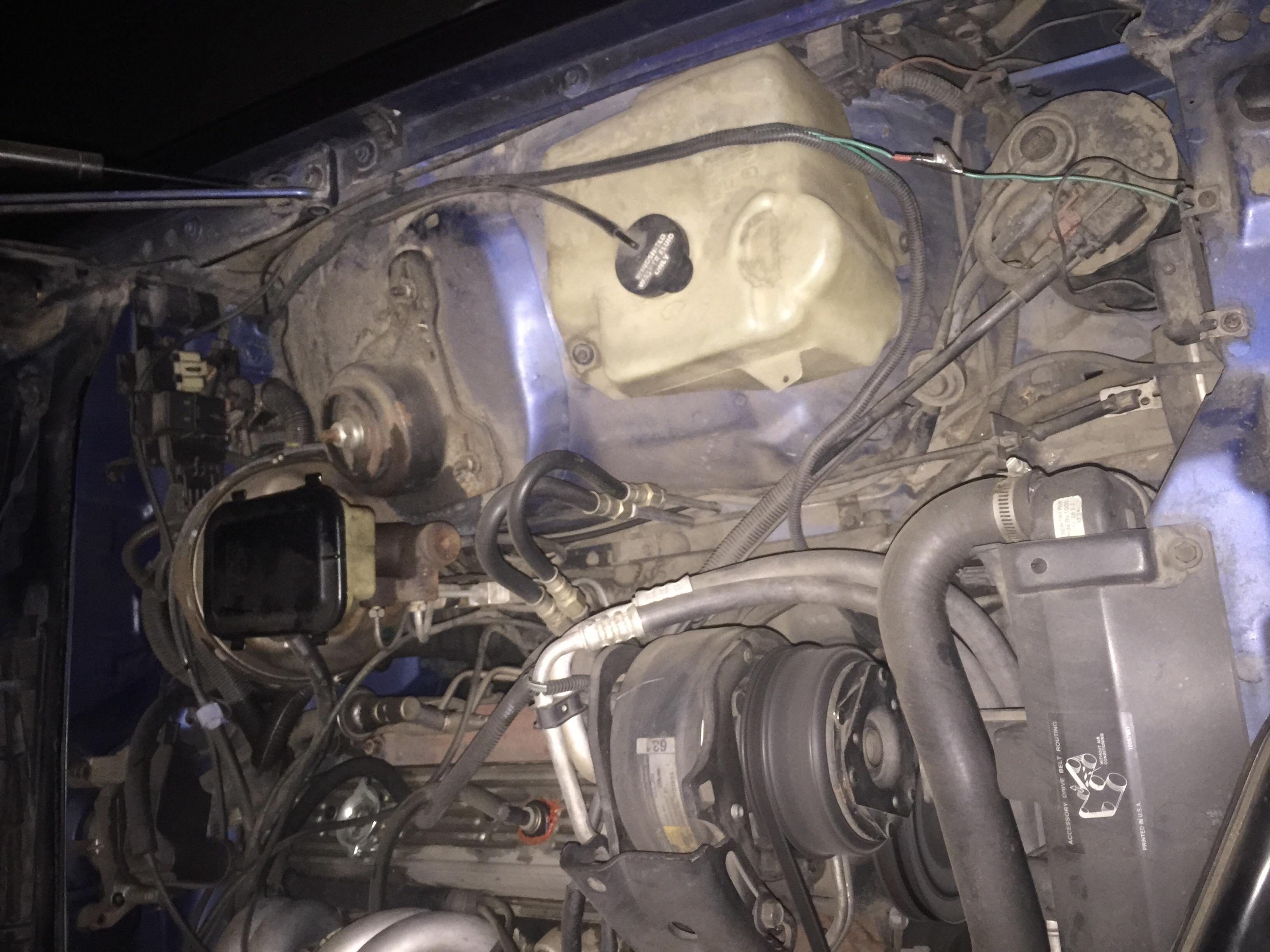

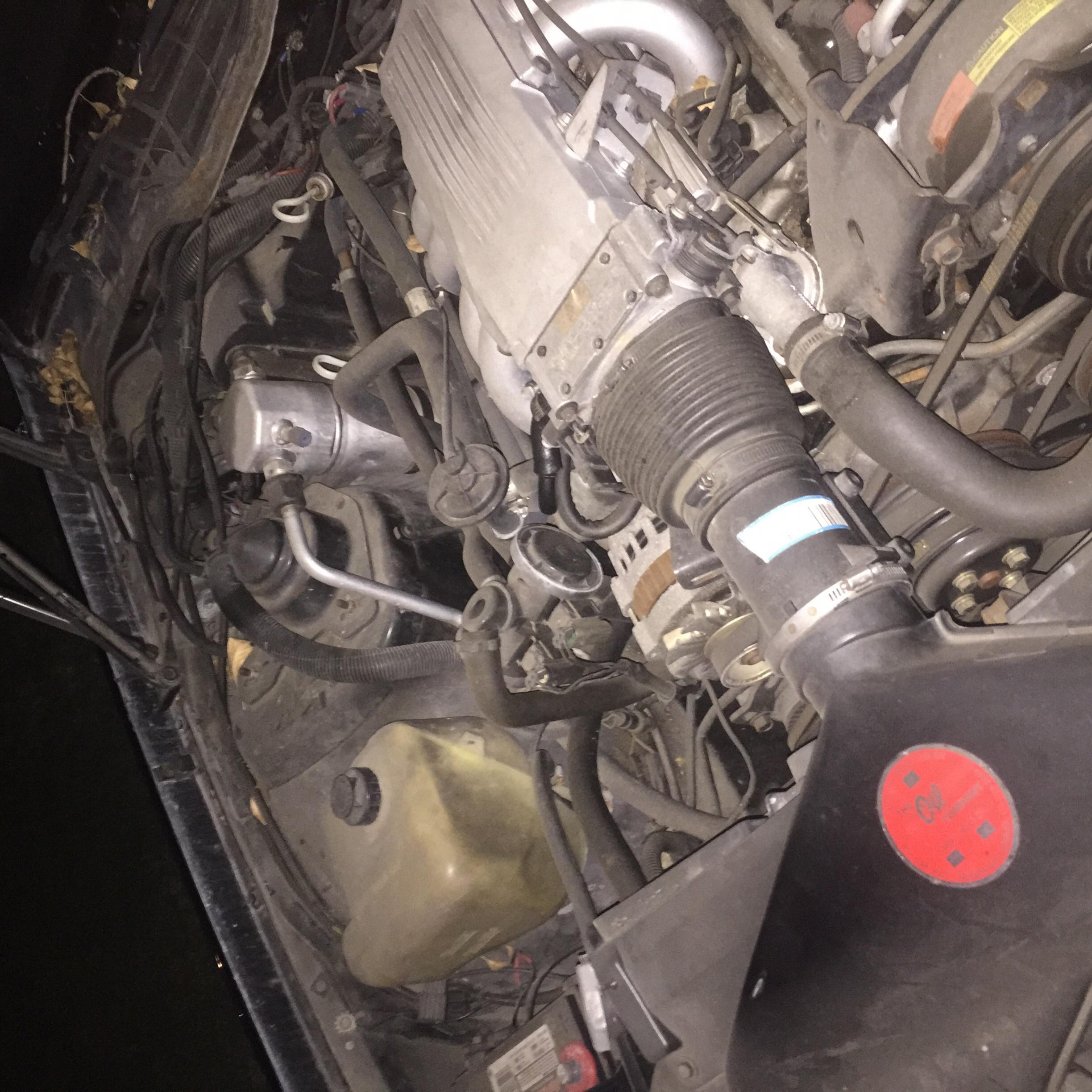

I plan to by he 87 Camaro Iroc Z 5.7L Larger Cam & Header , the only problem I have is that I have to install the new torque converter and also the car has been sitting for a year now and hasn't been started since .. Should I take a risk on buying it ? If so tell me how I should go about the process of getting it cranking and running again .. I'm going to attach some pics of the engine and tell me what you guys think I should do .. I need of Help I really want this 3rd gen in my life lol ..

Also, you said aftermarket headers. I can't really see the exhaust, however on the right side I think I can see a little bit popping through, and they look like an original rusty exhaust manifold. If this is true, who knows what else he is lying about.

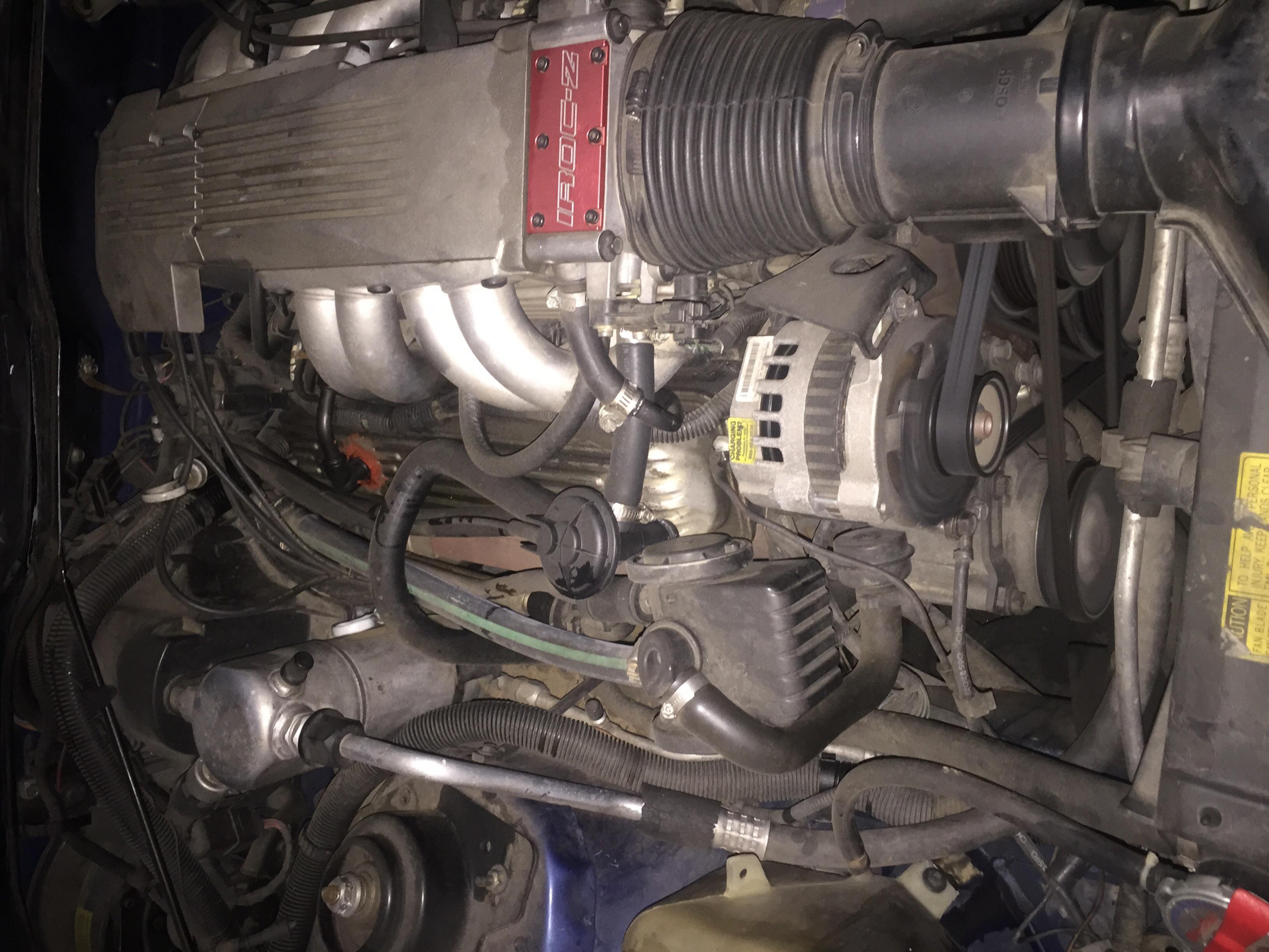

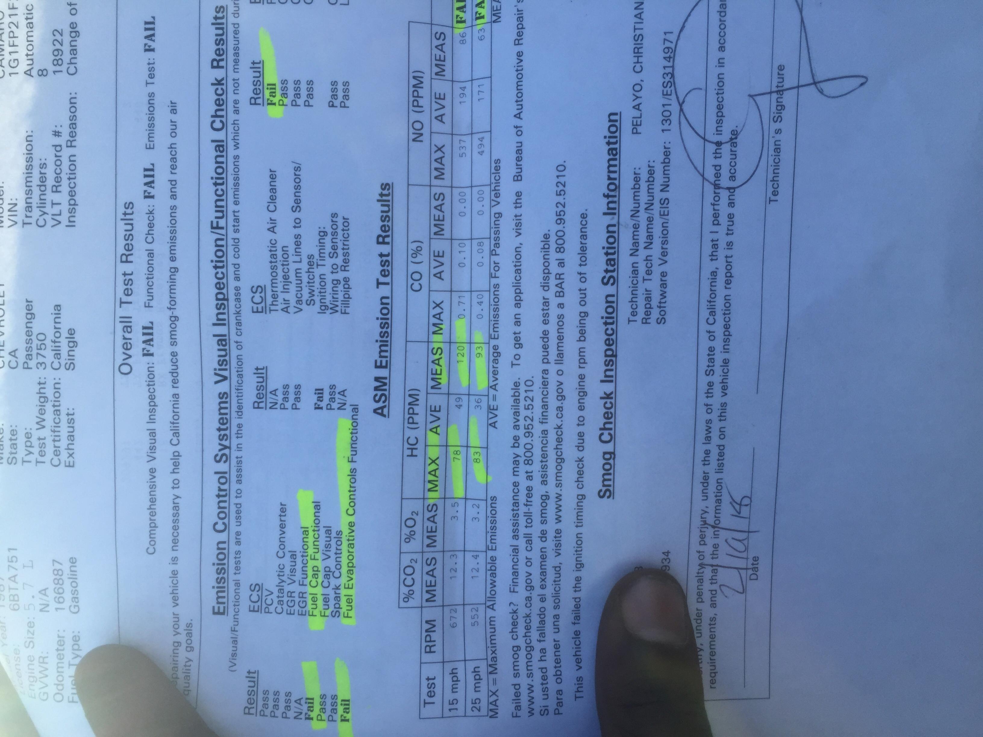

So this is the car it's on a trailer he won'ts 3200$ I went to check it out everything is clean in the inside and outside .. The guy mothers has it on the trailer covered up as we speak .. He told me about checking seal and for exhaust leaks and oils leaks..the car was running great before he sat he says the Trans was rebuilt when engine was rebuilt with all paperwork just need the torque converter to handle rpms .. I don't wanna get hit over the head guys just wanna get this baby running he tell me no problem but it sitting for a year .. So guys let me know what Yall think here's some more pics of he car

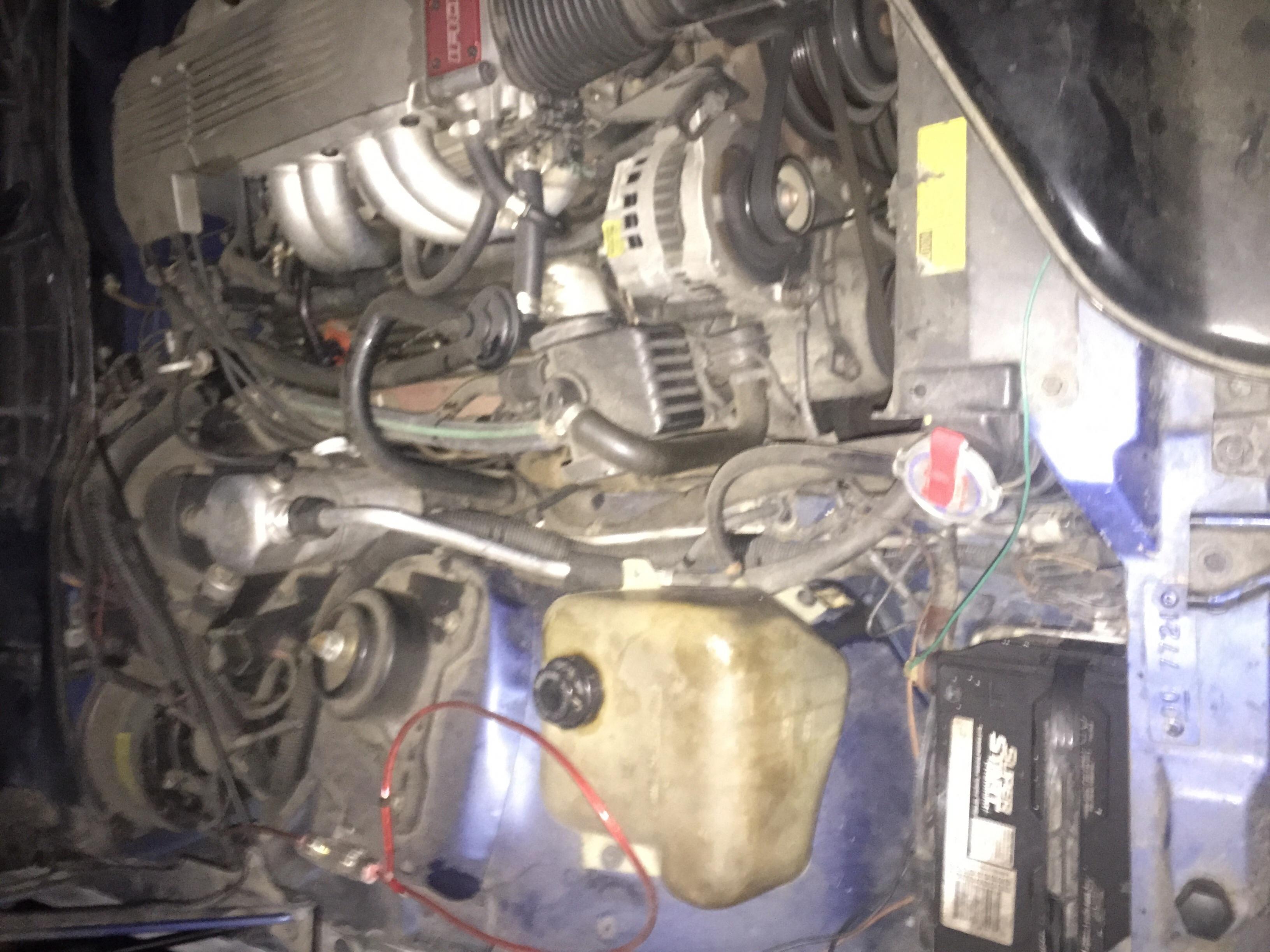

Pic

My car failed smog because of Thermostatic Air Cleaner Fail and Fuel Evaporative Controls .. What you think I should do also my emission result were off too here's my result .. Also my car failed the ignition timing check due to engine rpm being out of tolerance .. Check out my result and give your best advice if you can and what I should do it seems like an easy fix .. My car has been sitting for a year also no tune up nothing I just out a qt of oil in it and also my coolant is going down alittle fast engine getting a little hot also ..
Attached Thumbnails Should I Make the Purchace on 87 Camaro Iroc Sitting for a year-image.jpg

Check for coolant leaks.. Look at your upper and lower rad hose on engine and rad.
Heater hoses, water neck, bottom of water pump, inside car in front floors.
Check your engine oil level and hope it's not reading alot higher than full, and looking like a milk shake (blown head gasket, cracked head, cracked block will leak coolant to the inside of crankcase of engine)
Thermostatic Air Cleaner Fail and Fuel Evaporative Controls..... This sounds like a visible check and the car is
A) missing the factory air cleaner housing. or B) The stove pipe is not hooked up, or vac line is off/missing.
And.....
The charcoal canister is missing or not hooked up.
Get a few good pictures posted up of the engine from front and side, also a pic of the spot up from like where battery is but the other side that don't have the battery (thats where the charcoal can goes)
Here is something I pulled off the internet that can help you sort out your sniffer results
CO Failure is the result of an excessively rich air fuel mixture. The following is a list of the most common causes:
– Defective Oxygen Sensor
– Inoperative Air Injection System (if equipped)
– Leaking or defective Fuel Injectors
– Restricted air filter (especially if high CO is present only at high RPM)
– Vacuum leaks resulting in improper MAP sensor operation
– Defective air mass or air flow sensor
– Malfunctioning fuel evaporation system or purge valve
– Defective Catalytic Converter
– Defective thermostat (cooling system), thermostat stuck open
– Oil contaminated with fuel, excessive miles between oil changes
HC Failure is the result of incomplete combustion. Any item that causes incomplete combustion can result in high HC. The most common causes are:
– Worn spark plugs
– Defective spark plug wires
– Worn distributor cap and/or rotor
– Improper ignition timing, usually over advanced
– Vacuum leaks
– Engine mechanical failure, low compression, worn valves, excessive oil consumption
NOX Failure is the result of combustion temperatures that are too high. The most common causes are:
– Inoperative Exhaust Gas Recirculation System (EGR)
– Cooling system malfunction, engine running too hot (restricted radiator, defective thermostat, etc.)
– Over advanced ignition timing
– Excessively lean air fuel mixture (defective oxygen sensor, MAP sensor or Air Mass Sensor)

My car failed smog my emission HC 78 /120 at 15 mph and at 25 mph 83/93 And also my fuel evaportive control functional fail also the fuel cap , the thermostatic air cleaner failed also.. Than it says ignition timing failed because of engine rpm being out of tolerance .. Help me I need some Adobe my car is 1987 Camaro iroc 5.7l corvette engine with 66xxx miles it just been woken up from the dead from a year so no tune up or anything tires are worn also

Pic 1

Pic 2

Pic 3

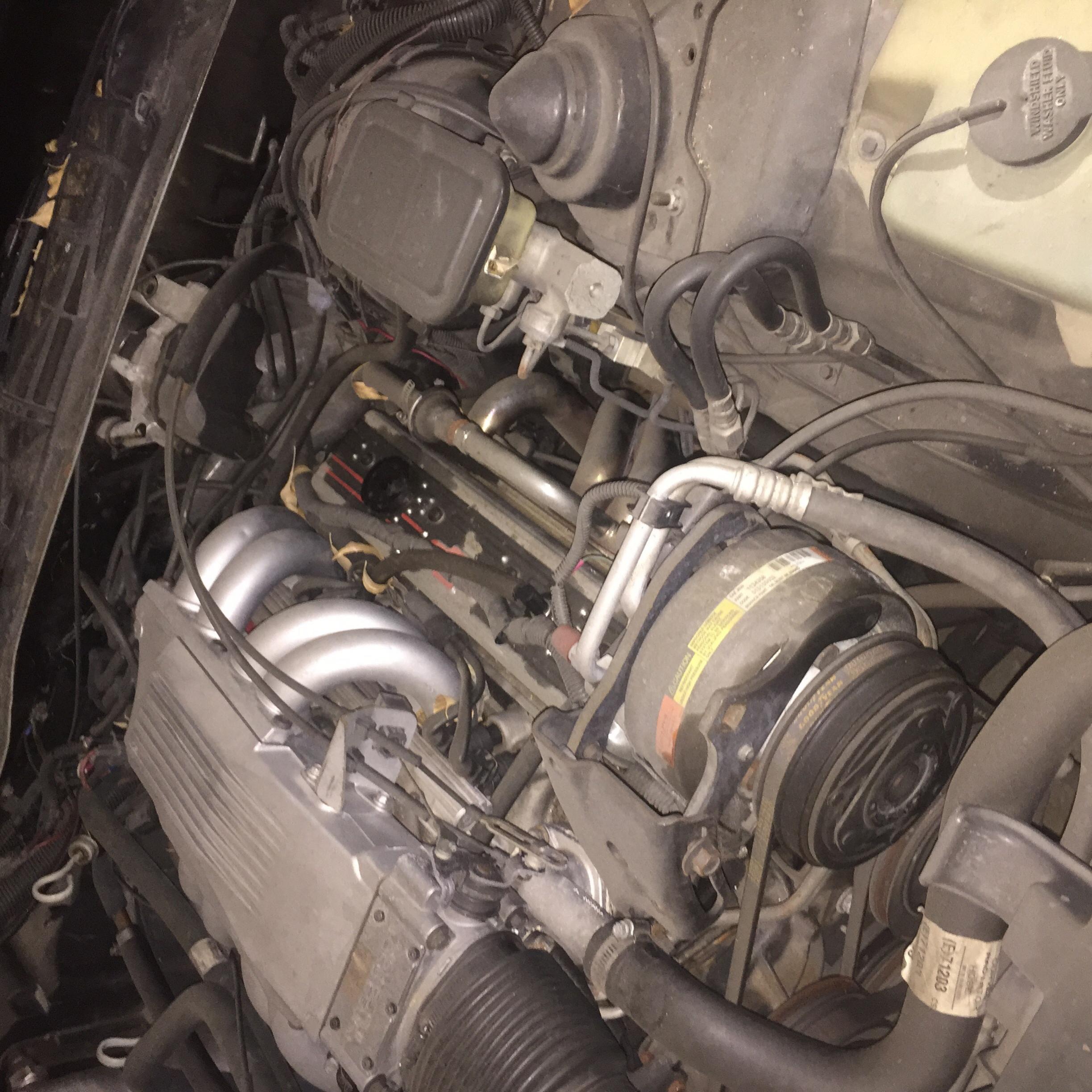

Pic 4

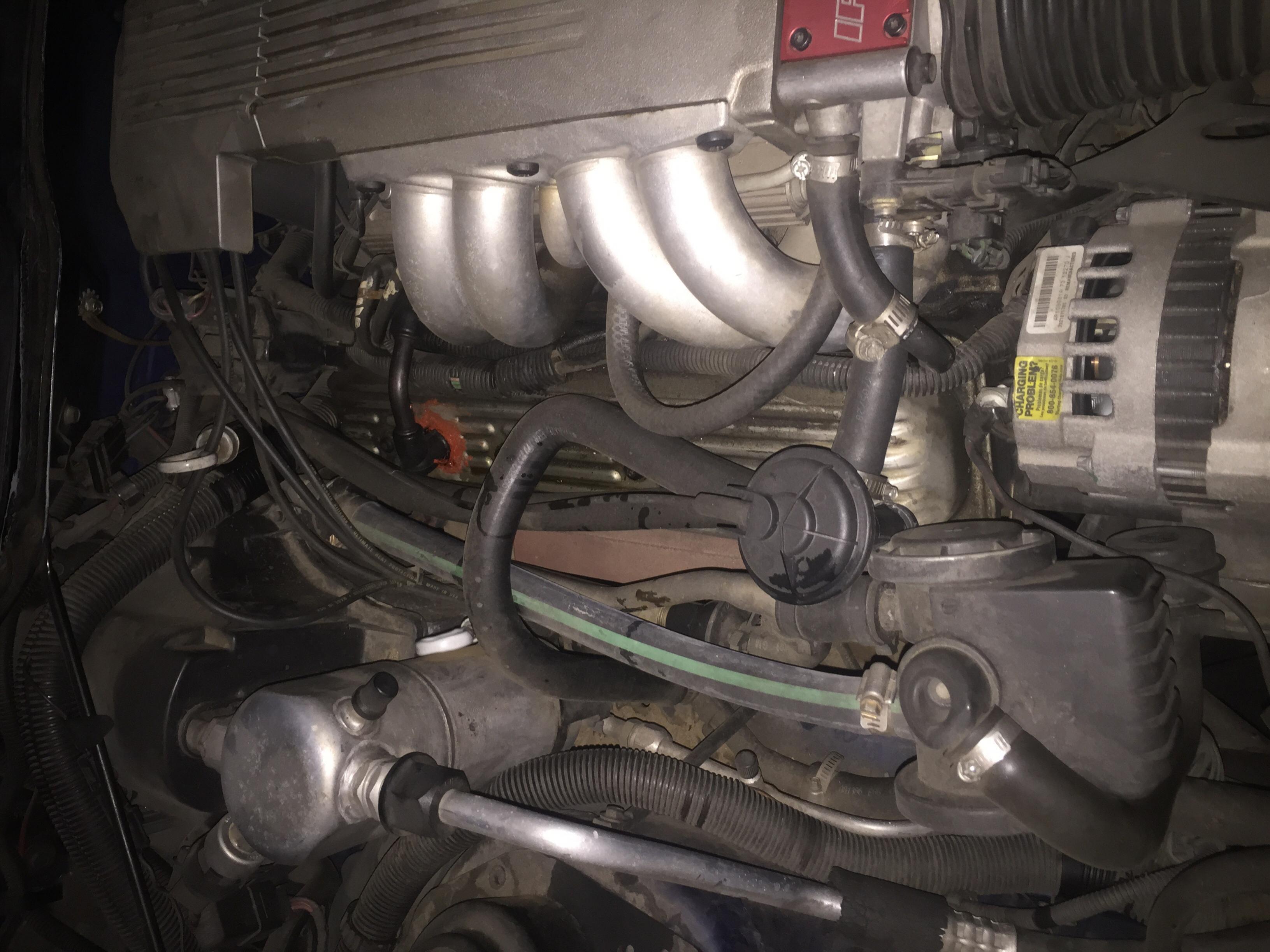

Pic 5

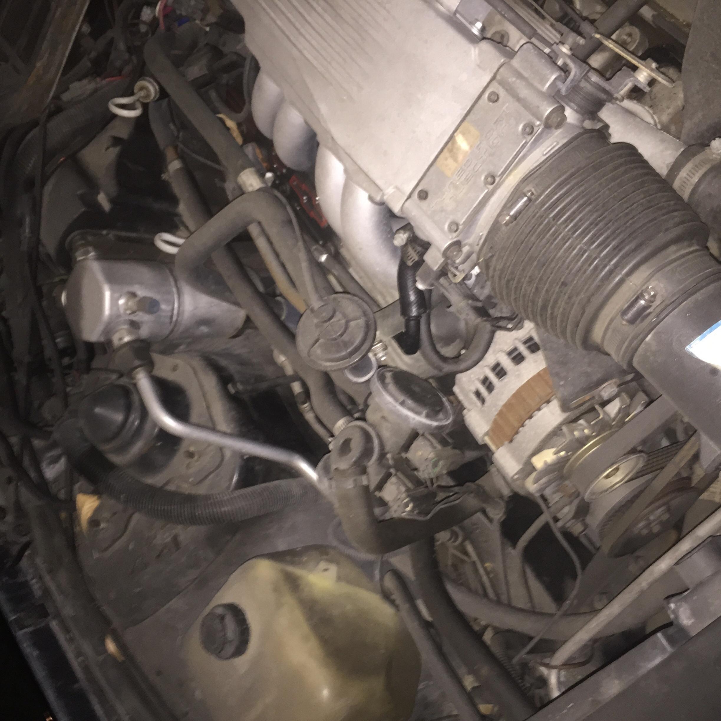

Pic 6
– Worn spark plugs
– Vacuum leaks
I read everything just now , okay I look at my result my vacuum is good .. What failed was just the fuel evaportive control functional and the cap also the Thermostatic Air Cleaner needs to be installed so when I do that you think I'll be ready or do I need to go ahead and get that tune up since its been sitting spark plugs and etc .. ?
