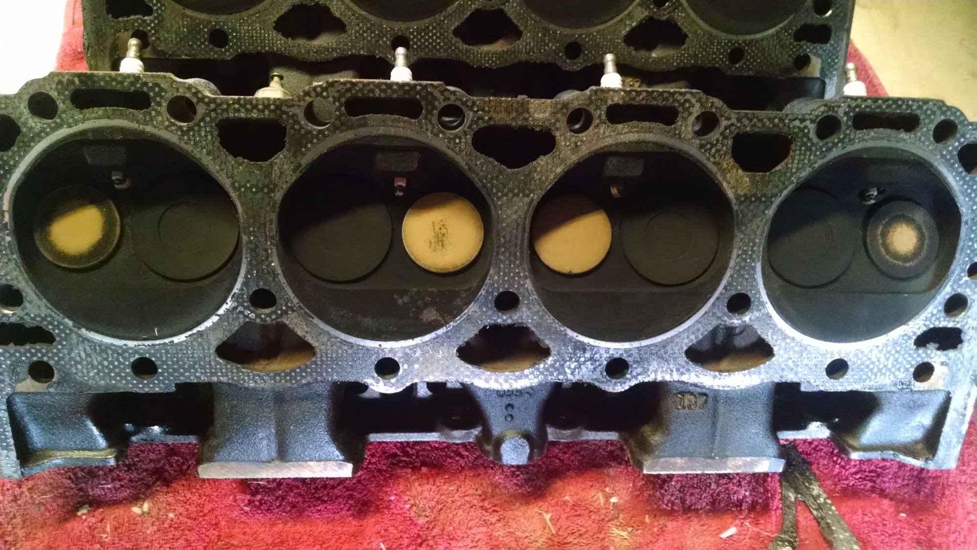

I have an 85 IROC that has sat most of its life and subsequently has a very leaky motor from all of the dried out gaskets/seals. It is a L-69, T-5, 3.73 geared car so it is peppy, but I would like some more (who doesn't). I don't want to (also can't afford) to put a better tranny and rear in it so huge power isn't needed. It is a toy, not my daily, needing premium gas wouldn't be a big deal.I will be putting Hooker 2460 headers and a good y-pipe on it, changing the open rear to a posi (already have a 94 z-28 SLP take off and the axles for it). Pulling the air/egr system (most of it is messed up already)
I also recently got a 305 from a buddy that started in a 97'ish truck/van that I could use for parts/build/whatever. It has a factory roller cam, dished pistons, 187 heads, edelbrock performer intake, msd streetfire hei dizzy, and a holley 750 dbl pumper( bit overkill).
I want to keep the cost of this rebuild under $600 if possible (have more important things to spend money on)
I can bump the budget up to ~$1000 if needed, What would it gain me over staying cheap?
Option #1 (Cheap) is going to be gaskets/valve seals on the l-69, but otherwise leaving it stock.
option #2 is gaskets/valve seals, xe262 cam, thin head gasket (felpro 1094), new valve springs, and the performer intake? (do i need an adapter for the Q-jet?) on the l-69.
option #3(best power?) is put the roller cam block in and throw the 416 heads on it, performer intake, and a cam (not sure on a preferred roller cam). Will the dished pistons kill the compression enough to not be a viable option? I would also have to buy a fly wheel for this option, has a flex plate currently. Also I've read that this crank doesn't have a pilot bearing, is that something I could add, or does it take a different crank?
Option #4, any other combo I'm not thinking of? any chance I could throw my flat top pistons in the newer motor with just a hone and new rings?
I don't want to have to have machine work done, if I'm going to get that far into it I'll do option #1 to get it driving this year and then wait and do a 350.
I've never dealt with building a motor, so I'm unsure of what direction to go. I have no doubts about being able to do it, just looking for advice on a preferred route to head in
Anything you can tell me about the roller engine? worth building on?

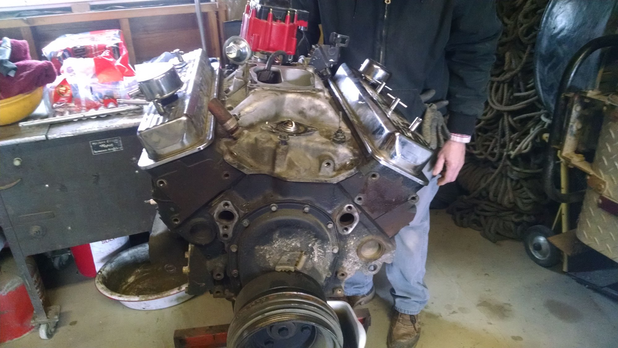

Looks like it was running a bit rich with the 750 holley on it.

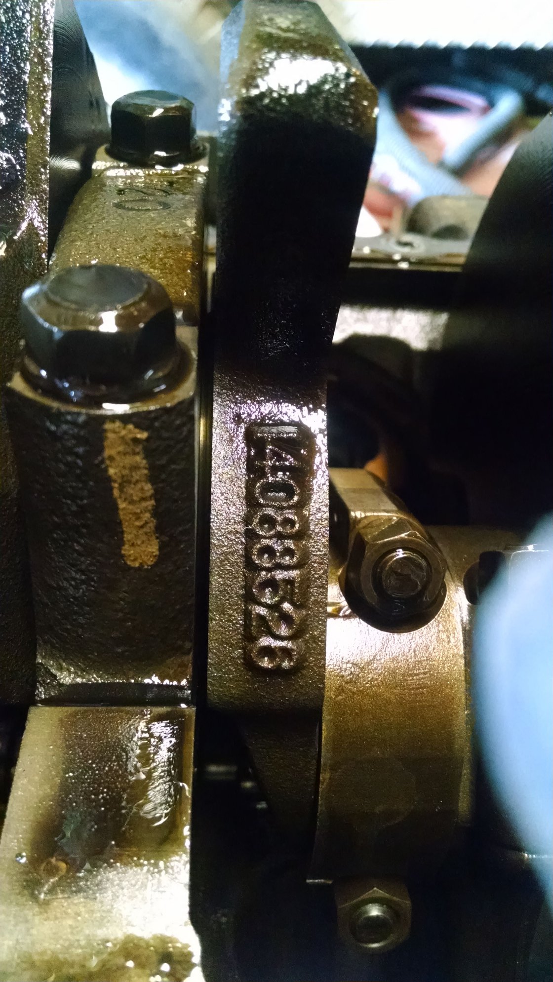

Crank casting number
looks fairly clean

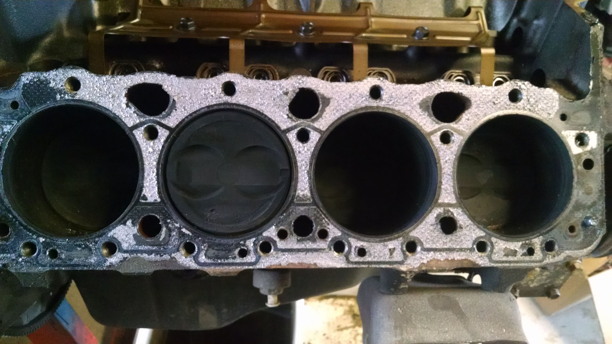

Piston numbers

Well honestly, I think your handicapping yourself severely with a $600 budget.
Where else do you want to spend your money?
Cheap and engines don't really mix if you want to do it right. For a small performance build, this will get you 250ish hp and make a fun little cruiser with a bit of a rumble at idle.
1. Use the roller block. (was it running well when pulled?)
2. Use the intake from your 85, it's nearly as good as a performer and doesn't need an adapter for your Qjet.
3. Use the Qjet from your car. The Holley is too big and inferior to the Qjet.
4. This cam: Lunati 20080721LK or equivilent if you prefer comp or Isky or Crane. if you have lifters from the roller block, then have them checked. If they're good, then you only need the cam.
5. You will need new springs for that cam.
6. I know you don't want machine work, but do a valve job and install 1.94 valves and a mild port job.
Have you already done headers and exhaust? You won't realize true power gains until you do headers and 3" exhaust.
But, this will get you started. Hope this helps!

you took a picture of everything except the casting number of the block. SHould be on the drivers side rear, you can see it from the top looking "down". Without that I can't tell you anything about the motor.
The L69 was the High performance motor for it's year.
How many miles are on that roller motor? Do you have any idea? Did you see it run? Does he have any videos of it running?
With the cam I listed and the head work I mentioned on the heads, it should more than make up for bit of compression you're losing with whatever pistons those are.

Block number is 10243878, 96-97 2 bolt main 305. No idea on miles on it, it's gone through a few owners/vehicles since it was originally pulled. No video or for that matter I'm not even sure if the guy I got it from saw it run.
Mildly built 305 is the end result motor for the foreseeable future. Paint, interior, and suspension would all be ahead of even thinking about upping the motor again.
