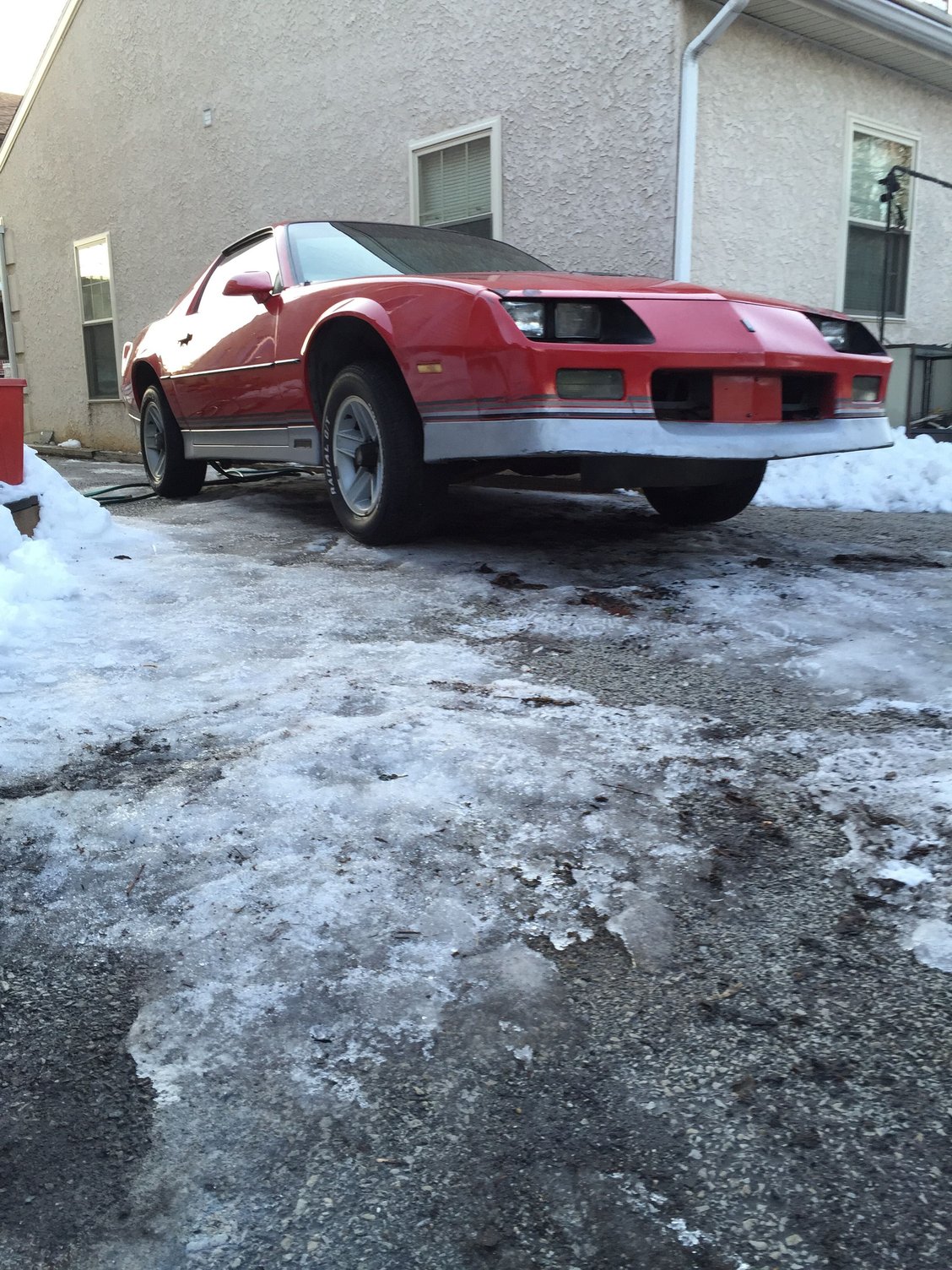

How's it going, I'm new to the forums. I just picked up an 85 z28 shell last week and I'm doing a carbed 350 for it. I have an lt1 cam for it. My first question is what kind of timing gear do I have to use with an lt1 cam? I took a small block Chevy one from a flat tappet cam and matched it up and it doesn't fit at all, so I have to get the proper timing chain set before I put it together. For now that's about it. I'm petty good at figuring most things out but I'm sure I'll have questions throughout the build. Thanks!
