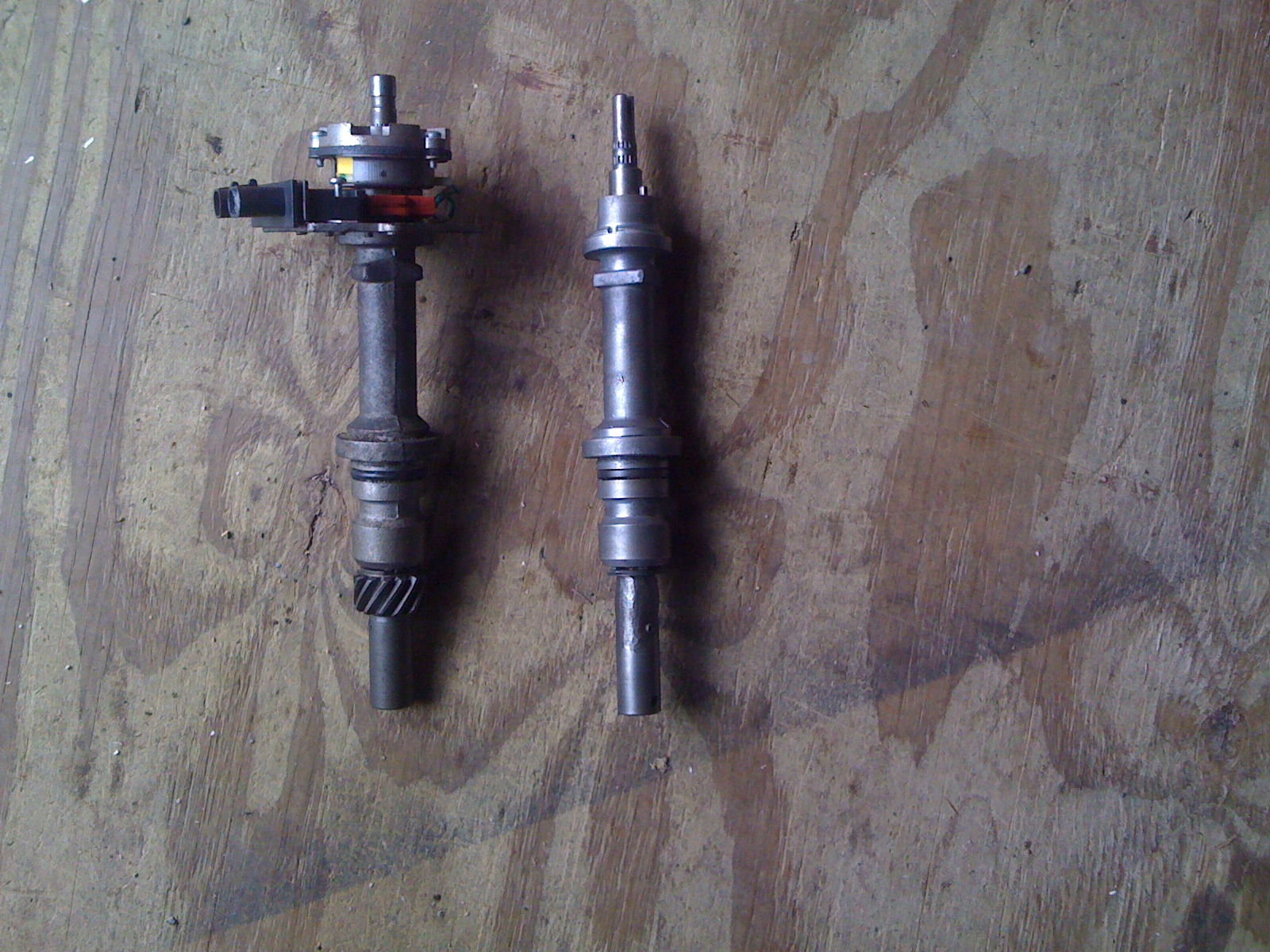

If you have an old distributor you don't mind cannibalizing you can make your own tool to prime the oil pump. If I recall all you do is remove the shaft from the distributor, re-install the gear, grind the teeth off the gear, then chuck up the rotor end in the drill & drop the other end in the motor.

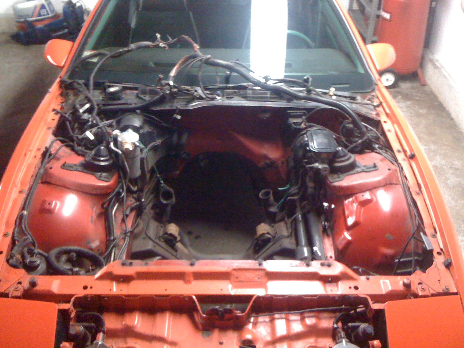

I began the removal process of the engine today.
Going to do as much as I can tomorrow before I go to work.
I will continue to update this thread as I make progress. Here are some more pics of the engine.

Old Mar 20, 2015 | 08:22 PM
southbaysd's Avatar
Joined: Jun 2014
Posts: 48
Car: 1990 Firebird Formula
Engine: 5.0 TPI
Re: Engine stops turning right at TDC
Nice pictures
Since you are here, are you going to take the heads out and install new gaskets? Maybe new rods?

Good Grief Lamancha dude , get those bolts outta the lifter gallery that I see in picture 3 ASAP !!!!!!
