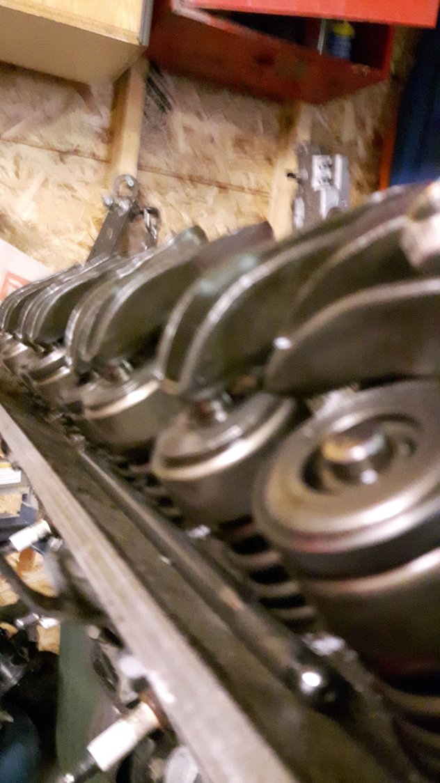

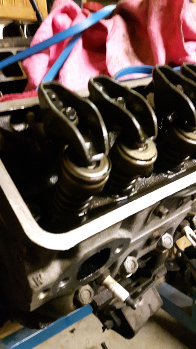

Hey fellas . Just a quick question . I'm doing a casual tear down on a 86 vette engine. And the spring retainers for the exhaust and I take valves seam different
Almost looks like a spacer . Is this a gm thing? Or after market ?

The exhaust valves get a lot hotter than intake valves. The retainer may include a rotator to help rotate the hot exhaust valve for better cooling and prevent hot spots on the seat.

Yup, that's the rotators. Useless dead weight in the worst possible place.
Throw em away. Put an extra .090" of shim under the exh springs.
The retainers themselves are the same on all.
Throw away those oil splash shields too. Use "positive" seals. Then none of that other deadweight is even excusable any more, let alone necessary.
