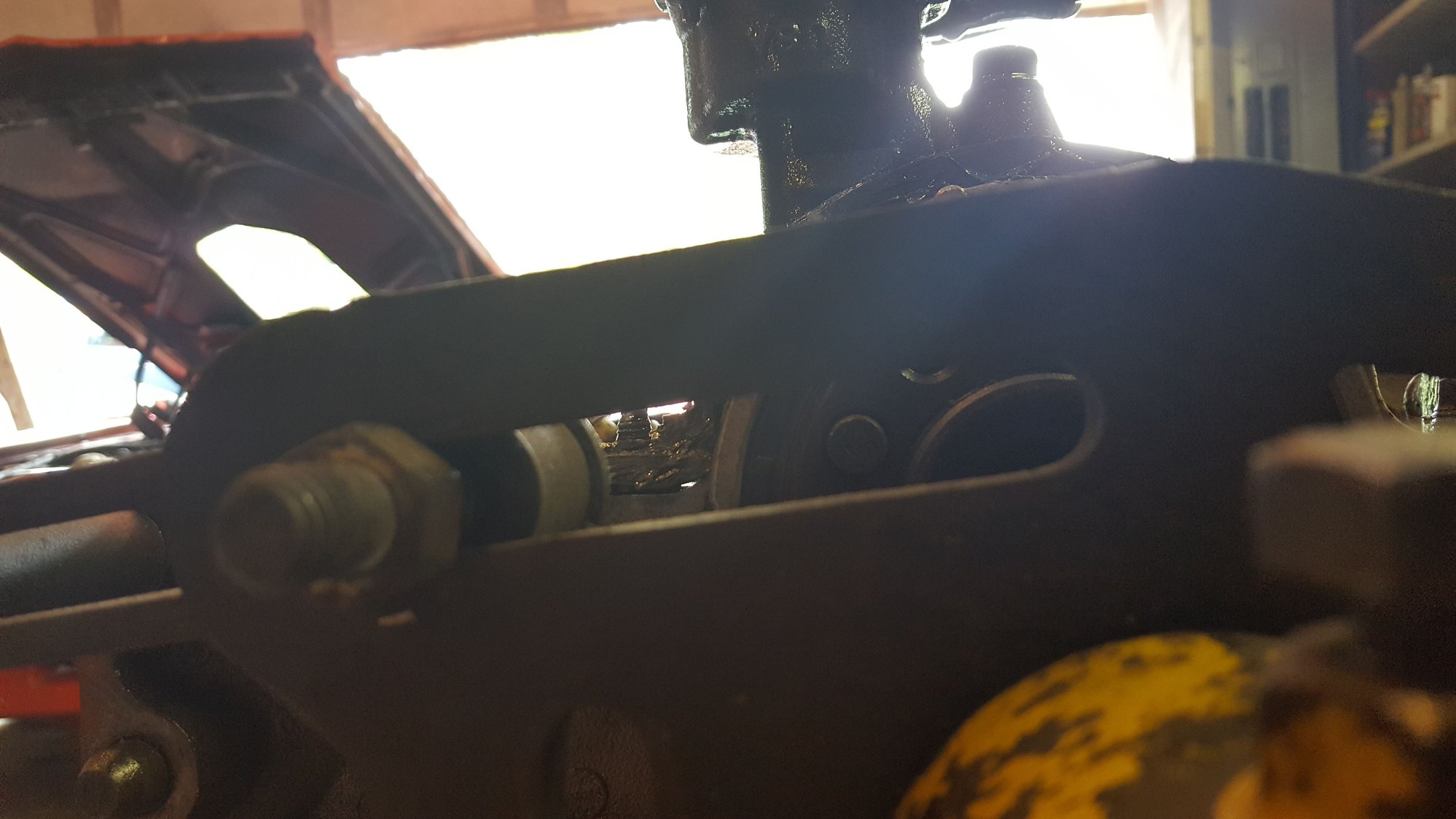

First thing to check is this.
If there's not a bolt in that hole, put one there. Needs to be a SHORT one, ¾" max. Put a drop of sealer on the threads.

There is a bolt in that hole since I am using the 89 serpentine brackets I had. There doesn't seem to be any oil that far forward on the engine. Also there isn't any very far "up" on the engine when I look from underneath.

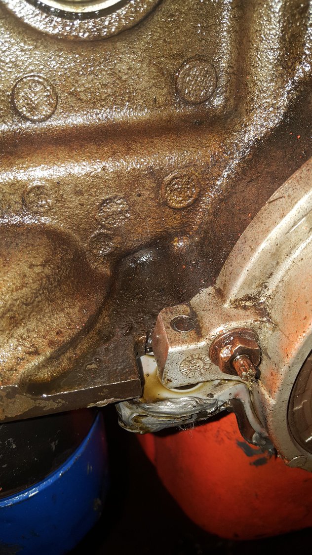

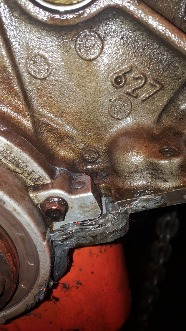

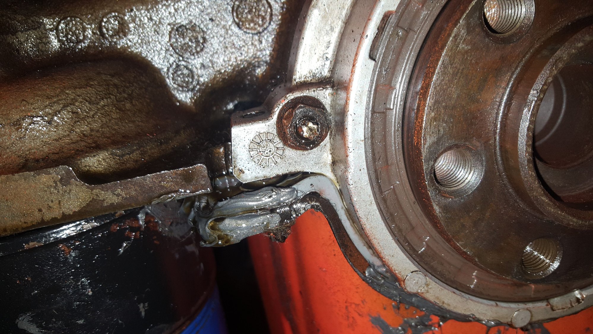

Reviving this thread since I pulled the engine out of the car and wanted to share what I found so far for anyone now or in the future
The sealer in the pictures that looks smeared on is what I tried to do from under the car but couldn't get very high above the pan with the flywheel on.
From the pictures is looks like the pan may be bent and the gasket isn't sealed all the way.

Does look that way. Have you pulled the pan to check it?
Most likely it was leaking while running. But, it was probably being whipped up by the flexplate and then dripped down while not running.

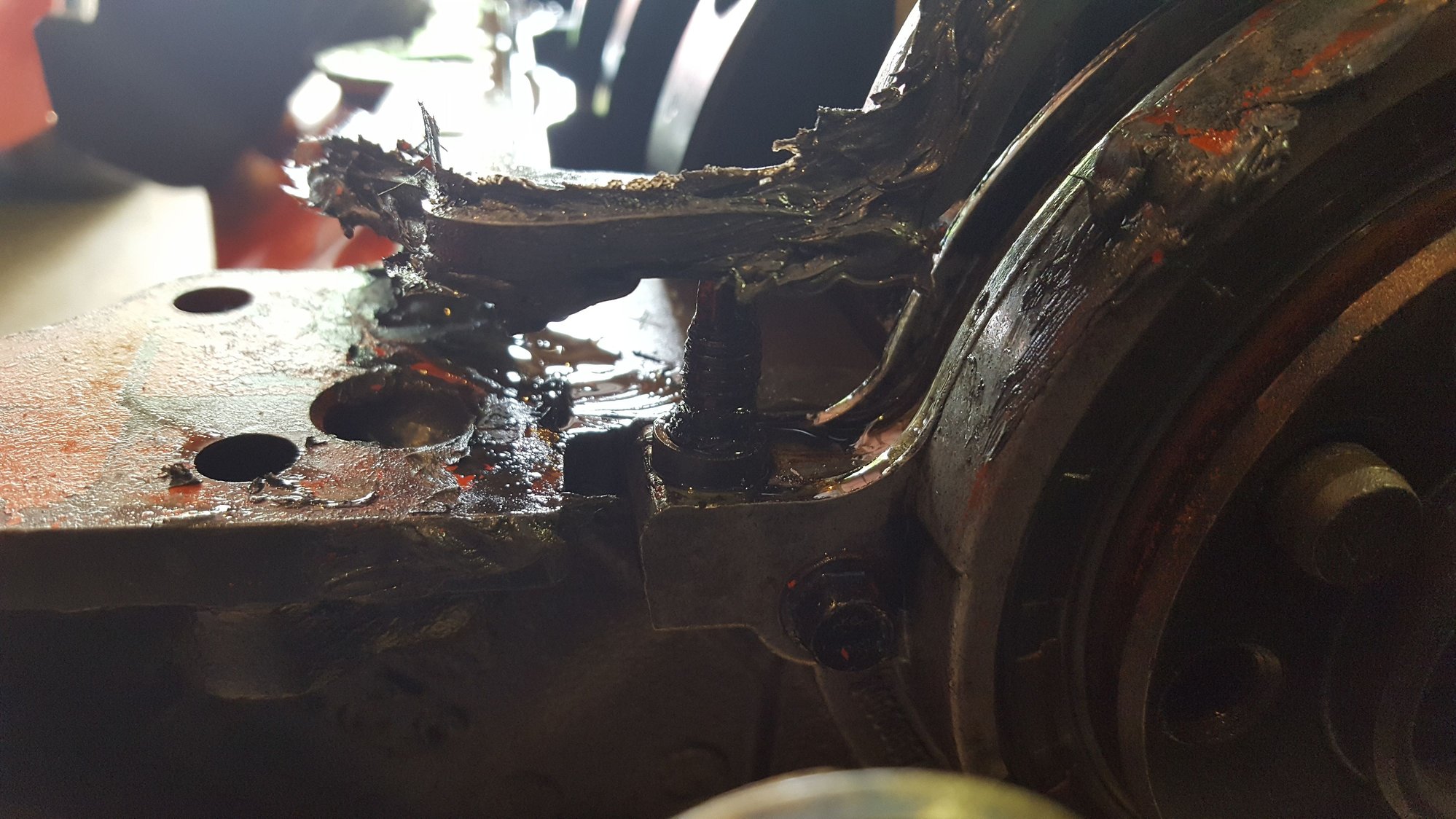

Well I pulled the pan off and can't really tell if the edges are bent on the pan or not. One issue I think I found is that the rear main seal housing has a "shoulder" on the back 2 bolts. The holes in the gasket I took off do not seem big enough to actually fit around these shoulders to sit completely flat on the block and housing.
The second photo shows the shoulder.
Has anyone noticed a similar issue with the pan gaskets? This was the first pan gasket I had installed on a 1 piece RMS block

On this particular case the gasket had been pushed out along the back of the pan due to excessive blowby
