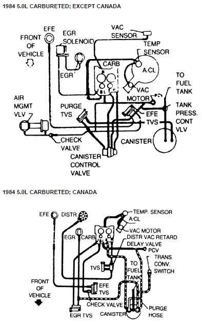

Then if can overlook that (I hope), I've got fuel collecting in at the end of the hose extending from the charcoal canister. This is the hose at the multi-hosed valve thing in front of the carb (has several hoses to it, i apologize for not taking time to research name of the valve, but you are at PC now and hoping for reply).

CANISTER CONTROL VALVE. Fuel is collecting in the lowest hose of that valve. Took the valve off the car and fuel poured out.

OK. Yesterday I misdiagnosed vacuum in crankcase, thinking failed intake manifold gasket. However, missed one of the vac lines of the PCV plumbing.
Backtracked on that.
Running rich. Backfires when cold when lifting off throttle.
This morning found that the Canister Control Valve is not functioning. When off the car there is a direct flow between CCV 'manifold vacuum from PCV' port and both CCV 'canister tube' port and 'carb bowl tube' port. Therefore I believe (for the time being) that PCV vacuum was drawing air directly from the carb bowl via CCV. Would explain why the CCV fills with raw fuel.
