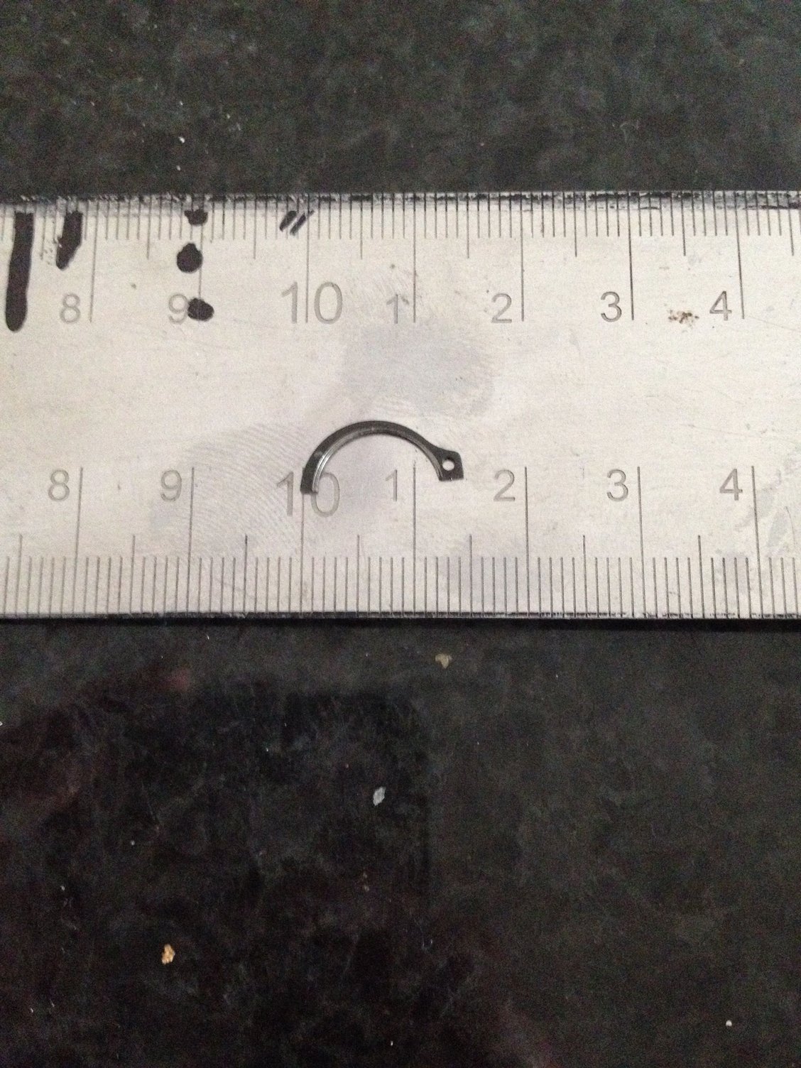

Hi guys. I recently purchased a used 350 crate motor and have been inspecting it prior to installing into the camaro. Apon cleaning out the bottom of the oil pan I discovered this fragment of broken C clip. It appears too small to be from a wrist pin so i dont know what else this could be from. Clip is about 5/8". Any ideas? The engine runs fine with no strange noises.

Does it have roller rockers?

Indeed it does. 1.5 comp cams rollers. Excellent call, i hadn't thought of those. Let me inspect them and get back to you 👍

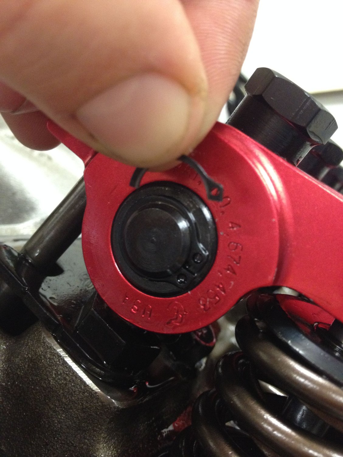

Well it sure does look like a roller clip 😃 However all clips are present and accounted for on both sides. Looks like one must have broken and been replaced in the past?? I have run a magnet across the tops of the heads and cleaned oil pan but cant find the other half. Should i be concerned if there was another half kicking around?

My guess would also be a rocker c-clip since it's an external clip. A wrist pin clip is internal and I'm not sure if any floating pistons still use c-clips. To my knowledge, all floating pistons normally use spiral locks.

Dont the lifters have clips in them also? Maybe previous owner swapped roller rockers and snapped one?

The broken clip goes around something. A lifter c-clip goes inside something.

Well i spoke to previous owner and he confirmed that he had found a couple of roller clips broken last year and so replaced all clips and that one piece was unaccounted for. Guess i will keep an eye out just incase there is anymore and be cautious that the roller clips are weak and could keep breaking. They are seriously undersized
