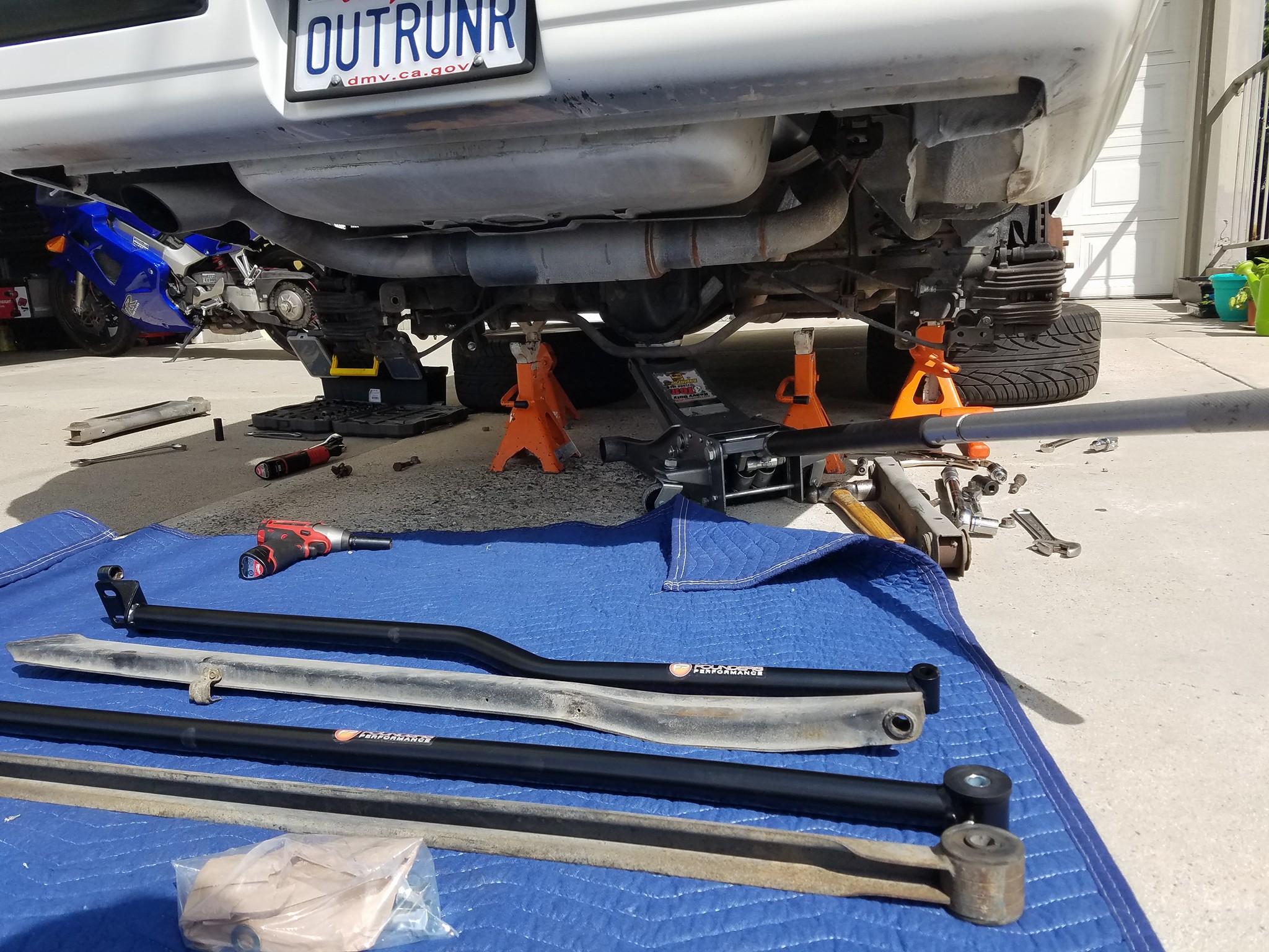

Hey all so i really need to get this tpi pump into my tank. I want to do the job myself just not sure if i have the ability to do it in my garage. All i have is a floor jack and set of jack stands. What im curious about is how high off the ground does the a$$ of the car need to be in order to be able to have the rear end dropped, and then wiggle the tank out?
How did you do it?
Is this possible with a floor jack/stands?
Would you have paid some one to do it again?
Enlighten me with some success stories!
Thanks for your time and information!

About 40 inches from ground to arch of wheel well. What I found out is to get the front up about a foot also. Put it on Race Ramps. That way it doesn't "look as bad" and will give a little room if you need to disconnect the pipe at the Cat. HTH
Myself and a buddy did it start to finish in 4 hours
It was easy, no rusted parts/bolts
And when it was over with, we had pizza and beer. Good times
And saved around 400 bucks
Get a quality pump/screen sock and all, and if you have spendable income, put in a new float assembly
Was not bad at all. That was 15 years ago, 100k miles, with a GM pump. Drove the car yesterday. No issues

As stated above, but basically just high enough for the rear end to drop down as much as it will allow. Once it stops, there's no point to go any higher.
If you don't run into any really stupid stuff like I did, you should be fine. I was swapping my tank and the elbow was at a different angle, wouldn't go in. That was a few days of headache/welding/etc.

40" from the peak of the arch or of the bottom( I.E Base)? After more research today, It looks like its do able just i have aftermarket exahust (flowmaster 3" catback) that i'll need to most likely have to cut down in order to get that fuel tank out.
yeah i have a AC Delco Fuel pump & screen waiting to be installed, sounds good!
Do you really have to turn the fuel tank 90* to the right in order to get that filler neck out??
Once again thanks all for your time and advice!

Yup remove the exhaust disconnect the shocks and the brake line bracket mounted on the drivers side and rotate the tank to drop it out. If you dont you risk cracking the tank at the filler neck. Ask he how I know. Spray all your nuts and bolts with pb blaster or wd40 the day before you start.

Good idea to soak the bolts the night before.
Do you guys think i should pull the fuel pump relay and kick over my car a couple times to get most of the fuel out of the lines before going and breaking them loose? The pump in the tank is fine still i just want to get this TPI pump in.
Also how did you guys handle the brake lines on the rear axle? Where the able to come loose enough so that the axle can hang no problems?
Once again thanks all!

Unbolt the lines from the body of the car to allow that extra movement.
You're doing what I did, over thinking it. Just get out there and do it; it's very straightforward.

Put the rear in the air till the front bumper almost touches the ground.

Wow didnt know my pictures came in sideways? any who awesome thanks all i think im going to attempt it next weekend!

I was back under there today on the 89 doing lower control arms, panhard bar, and a panhard bar relocation kit. It's amazing how quick stuff goes after you've done it a few times.
Nice! What brand did you go with on those pieces and how are you liking them so far? Also what exhaust is that? 3.5"?

Re: Fuel Pump Replacement; How high does the rear of car need to be in the air?
Founders Performance on the rear goodies. I went with non-adjustable as I don't plan to lower the car, or make it an autocross machine. Just a Daily Driver that hits the canyons occasionally.
https://www.foundersperformance.com/...maro-firebird/
https://www.foundersperformance.com/...s-panhard-bar/
The exhaust is a 3", but I'll be swapping it to true dual 2 1/4s since I have room now. That will be after the intake upgrades (SuperRam upper and lower, SLP 1 3/4 headers). Debating if I should swap heads and cam at the same time...
Nice looks like some good stuff! i dont know why just that pic makes the exhaust look huge.
I wish there was some canyons to drive in here in the valley. everythings flat for miles

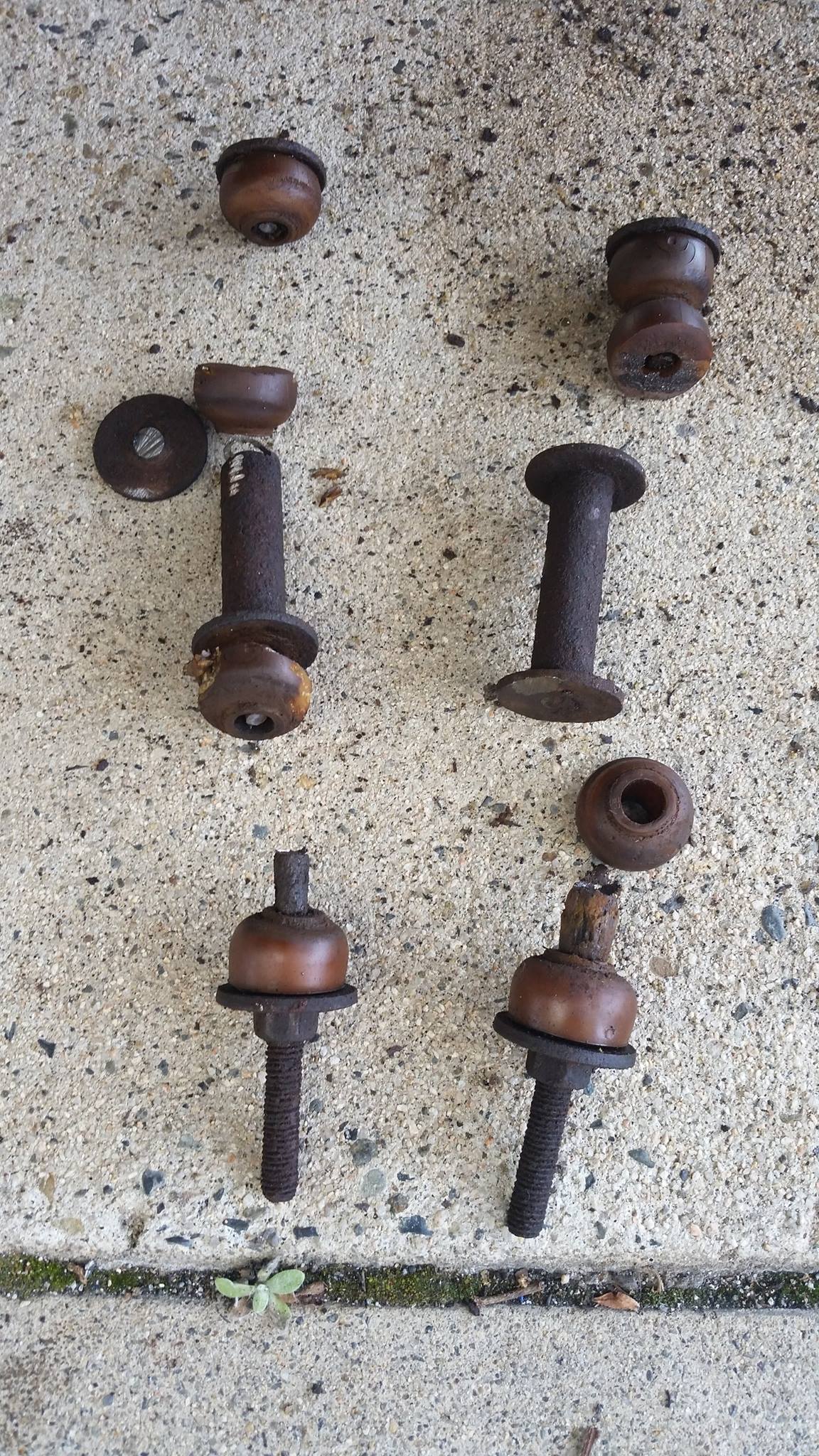

What is this?
After pulling my muffler down and cleaning it down for a quick one i heard some rattling coming from within it. I peered inside and noticed this, i was able to pull it out.
EDIT: after more research it looks like catalytic converter honeycomb material... ****

It is!!
Unbolt the pipe behind the cat, and see if you can knock out more, before it comes loose by itself, wandering all over the exhaust...

Very glad you got this handled, the right way! I had to cut the end links off our 88. Saved me that 45 min
Yessir! No chopping up my f-body for me. WOW looks very similar!! If i had the tools to cut it out, i would of lol.
Just wanted to say THANKS AGAIN TO EVERYONE for helping out with your time/information and advice! It Wouldnt have been possible with out this website!

So unfortunately somethings not right with the suspension. When going at an angle over large driveway entrances (into parking lots and liquor stores) i hear a weird POP sound coming from my rear passenger side. Sounds like the spring or shock is getting caught and releasing tension and hitting the frame of car. I did re use the original bump stops. I thought i "indexed" the upper coil correctly, but maybe i didnt.
Its only from the rear passenger side and not from the rear driver side and ONLY when going at angle over a large driveway. When going straight up/down personal drive way there is no sound, everything seems perfect....
any ideas where to start? One thing to note, ive checked every bolt already and everything is tight as i can get with hand tools. The top shock mounts are a b1tch to grab (because you have to hold the top small *** mount with a crescent) but they seem tight as i can get.

So these ****ing sway bar endlinks are the cause of the loud pop. I just spent 4 hours redoing my suspension, dropping the rear end, unbolting shocks, reindexing springs MULTIPLE TIMES. With no help. I even moved over the passenger side shock and spring to driver side and the loud pop was still there. I said screw it "i wonder" if i take these endlinks off will it cause that sound? and what do you know it yupp, its these Energy suspension end links, or maybe my installation yet not sure how else you can put it on. I think i had them on too tight or something but the damn stud they supply is SO DAMN SMALL that its kinda scary driving around with only a couple threads holding onto it, thats why i actually had it tight. Can anyone else chime in with these damn things. so glad to know its not a bad shock or messed up spring. AND now im a damn pro at dropping the rear in this car lol
So right now the sway bar is just bolted to the rear end hanging there.
EDIT: im thnking about going and grabbing some duracrap and just throwing my poly bushings on it.
http://www.autozone.com/suspension-s..._461303_0_4145
EDIT #2: actually looks like the duralast swaybar links are manufactured by moog.
