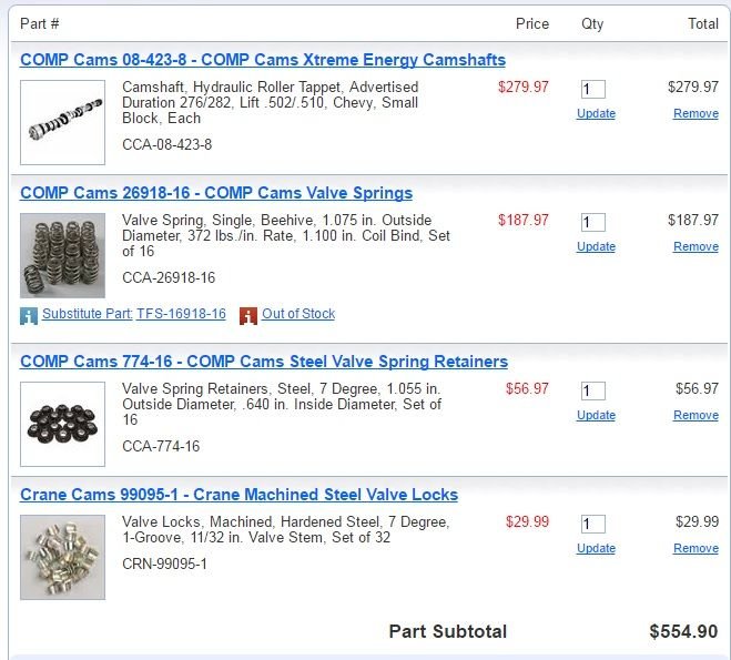

Keeping the factory roller parts, (lifters and retainers) means that you're only swapping the cam and adding the better springs. The pushrod length will have to be addressed no matter what you decide to do as any change in the valve train means that the length may have to be changed. That's valve train geometry 101.
With that in mind I shopped the parts out at just under 600 bucks.
These springs should drop in with no modifications needed. The offset locks are needed to help with the spring installed height.

thank you when i called comp they set me up with a kit that was in the 900 range

My guess is that the "kit" has more than you need. But that's just a guess.
Do you have their part number? I'd like to see what they suggest.
