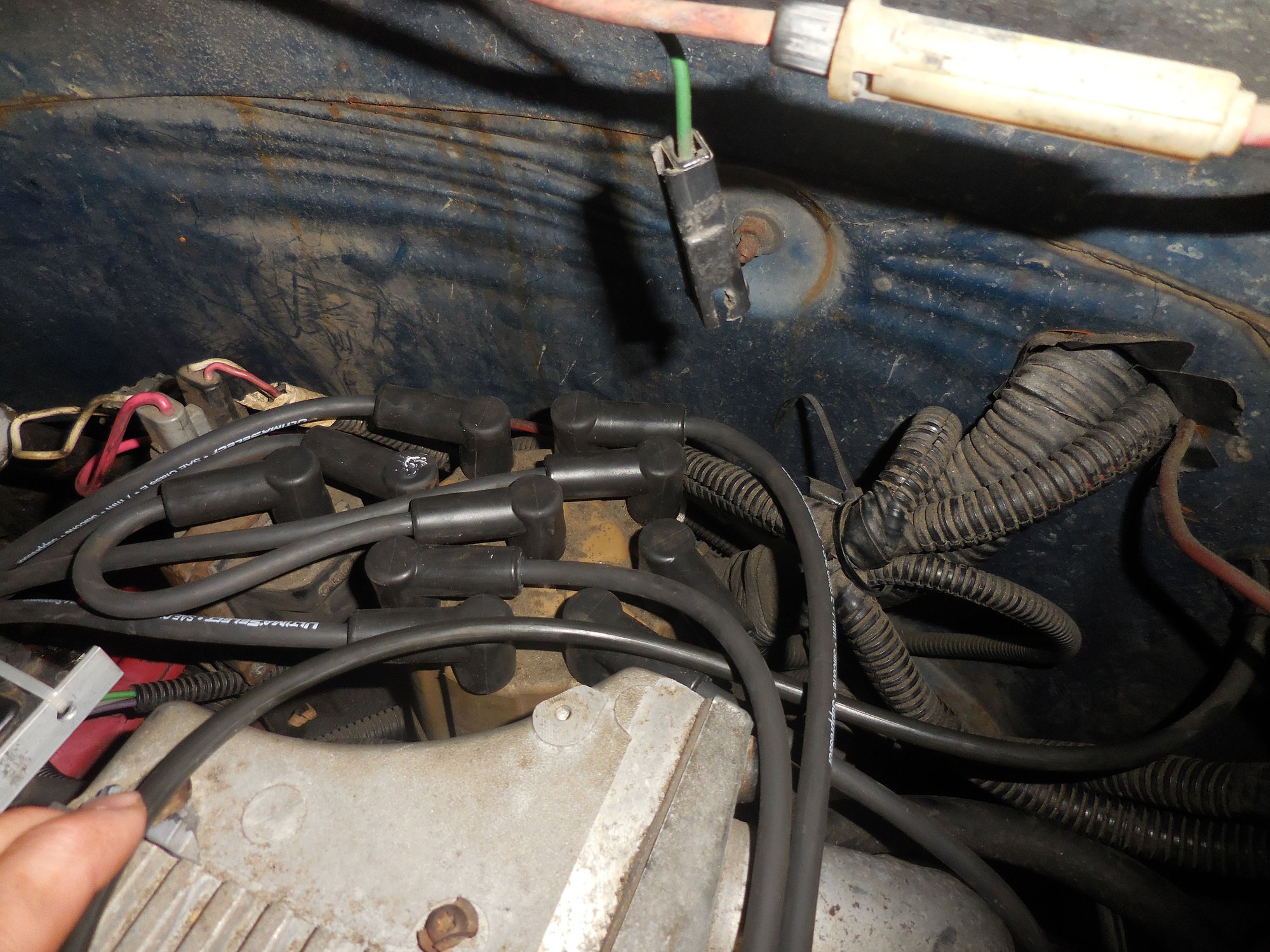

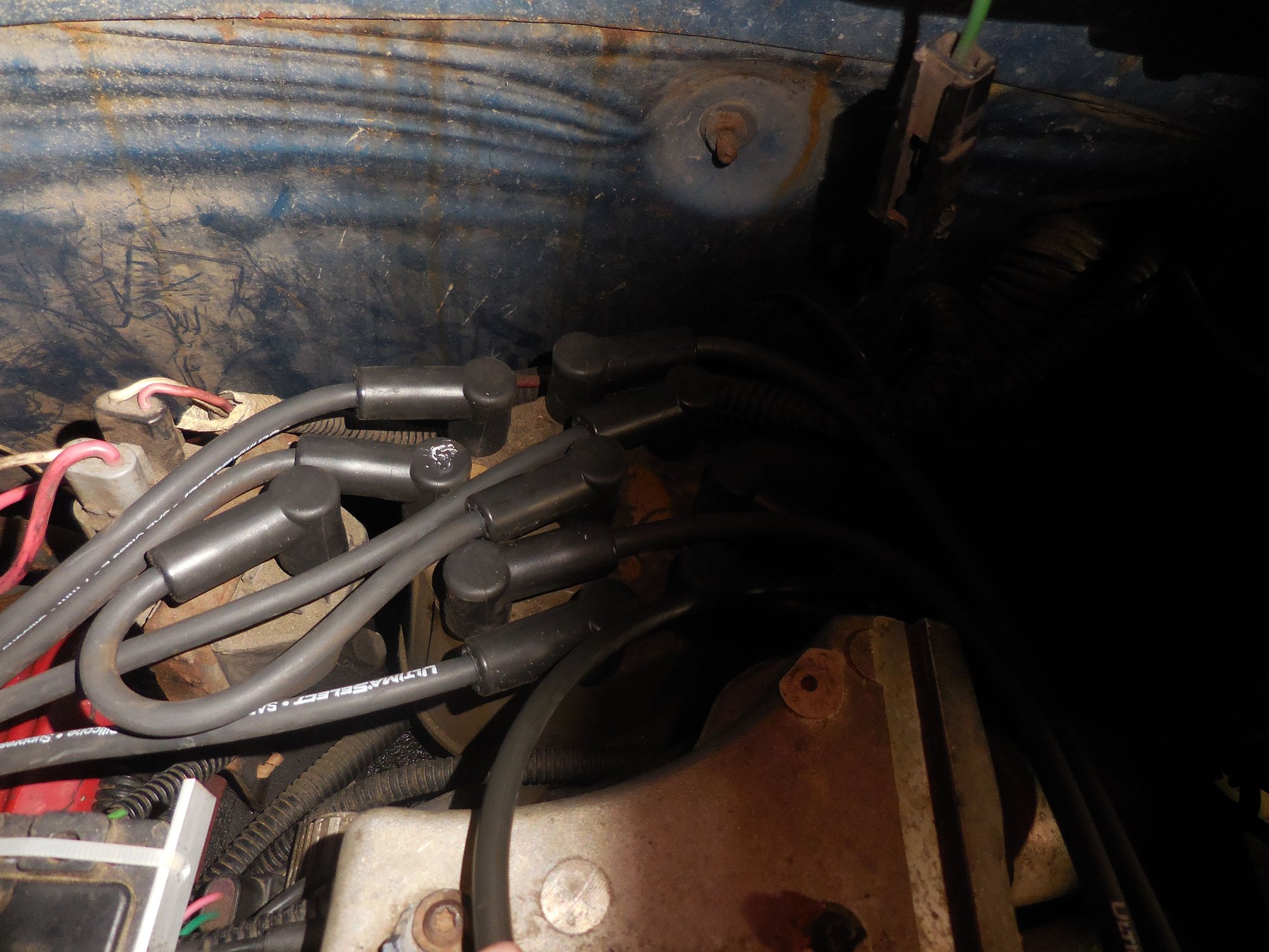

I think i located the fuel test valve , is it right under the map sensor?
also what is the correct fuel pressure psi i should have? 1990 tpi 5.7l
so heres pics of the dizz , i would say thats a mechanical advance dizz correct ?
no vacuum things coming out of it not sure what else type of distributors there are.
ALSO id like to point out that the plug wire with the white paint on it is actually cylinder #8 and as i see on a lot of firing order diagrams for the firebird tpi, the orientation of the dizzy has #8 cylinder wire at the front of the dizzy but as you can see mine is back there more on the left.
Does this make any difference ? orientation of the dizzy?

Looks like it's been converted to tpi. That's not a mechanical advance distributor but it's correct for what you have. Check the fuel pressure and put a timing light on it. Also rev it with the light on and make sure it's advancing.

Re: "bad acceleration" need help pinpointing
It's a hei divorced coil
