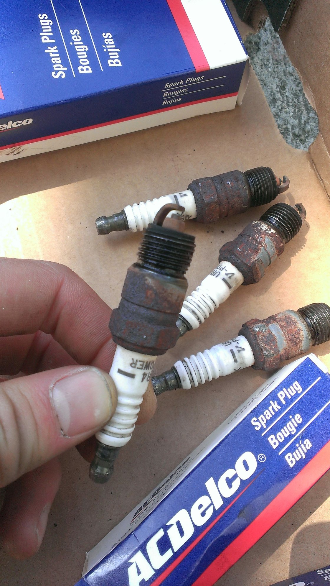

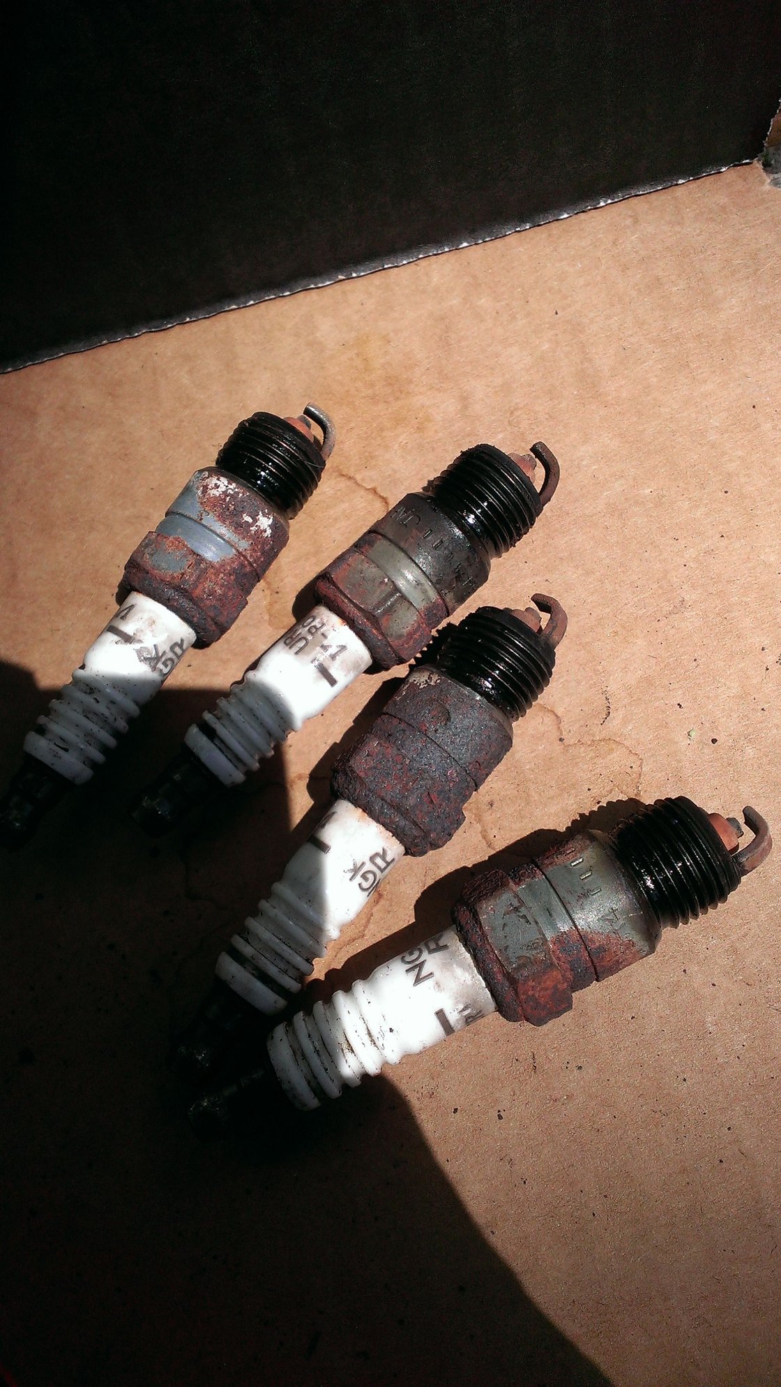

i swapped the plugs heres a pic of the old plugs (top pic is 2 4 6 8 and the bottom pic is 1 3 5 7)
the liquid on the plugs seem to be gasoline mixed with the oil (im guessing from the leaky fuel injectors i had)
very excited, got the new plugs in and the motor is running pretty good!
did a burn out and has decent power.
you are right the fuel delivery system ...it is old .. i have a feeling the pump my be going out soon and the filter looks like it hasnt been changed in years. if i were keeping this truck id replace them. but as for the "combustion failuire" issue new plugs seemed to solve the problem very well.

Those plugs look fine to me.

yes they look in shape and look like the can possibly work.
but the rust tells me that they are OLD and would explain why they possibly werent doing theyre job. im not 100% they were not working , but the result of replacing them seems to show that they were "broken".
