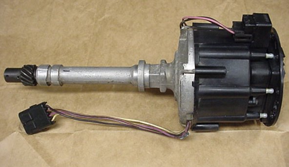

Was the timing checked with the 4 wire connector coming out of the other side of the distributor base disconnected?

I did not touch anything at the distributor as there is no vacuum advance. Are you referring to the ECM connector?

Re: Timing
I guess you can call it that.
This must be disconnected to check the timing.

Ah that might explain the reading then
Looks like a bitch to get to but I'll have a crack later today.

Here's what the EST looks like. Its by the heater fan motor. Here's the timing procedure.
Start car and idle until the car is at operating temp. Disconnect the EST wire, adjust timing, reconnect EST wire. Shut off car .
Take it easy on the car for a day or two. Street and a little highway driving so the ECM can learn its new parameters. It can take a little while but after that it should run fine.

The connector you need to disconnect to set the base timing is shown in the attached image.
