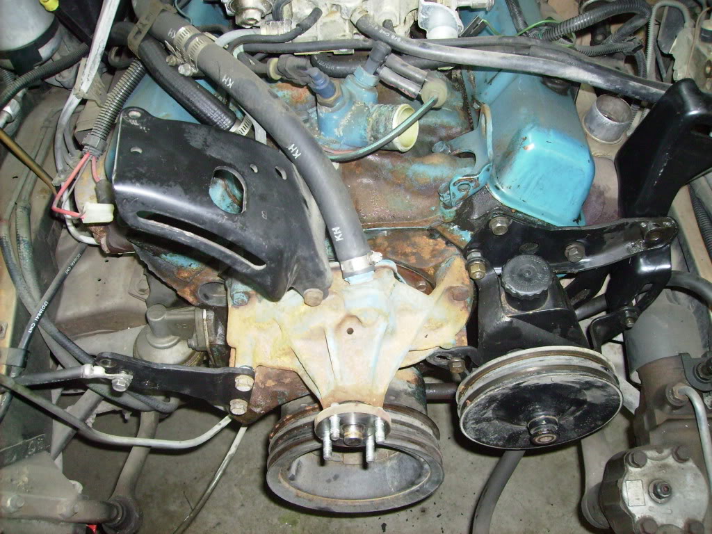

I had to borrow these pics from other members - they show what I'm trying to explain perfectly. I hope you don't mind.
I currently have the all v-belt setup and will be switching to the mixed v-belt and serpentine setup. A/C and air pump will be removed and I fabricated my own brackets to mount the alternator halfway between the stock location and the where the air pump was. My question is does anyone know of an inexpensive (March is OUT) and better designed set of brackets to mount the power steering pump in nearly the stock location? Yes, I have the "A" can v-belt pump - same as shown. Since he A/C will not be there, I don't need the factory brackets that are intertwined with the A/C compressor. Plus I hate the factory PS bracket with its hidden and hard to get to adjustment bolts/nuts. I'm also using SLP headers.

1) because I already have everything for the mixed setup - I just want better (more user friendly) PS brackets.
2) My alternator is on pass side. Converting to full serpentine changes it to the drivers side and I don't want to add more bracketry (and delete pulleys) to have less accessories. All I will have is ALT (1 serpentine belt) and PS (1 v-belt). SIMPLE.

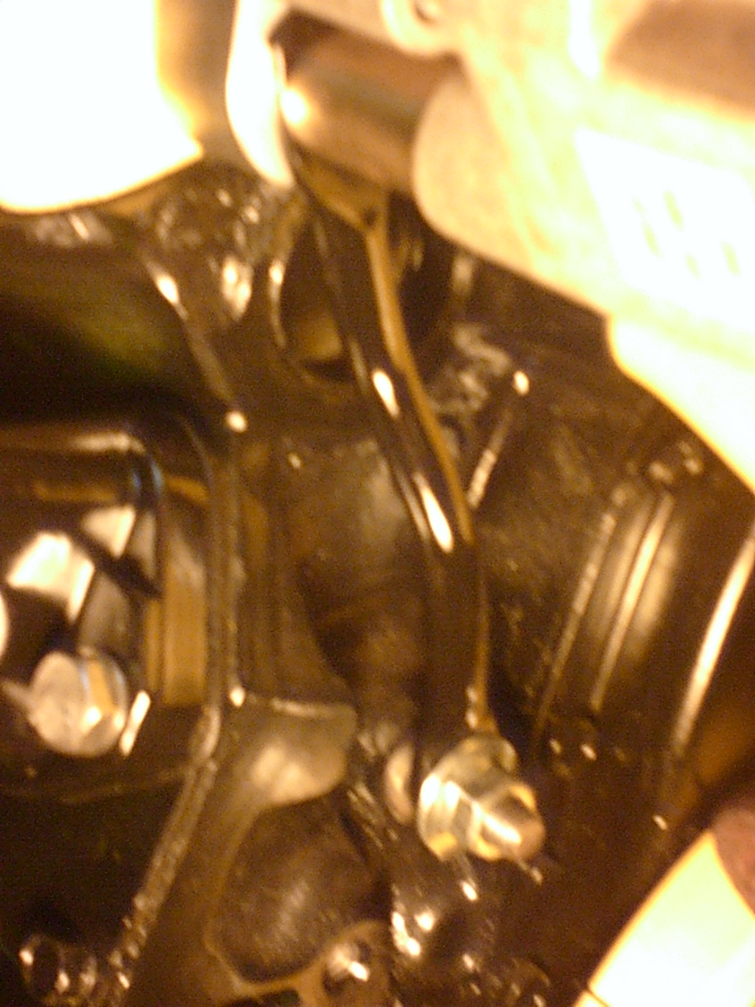

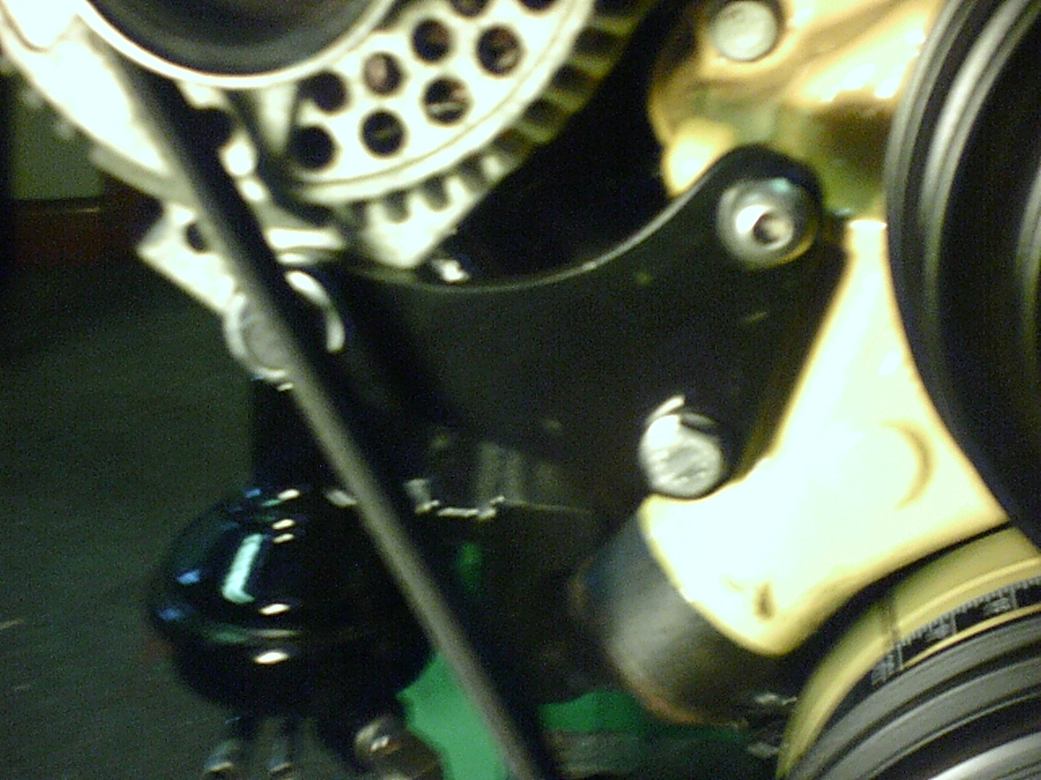

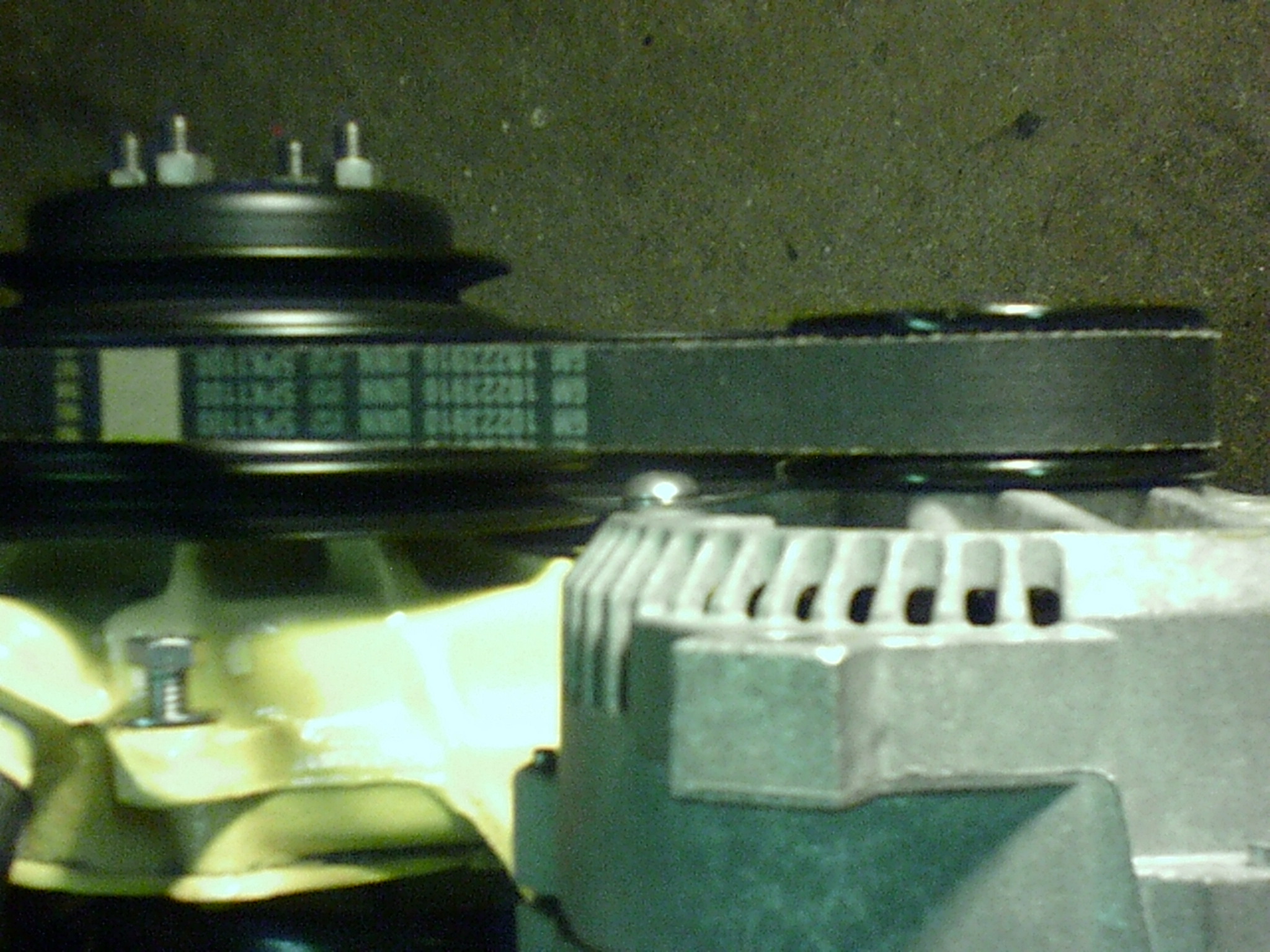

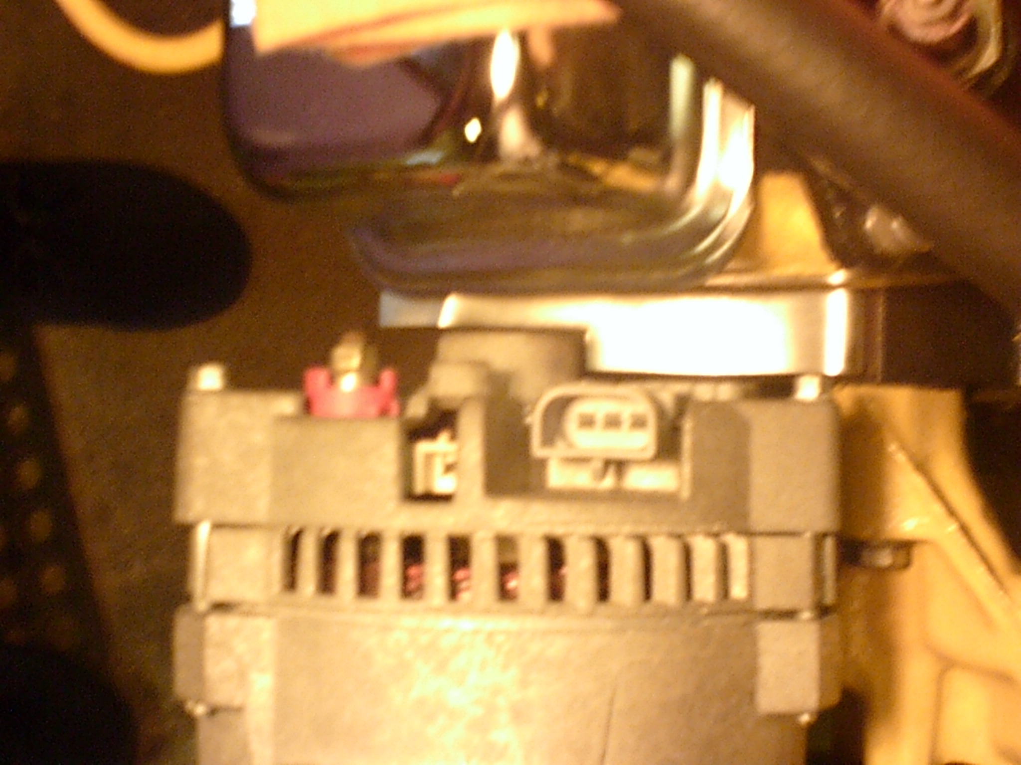

OK, I considered it. It still ends up more complicated. With mixed I do not need the L & R side serpentine mounting brackets, reverse rotation water pump, tensioner, and pulleys. I'm looking to remove as much as possible to gain room under the hood, for ease of working on it and airflow (cooling). Both the ALT and PS can be individually tensioned. I will have great belt wrap. I think I can even add a 2nd v-belt if the PS should want to slip.
Attached is some pics of my lowered ALT mounting.
