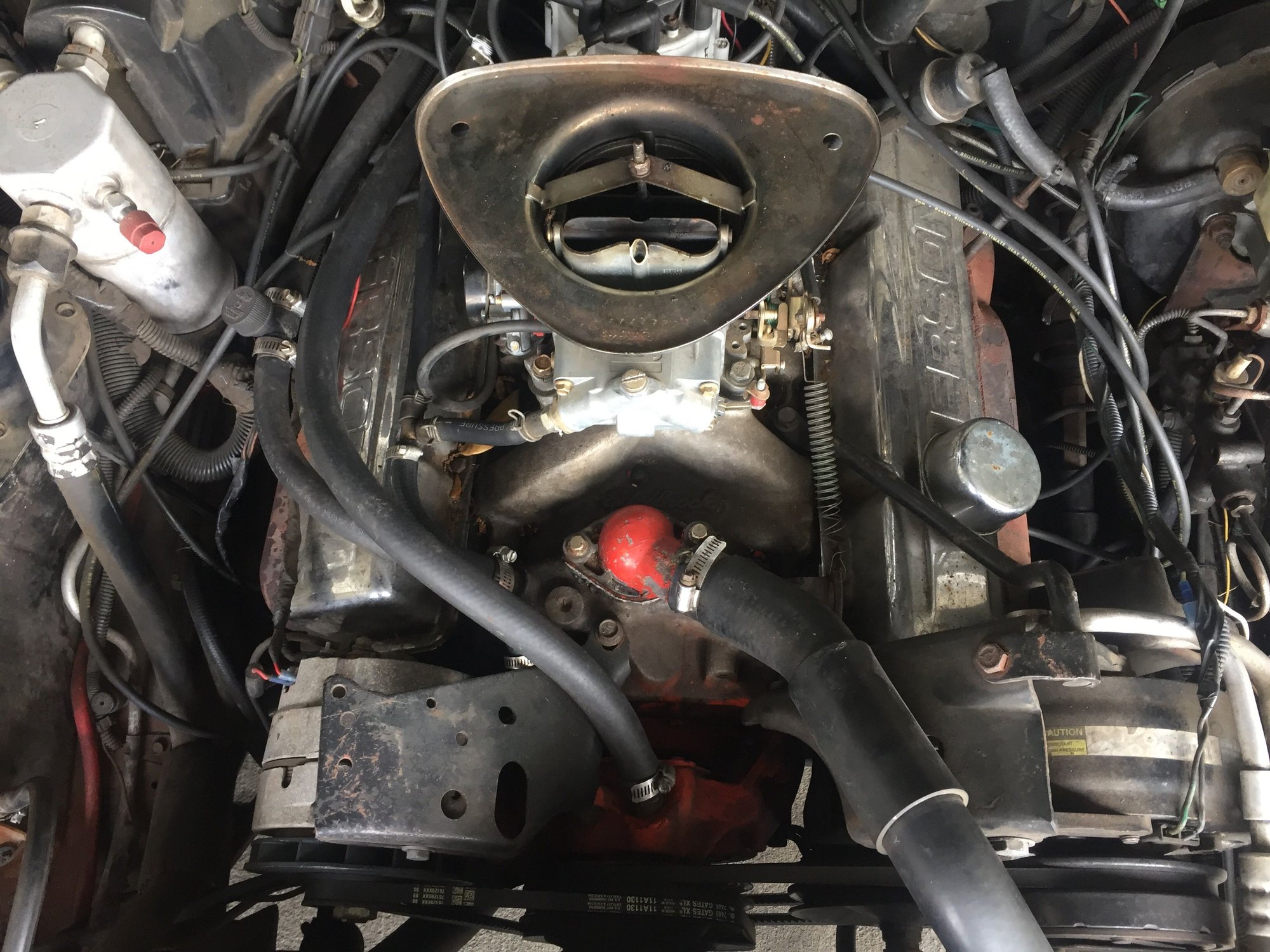

Here's a pic.
The fuel filter is also in the fuel line of the carb, correct?

Yeah man no fuel injectors there, it's a Holley four barrel with electric choke. Fuel filter should be in the fuel line, I'm not familiar with a Holley but quadrajets have one that is behind where the fuel line threads into the carb. Also yours is a dual line, I'd do away with all the rubber fuel supply lines and get a hard line for it, most auto parts stores carry them.

Yup, that's all pretty much a hack job on top of that motor. If I had to name ONE THING that has caused the greatest number of cars to burn to the ground throughout time, it would be, rubber fuel lines.
Another thing that absolutely needs to go, is that Triangle Of Death thing on top of the carb. Those are NOTORIOUS for catching fire and dripping molten foam plastic goo into the carb where it re-solidifies and becomes all but impossible to remove especially from all the little orifices. Get that off of there ASAP and put a real air cleaner on it.
But yeah, that's a carb, not any kind of injection. No need for the O2 sensor except to plug the hole in the manifold.
Yes, the fuel filter would be in the fuel line leading to the carb, if there is a filter at all.
Why do you think that's a 350? It very well might not be, you know. Check the block casting number to be sure; conveniently located in the most accessible and conspicuous place possible: on top of the bell housing flange, behind the driver's side head. [/sarcasm]

get that thing up in the air and snap us a pic of the transmission pan as well, we can let ya know for sure what trans you got. And get rid of the heater hose with the tap in it for flushing the heater core that thing will eventually cause you to possibly toast your engine.

There are too many possible causes for that motor not idling to even start a list. One thing I see is the choke fully open. Assuming the engine was cold when you snapped the picture, the choke is disabled. That will make it not want to idle when cold. Next thing I see is black soot around the inside of the carb, indicating it's probably backfired atleast once. One thing Holley's are famous for is power valves that rupture when the motor backfires and then dump fuel into the engine.
One big red flag is that someone built a racecar not so well, ran it and then sold it. In between these two things they probably ran it hard. What kind of shape the motor is in is a big question.
