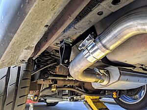

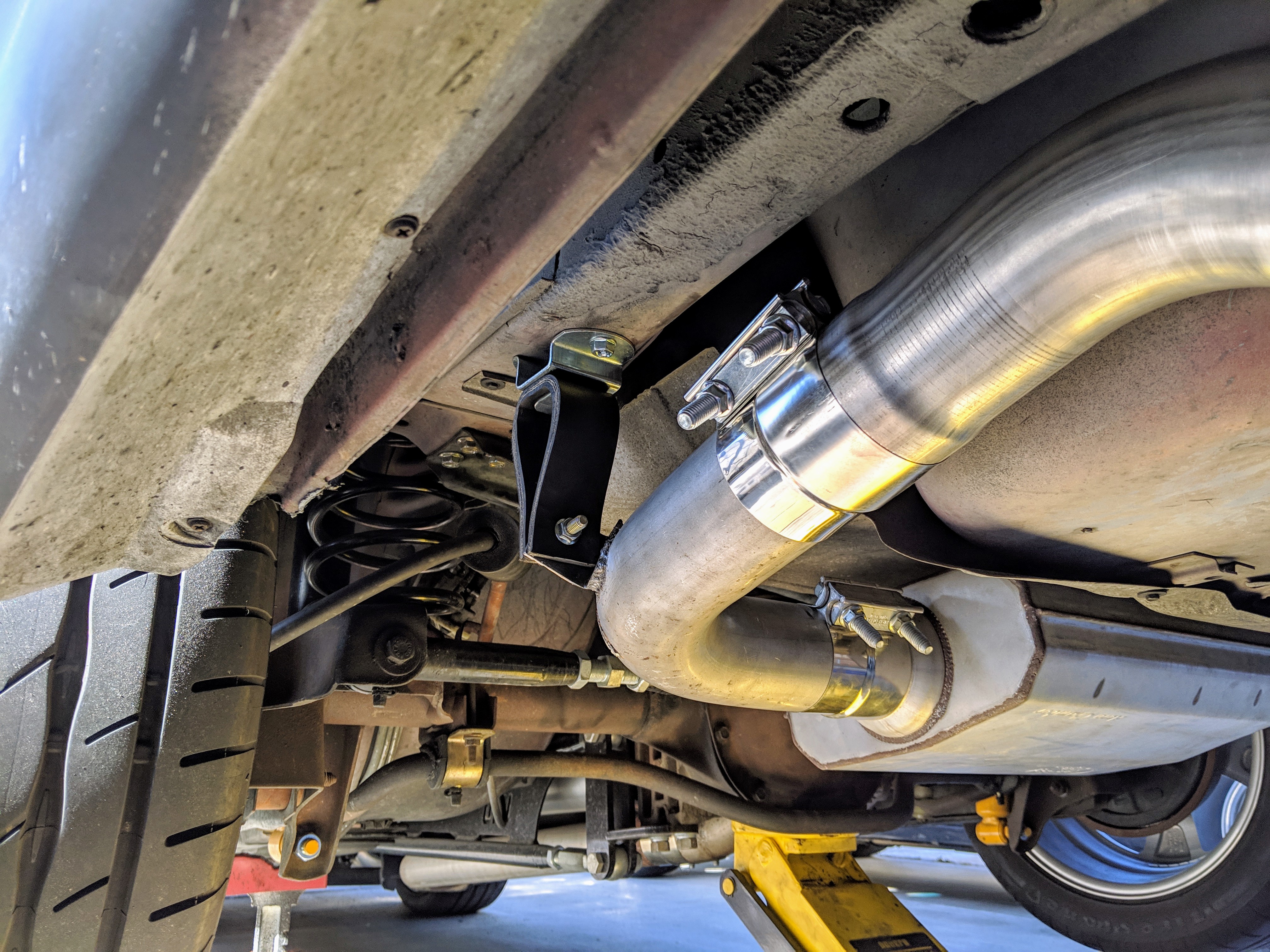

Re: what did you do to your thirdgen today?
Loving the Fiero seat tracks under the driver's seat. Much nicer to drive. Actually feel like I fit now.
I swapped the muffler back to my 3" Hooker Aerochamber and finally redid the exhaust hangers in the back with some OEM style ones. Also switched from a straight tip that points straight back to a slash-cut turn down like the stock tips. I'm liking the turn down tip because I can actually hear the exhaust when the windows are down now. Makes me wonder how the Magnaflow I took off would've sounded with stock style tips. Haven't driven on the freeway yet, hopefully the new tip doesn't make it drone.
Ignore my horrible welding and how I was too lazy to grind the welds from the old mounts off of the pipes.

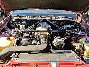

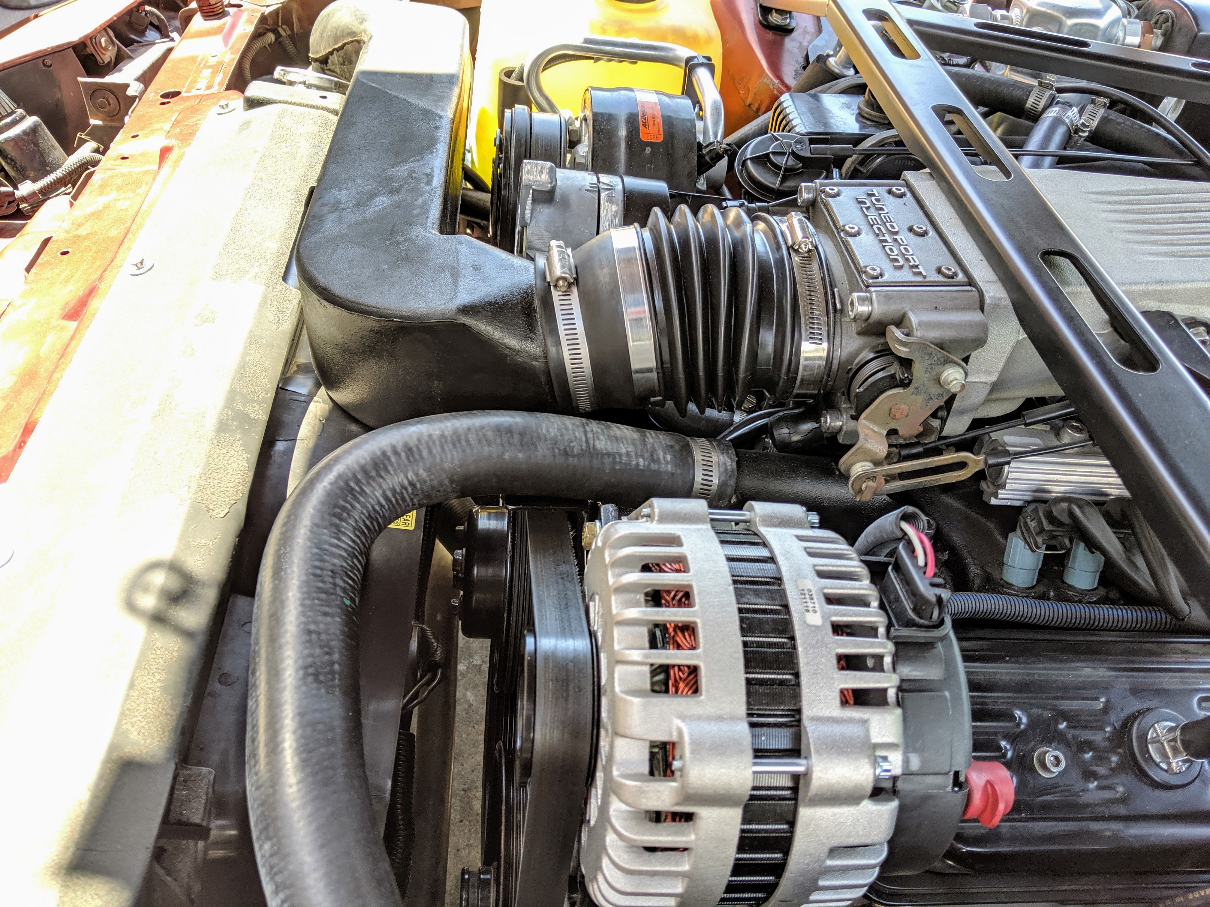

Finally did a serpentine swap. Went with an AD244 alternator too since the wiring needed to be extended anyway. I was able to bend the 85-87 TPI fuel hard lines around the front of the alternator/PS bracket, but they're really close to the belt and it looks kind of ghetto so I'll be keeping an eye out for some 88-92 lines. Still a few things to wrap up tomorrow but I finished it up enough to refill the coolant and power steering and go for a quick spin.
A friend had installed some fancy aluminum underdrive pulleys on his 3rd gen so he let me have this old ones, including an old junk AC compressor but with a good clutch/pulley so that I could swap them to my compressor. Waiting for a couple things in the mail tomorrow before I can install the AC lines and fill the system.
Didn't get the little bracket that keeps the upper hose from hitting the belt so I'll have to make something for that. I also just realized a little while ago that the alternator is probably grounded very poorly because I painted the brackets (one was new and the other was from the junkyard) and didn't clean the paint off of where the bracket touches the engine or the alternator, so I'll have to do something about that too.
Not thrilled about the octopus thing going on on the passenger side between the AC lines, AIR lines, and heater hoses, but the rest of the engine bay being easier to work with is worth it to me. The AC lines running across the radiator with the v-belt setup was pretty obnoxious.

Finished up the serpentine conversion by recharging the AC and making a little belt guard for the upper radiator hose. Working nicely so far. The vibration that the AC compressor used to cause at low idle RPM seems to be gone now too. Probably should've swapped in a Sanden compressor while the system was open, but maybe next time.
I swear the engine seems smoother and quieter and revs a little more freely, but that might just be the new parts placebo effect.
Debating getting a new AIR pump or trying to rebuild the one I have. I've never had a new/rebuilt one in front of me so I have no idea how these pumps are supposed to sound or feel when you spin them. The serpentine one I got is quieter than my old one, but they really both seem like they have noisy bearings. Probably going to take apart the old one and see what I can find first.

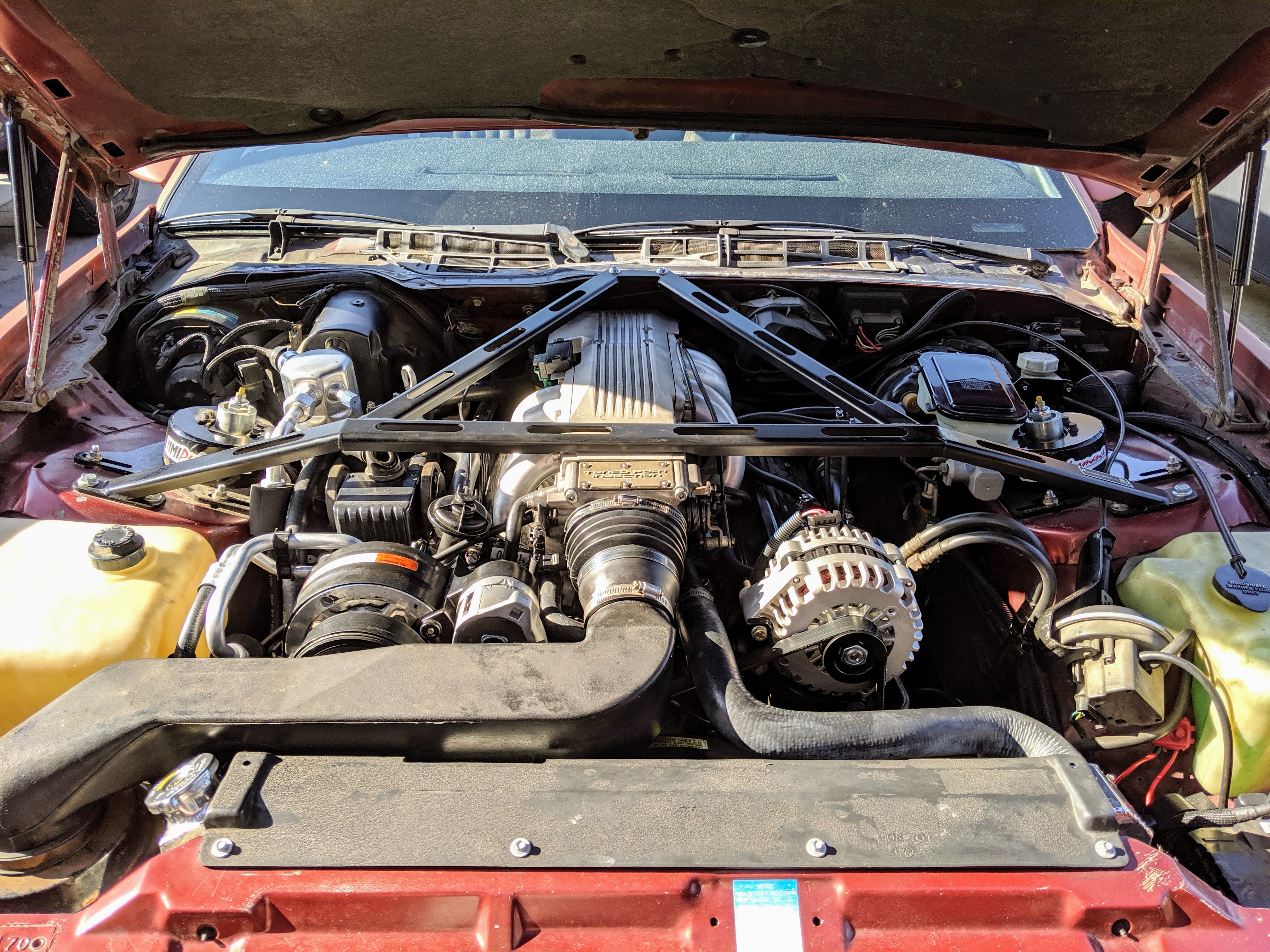

Finally took the MAF intake ducting out. Wow is it heavy compared to the MAP stuff.
Had to find some other coupler (4th gen LS1 car), cut a bit, and then extend it a little with a rubber pipe coupler from Home Depot since I couldn't find a correct and reasonably priced 3rd gen coupler. The 4th gen one is round and pretty stiff, but the heat from the engine softened and formed it a bit to the new angle and throttle body shape.
Still figuring out the EBL P4. It runs okay, but surges in closed loop. Trying to wrap my head around the prop gain stuff. Either something is whack with my setup or the starting bins are way out there in regards to the prop gain settings.

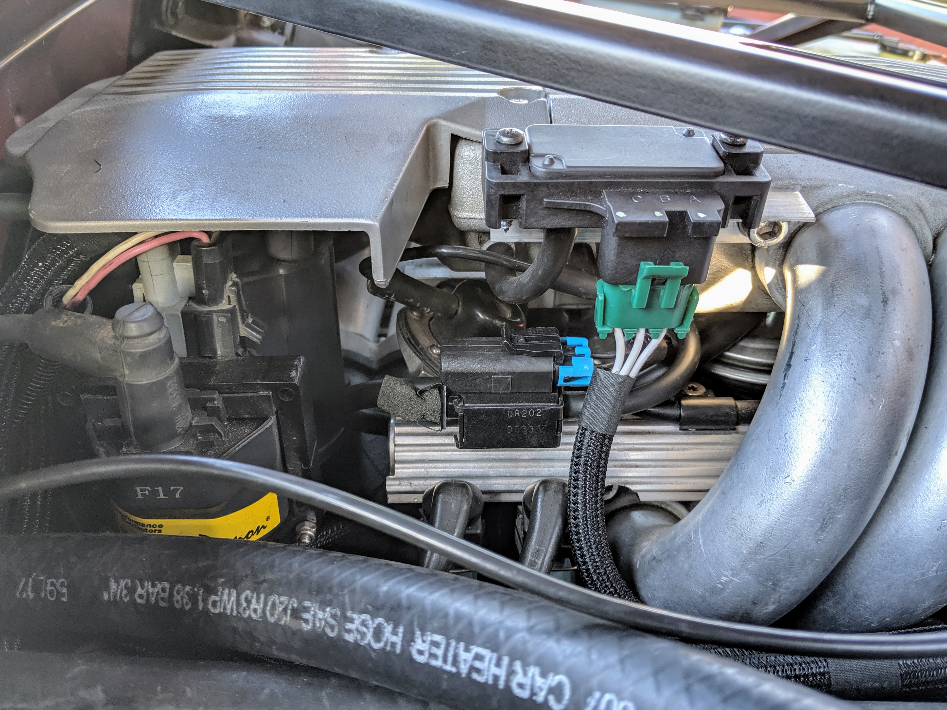

I had replaced the MAT in the plenum with a birdcage style one and relocated it to the intake ducting for more accuracy a few days back. So today I finally removed the old one and replaced it with a barb fitting so I could move the HVAC/cruise vac line to it and give the MAP sensor for the P4 has a dedicated vacuum port.
Made a little bracket out of aluminum angle stock for the MAP so it can sit roughly where a speed density setup has it. Gotta take it back off and clean up the corners so it looks nicer. Doesn't sit quite where I wanted it, but it's good enough.
Replaced the EGR solenoid with a new one for a DeVille like in this thread https://www.thirdgen.org/forums/tpi/...-solenoid.html. Used to have an old crusty Corvette one shoved in down by the distributor because the original was shot. I like how the new one fits.
Replaced the AIR pump and discovered that it's not diverting to PORT, just clicks until it switches to CAT. Going to have to figure out what the deal is with that, it worked before I converted to the P4. Also noticed that if I pull off the hose that goes to the cat, exhaust comes out of it. Haven't checked the ones at the headers yet. I already replaced the check valves in the last couple years.
