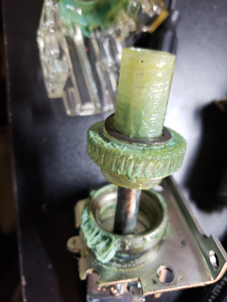

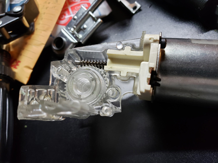

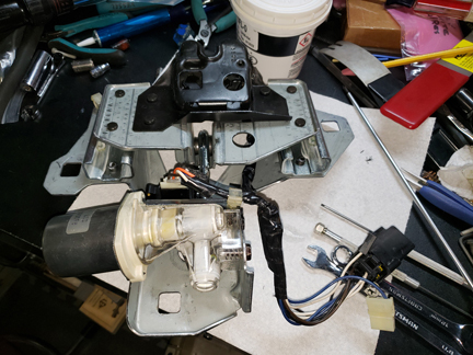

Not engine related....
It wasn't today, but a few days ago I finally addressed the hatch pull down that stopped working (it was in the down position).
I poked at the switch tab and it instantly stared to work, but was laboring and sluggish. I removed the assembly, separated the main parts, found the factory grease a hard, sticky, waxy mess. Cleaned the gearbox and motor, re-assembled and re-installed it.
Lubrication used? Lubriplate DS-ES for the motor bushings, Lubriplate SFL-0 in the gearbox. Lubriplate No. 105 will work in the gearbox as well. No plastic compatibility issues.
I also replaced the dead hatch lift supports.

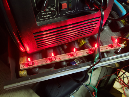

Noticed a few bulbs in the center stop light were out. Being the lazy type and not wanting to venture out on this particular day, I found the bag of 12v, 5mm red LED's I had on the shelf, trimmed the leads and installed them.
These LED's have built-in current limiting resistors so there's no runaway current going through the harness. Hopefully, someday I'll locate a bench top variable power supply at a garage sale.
