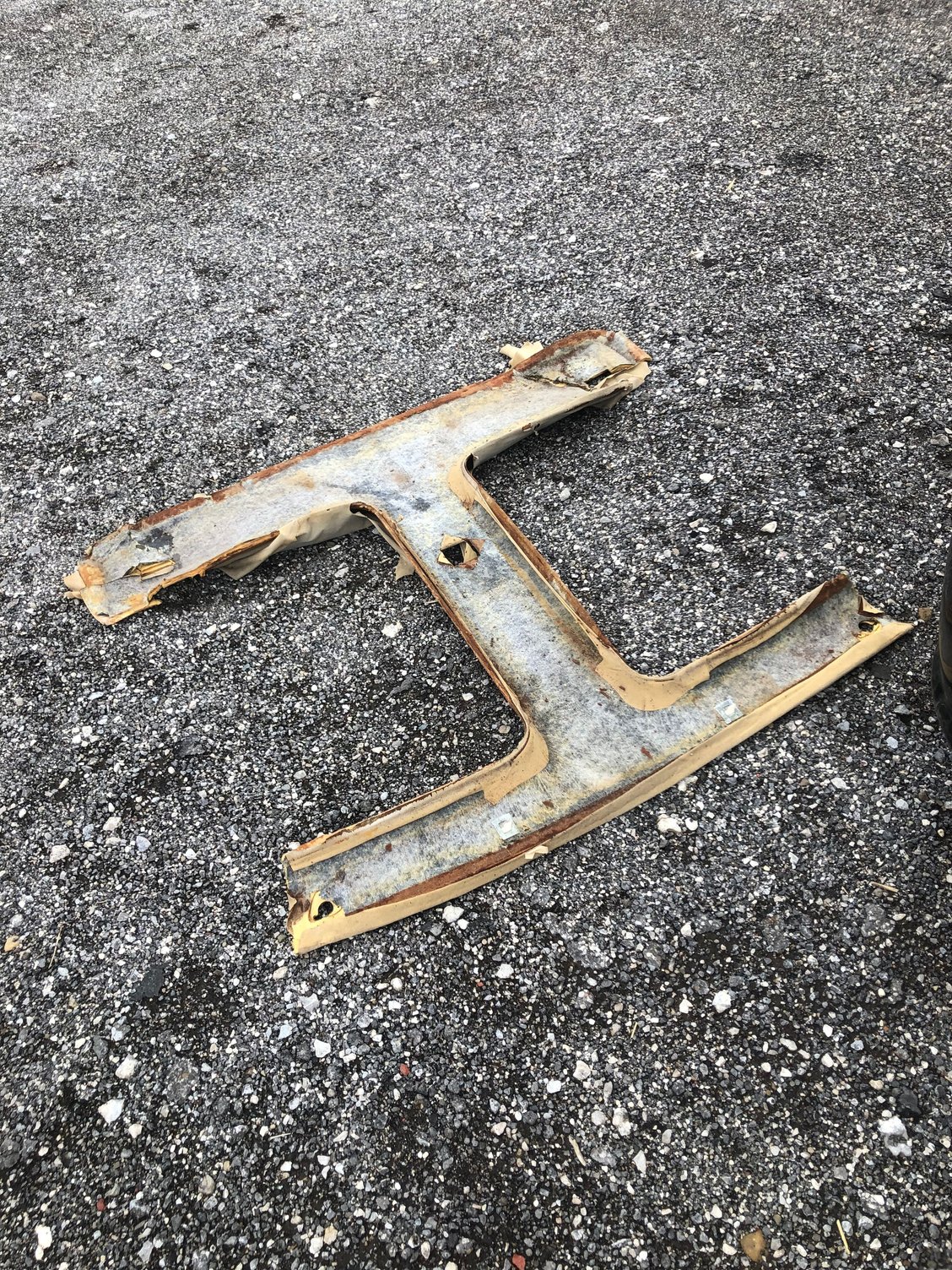

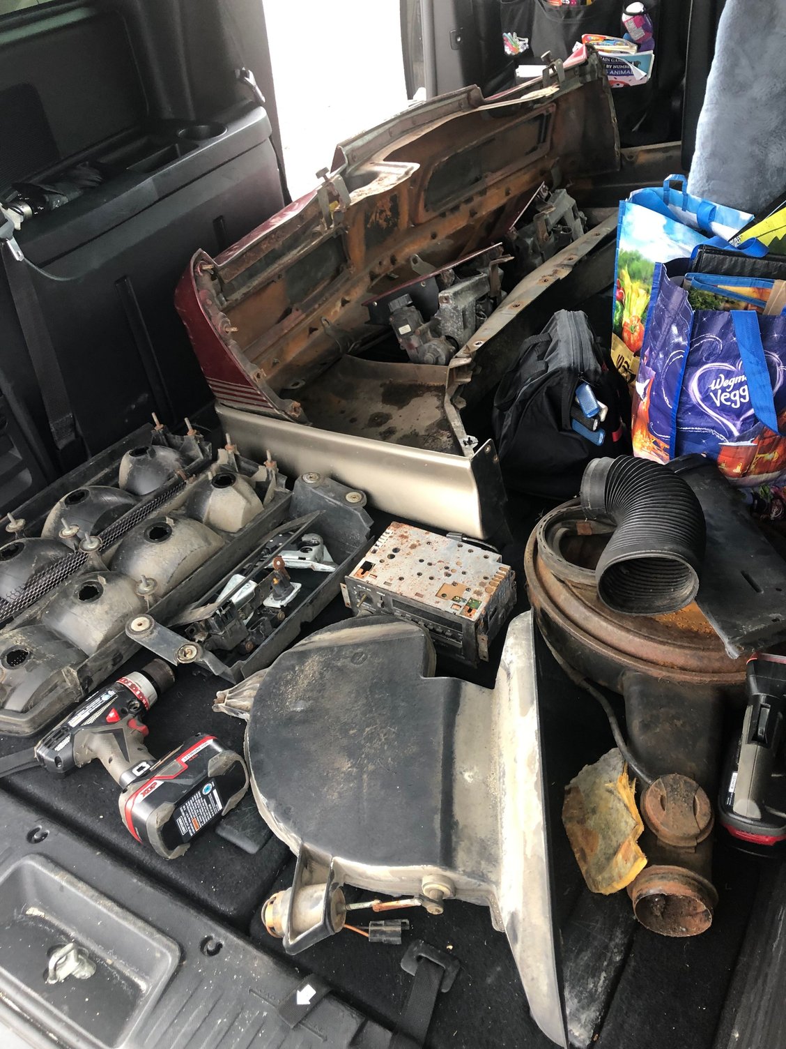

Found a guy on FB parting a 84 TA 3.5hrs away from me. Drove there today and got all this stuff for $560: front bumper fascia with ground effect (ground effect does have cracks though), both headlight assemblies, tail lights, rear hatch latch with power release, factory radio (kinda rusty), radio bezel with no cracks, headlight switch, t-top headliner and all the air induction parts. I think I made out pretty good

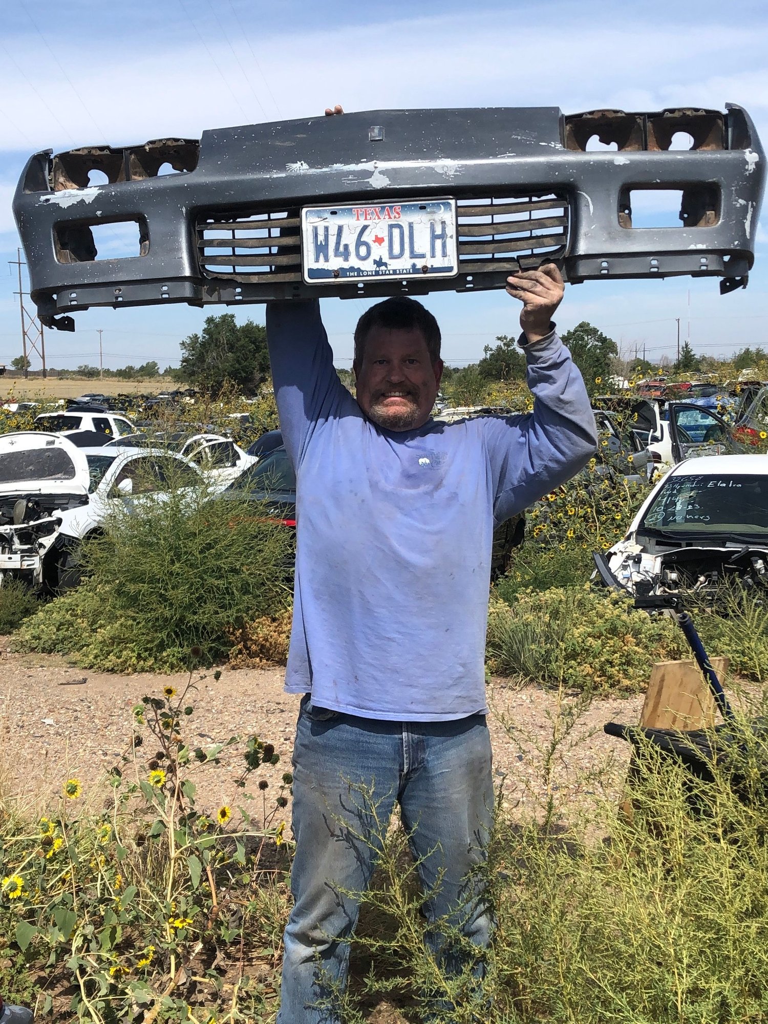

I found a decent nose in Amarillo for $60.
Finally!
Edit: Including the headlight mounting bar and grille, but my old grille is in better shape.

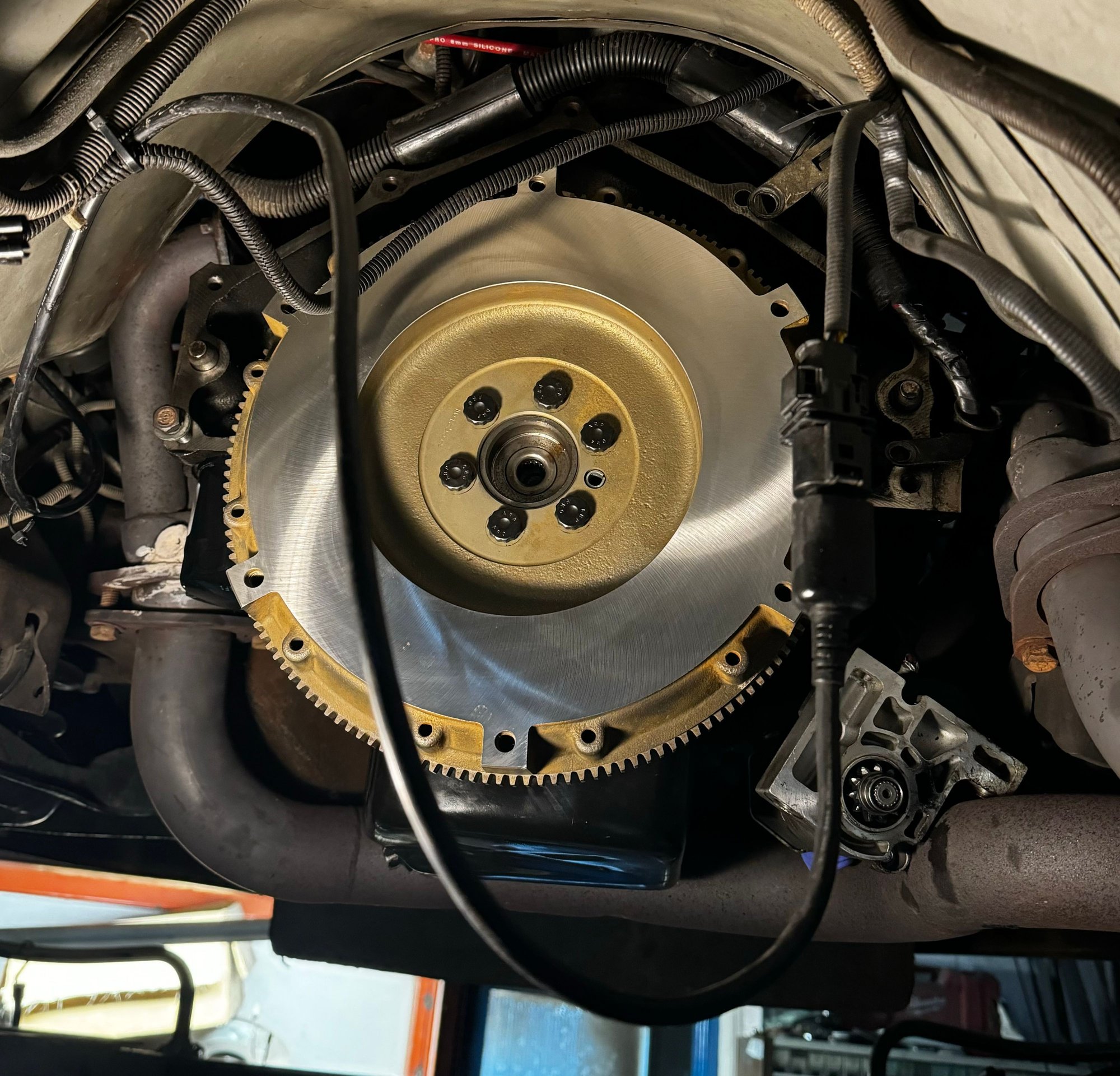

Removed T5, replaced leaking RMS, installed flywheel for T56. Just waiting on a few parts to come in to complete the swap.

Made adapters for these seat tracks (one driver side is now pass side). Anyone think welding my adapters on is a bad choice?
To install these.

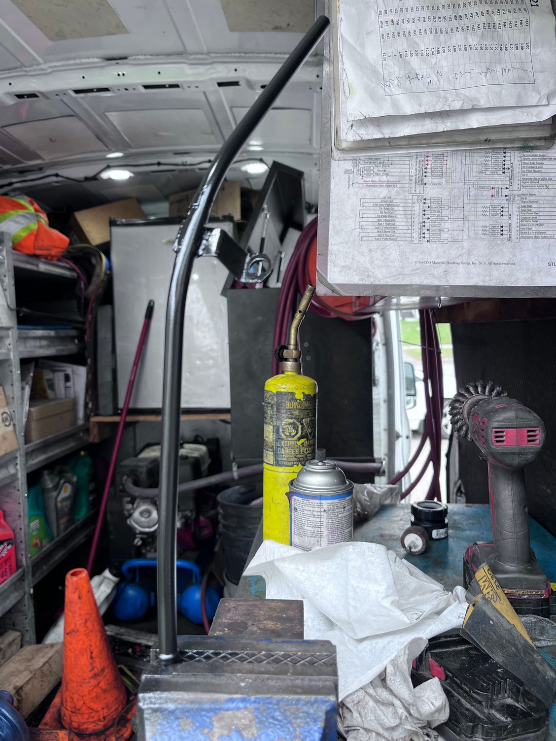

Reworked dipstick to be used with headers.

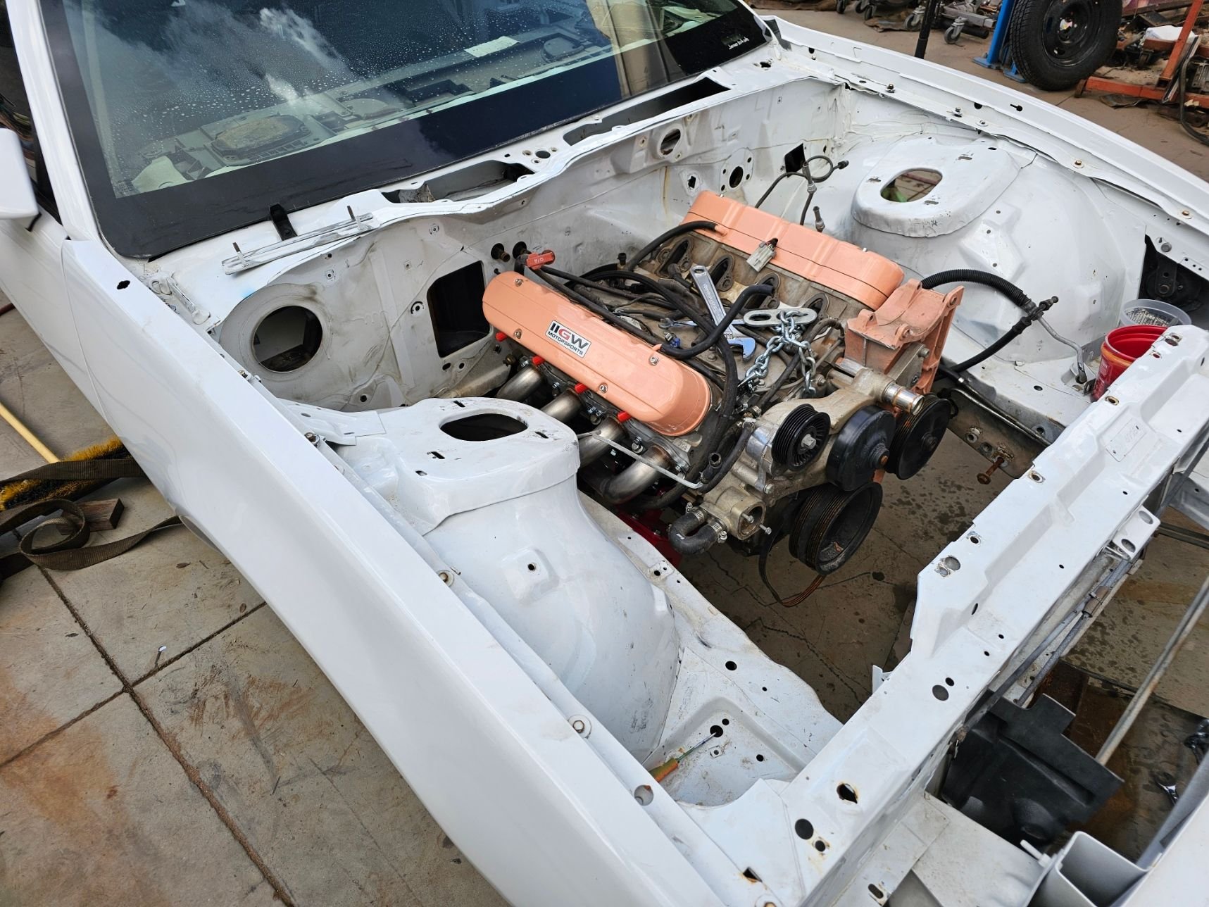

still working on fitting things here and there...
DO NOT waste your time on this.
G body 5.0 engine oil dipsticks bolt right in to an unused 5/16 x 18 threaded hole in the block.
Dipsticks are matched to tubes, so get the matching stick so the oil reading is correct.

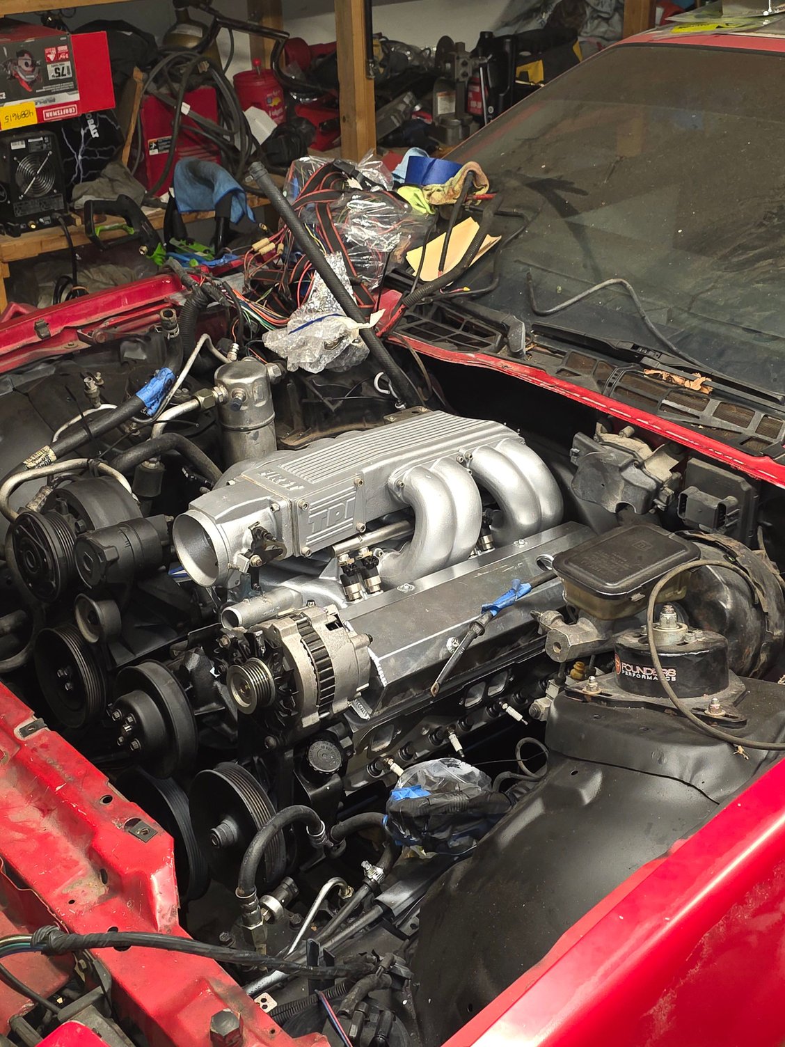

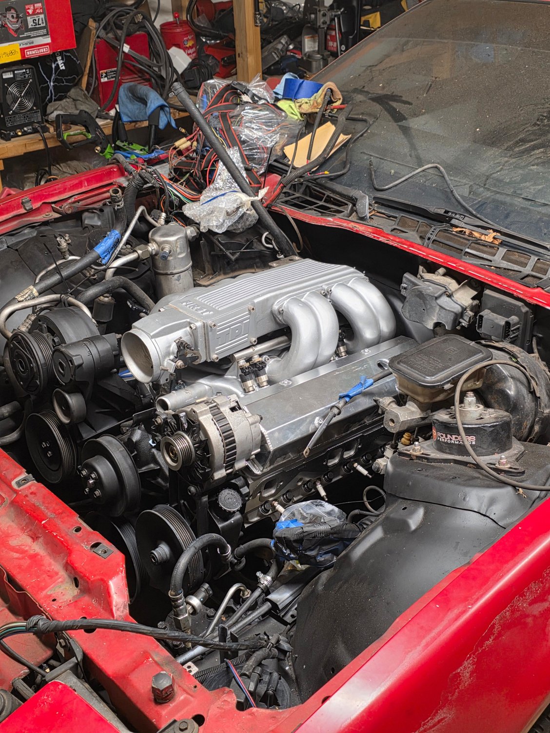

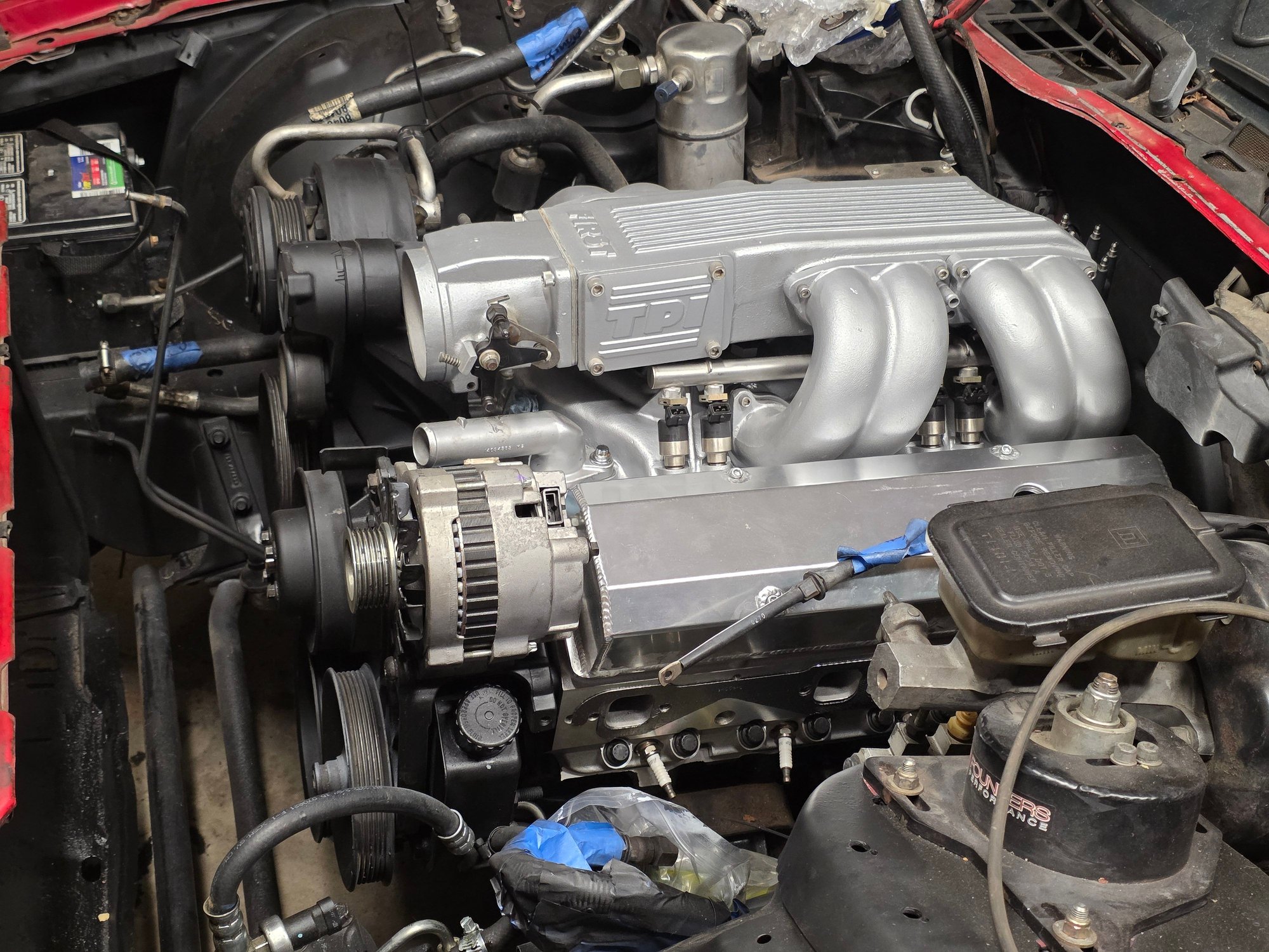

spent a couple hours on the car tonight and got a few things done. it seems like every step forward is another step backwards.
1) driveshaft installed
2) distributor installed
3)upper TPI manifold installed-ish. when i went to install the top i found that the gaskets i have are stock. i have a first TPI manifold and the runners are massive. the stock gaskets a about half the size of the runners. so i need to get on the first tpi website and figure out what gaskets im supposed to have.
4) power steering hoses installed.

You have angle plug heads.
What are you using for headers?
