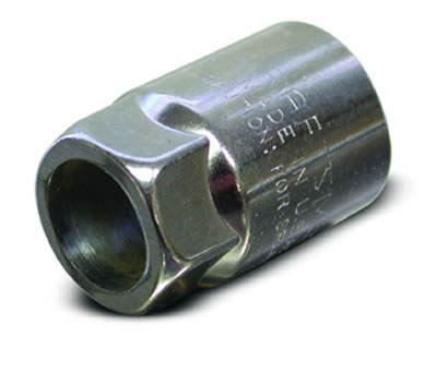

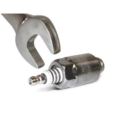

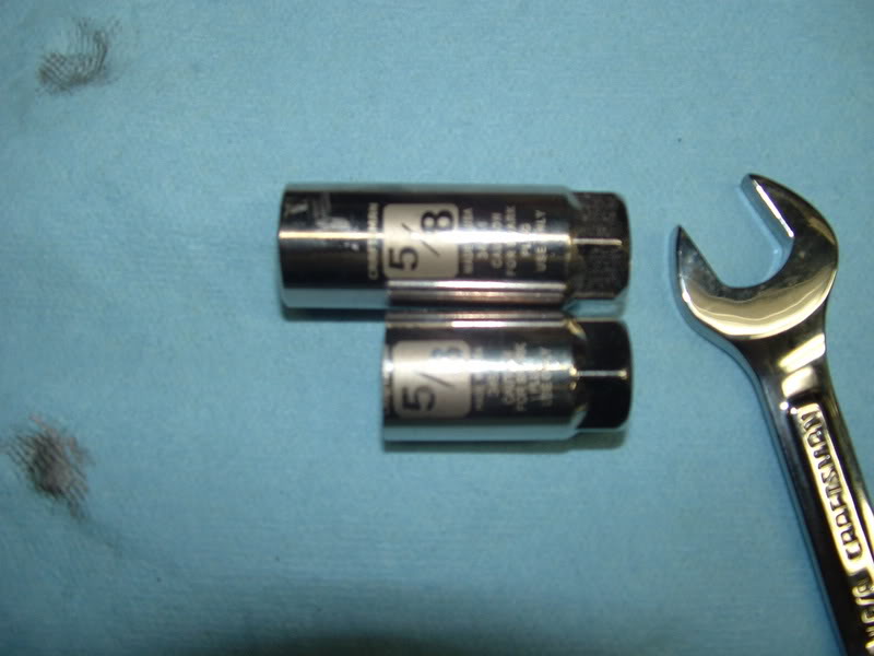

Today I'm installing my rebuilt Quadrajet back in my TA. I just finished replacing all the spark plugs except 6 and 8. The Hooker headers dont make it fun. After trial and error with a bunch of tools, it turns out a simple offset box end wrench did the trick. 6 and 8 look like an underneath job so I'll do that tomorrow.

if you have a carbed third gen(which you do) just use a spark plug socket and a wrench on the end of it.sometimes you can also use a wrench or modify the socket and make it shorter.
chances are the plugs you missed were missed by the last owner too so they are fubared...if you have hooker 2460 headers it should be no issue whatsoever,i easily changed all 8.
of you have air conditioning the rear passenger side plug is a real b itch but worth doing and isnt as hard with the ideas i mentioned.

See attached.
