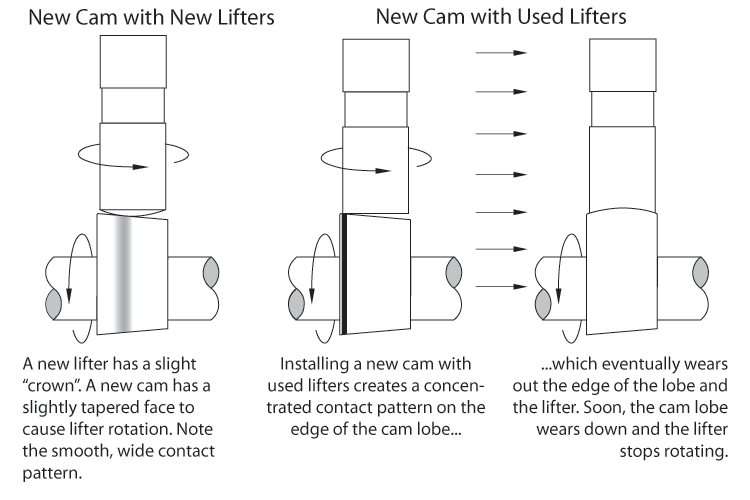

Never use new lifters on an old camshaft. The taper necessary for lifter rotation is long gone. The new lifter with its crown will contact the cam lobe right at the center of the lifter's base = NO ROTATION. In a very short period of time you will find metal shavings circulating throughout your engine = DEATH.
Sure, some of us have gotten very lucky in the past with doing this, but is certainly NOT RECOMMENDED.

Flat tappet lifters need to rotate because they operate with sliding friction (over 200,000 psi) and by rotating, this lessens the wear. With no rotation, they can wear in as little as 20 minutes and become a lathe and send all that sharp metal throughout your engine distributed by the oiling system. This can destroy all of your bearings, pistons, cylinder walls, and oil pump.
Roller lifters, on the other hand, have a roller wheel on the end of the lifter that rolls along the lifter's lobe and cannot rotate. They have to have some sort of mechanism in place to prevent rotation.
You can upgrade to a roller camshaft in your engine, but it is expensive and you have to change many other parts to do so. I know you probably would like to get out of this as cheaply as possible, who doesn't? Stay with the hydraulic flat tappet. I don't know how many miles are on your engine and what condition it is in, but to do this correctly, call Summit and order a K1102 or K1103 cam kit that includes camshaft, lifters, assembly lube, and matching valve springs for your heads. You will also need intake, valve cover, and timing cover gaskets & seal, and break-in oil (proper levels of ZDDP for flat tappet engines). Now would be a good time to replace your valve seals and timing set.
Sorry, I realize that this is probably not what you wanted to hear, but there is no super easy way out of this.
The chances of you installing new lifters, and having all 16 out of 16 live - you probably have a better chance of winning the lottery.
