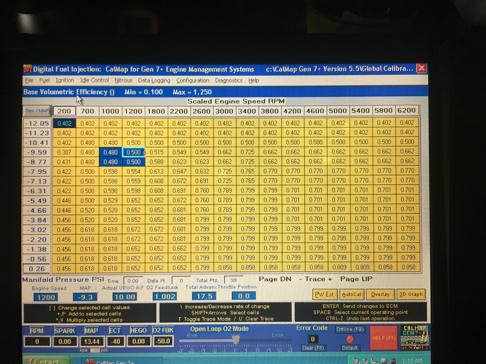

My current tune
File Type: zip

Your screen shots don't really tell me anything, other than the fact that your fuel map has some major issues.

Dare I ask. Been on this tune for 15 years as far as I know. What’s up?

I’ve done a few tunes on super rams and none of them look liked this. You have a Wideband correct?
