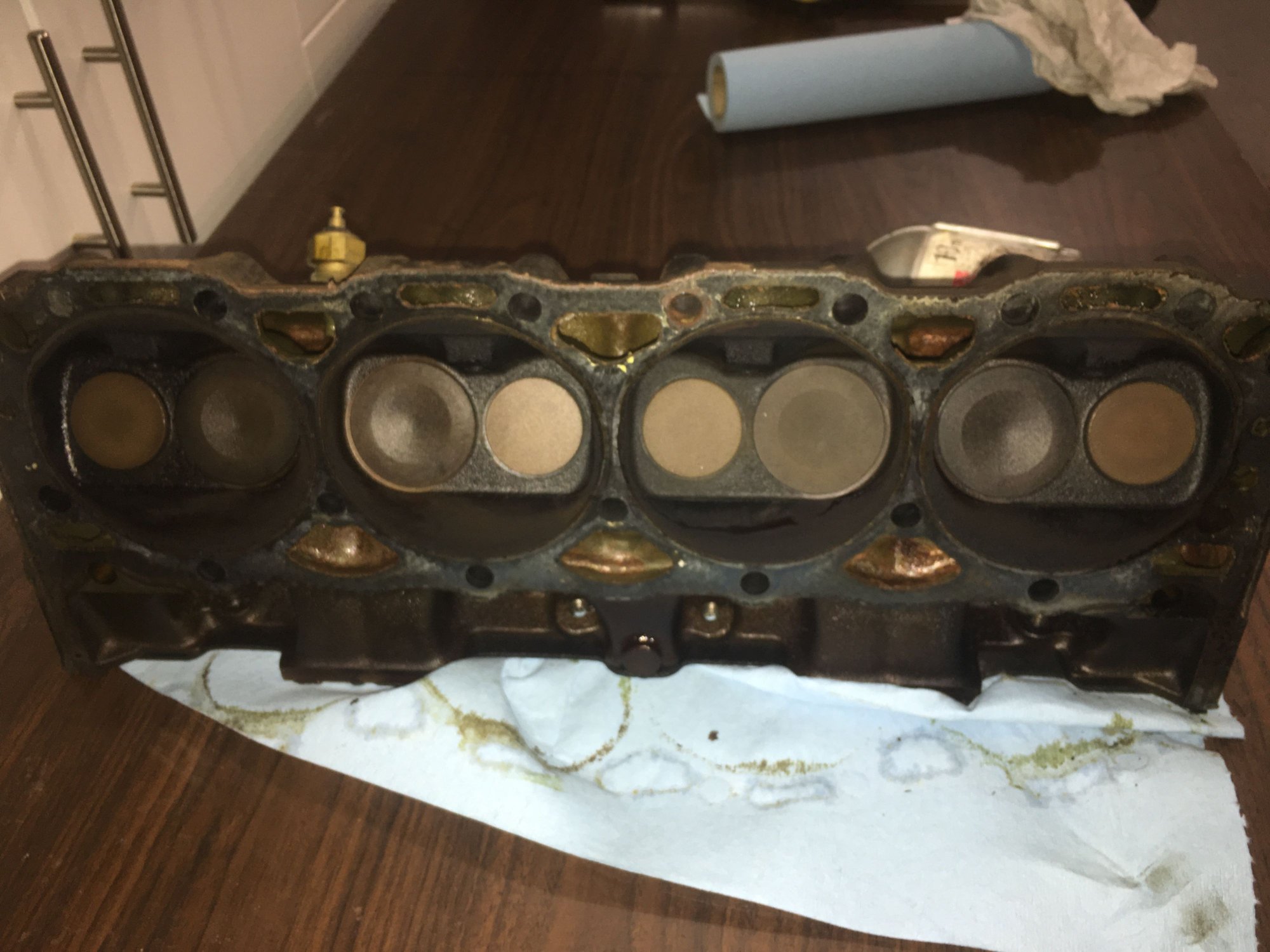

The car has about 48,500 miles on it. some photos as a reference of what I am working with the head and block was before any thing was cleaned up.
In my opinion I don't think it needs to be done as it ran like a top when I pulled it.
But our mechanics in our equipment shop that over hall our heavy equipment and transport trucks think that it is cheep insurance as it is more or less stripped down now.
I have full access to our shop tools and help as needed to ensure all the tolerances are met.

Don't touch it IMO. You will cause more harm than good. That looks excellent. Its not cheap insurance - it will more than likely create accelerated wear if you mess with it. If you do go for it, don't get anywhere near those cylinderswith a hone. Just install the factory style rings and they will seat just fine.

well I thank I am going to leave it as is and clean it all up really good and bolt on all my new parts on.

You DEFINITELY NEED flat-top pistons, going from the stock iron heads to aluminum.
The heat transfer (insulation, if you will) characteristics of the 2 metals, are VASTLY different. Aluminum allows heat (energy, power, etc.) to seep/leak out of the combustion chamber and into the coolant MUCH more readily than iron. As a result, aluminum heads REQUIRE somewhere between ½ and 1 full point of compression, to make the same power at the same RPM, all else being equal.
Heat is what does the WORK in an engine. That's what comes from burning fuel. Letting it escape costs power, esp at low RPMs, and of course, gas mileage. The more that escapes, the more fuel you have to put in to get the same power (gas mileage), and/or the less useful work output you get for any given amount of fuel (torque/power). Meaning, if you make that swap and all else stays equal, your car will LOSE a substantial amount of power. Might even be a net NEGATIVE to the actual HP as measured on a dyno or time slip.
Your cyl walls look to be in good shape, and the rings therefore are probably also in good shape. From that standpoint, you'd want to leave it alone and not touch it. However, in this case, given the nature of the other change you are making (Fe -> Al) there are other considerations besides just that one.
If it was me I'd put flat-tops in it. New pistons, new rings, use the "break-in powder" stuff they make so you don't have to mess with honing the bores. Unless, the chambers in your heads, are 58cc or smaller. (in which case all else is NOT equal...) Post that number (since you didn't put up the part #) and the correct course of action will become obvious.
