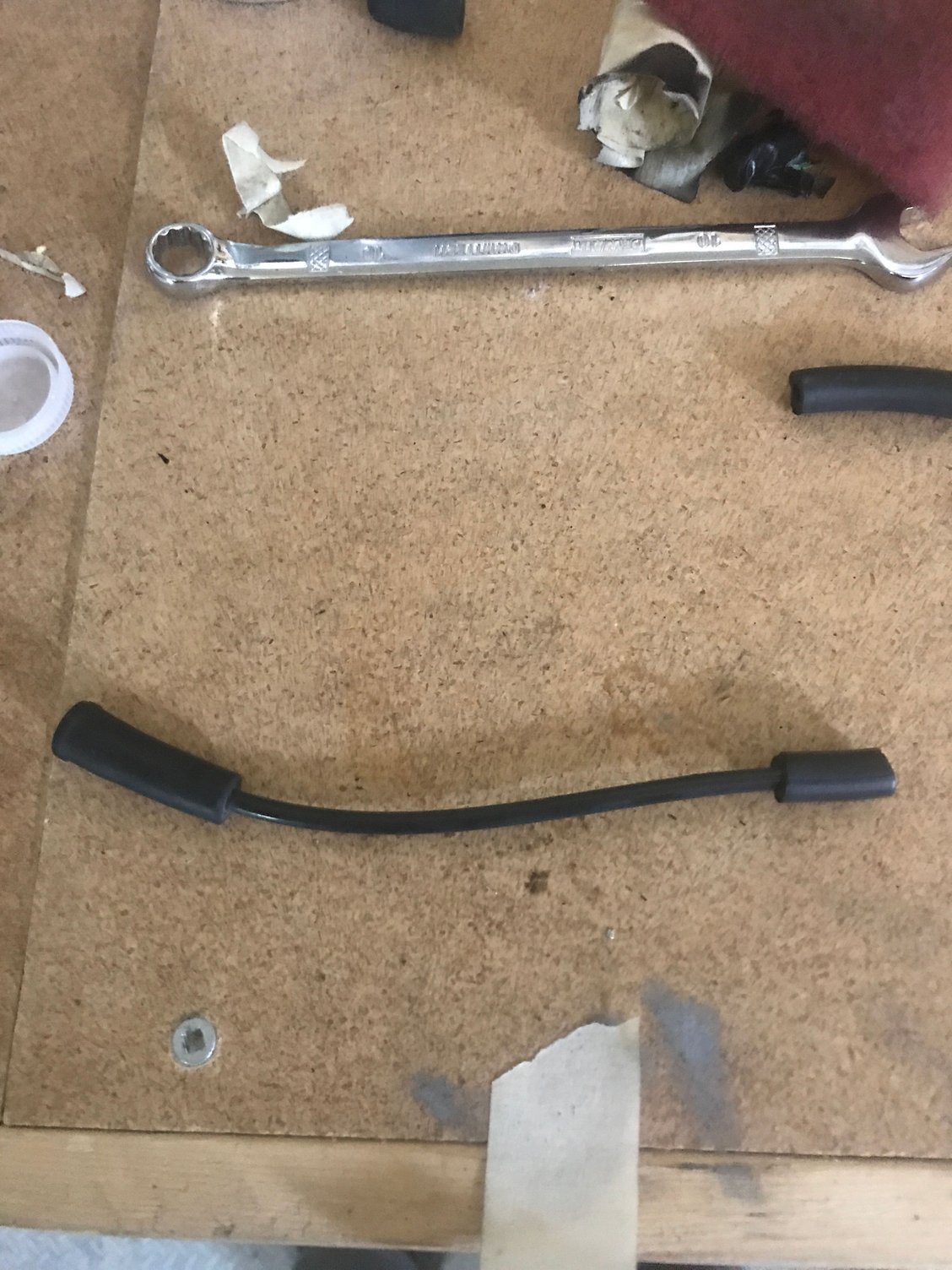

Good day folks. I am working on my 92 RS that I just bought. The valve covers and air cleaner looked like hell so I took them off, blasted and painted them. Now I have a dilemma. There were two plastic lines that were brittle and broke in the process. One goes from the intake into a conduit on the firewall the other one broke off and I can’t even see where it came from. I put new rubber hoses on everything that came from the TBI but I still have these lines outstanding. The one that broke off ran right next to the valve cover. What are these lines for? The HVAC works ok so I am concerned that it’s maybe cruise control? Car is in the garage for the winter so it’s tough to test it.

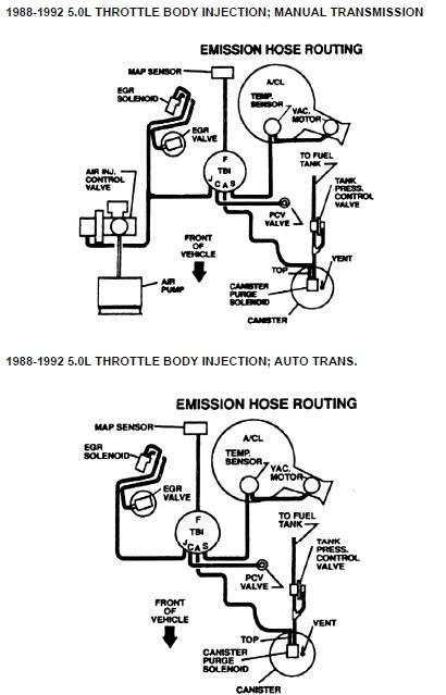

https://www.thirdgen.org/forums/tech...ol-vacuum.html

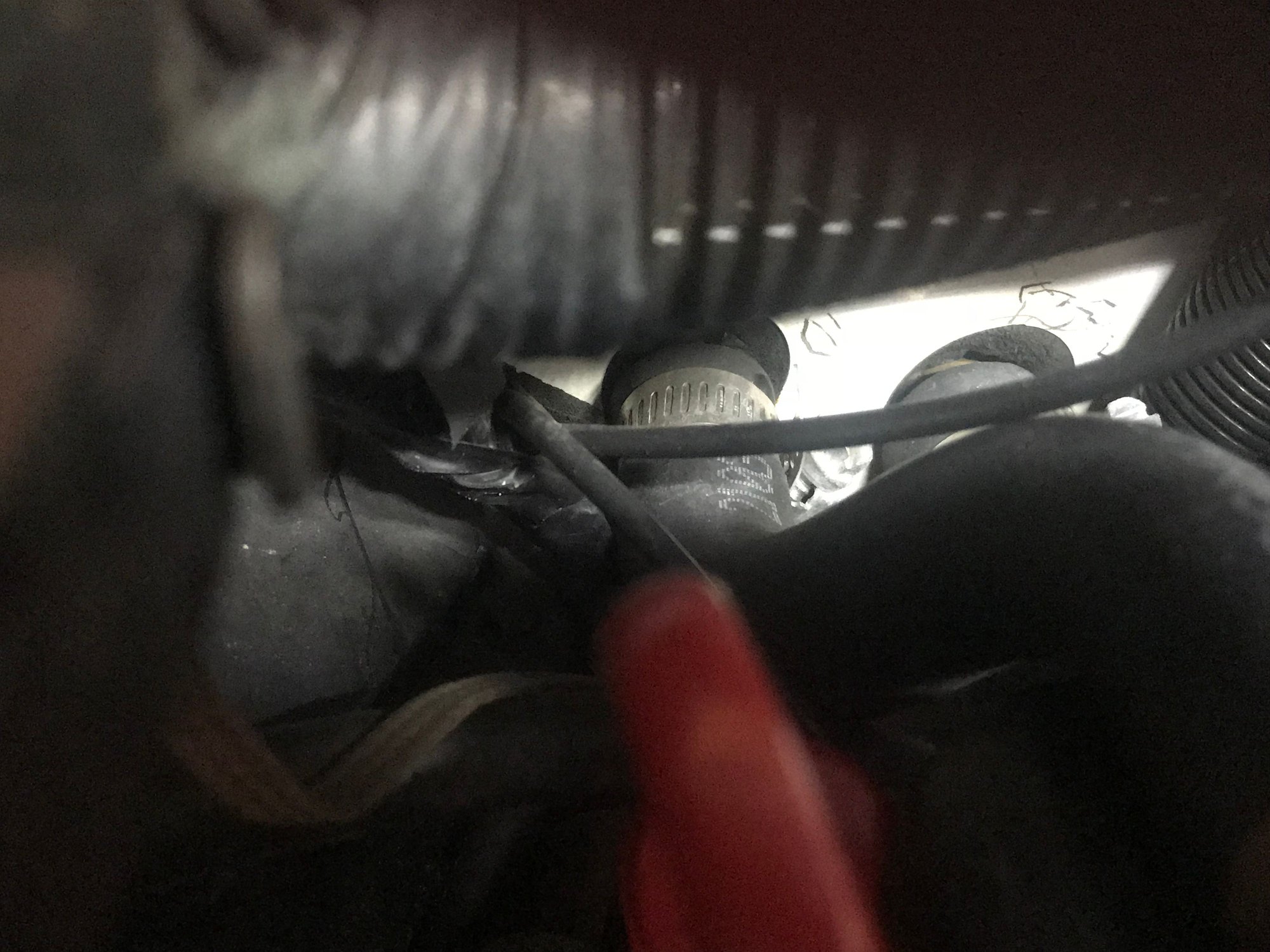

All the emission stuff is hooked up and correct. The photo shows the harness that the line comes out of right behind the tranny dip stick

Could there be a missing t that ties manifold vacuum between hvac and cruise ?
Or is it missing coming from hvac to the heater control valve.

That’s the line that broke off next to the valve cover. I can’t see where it originated from.

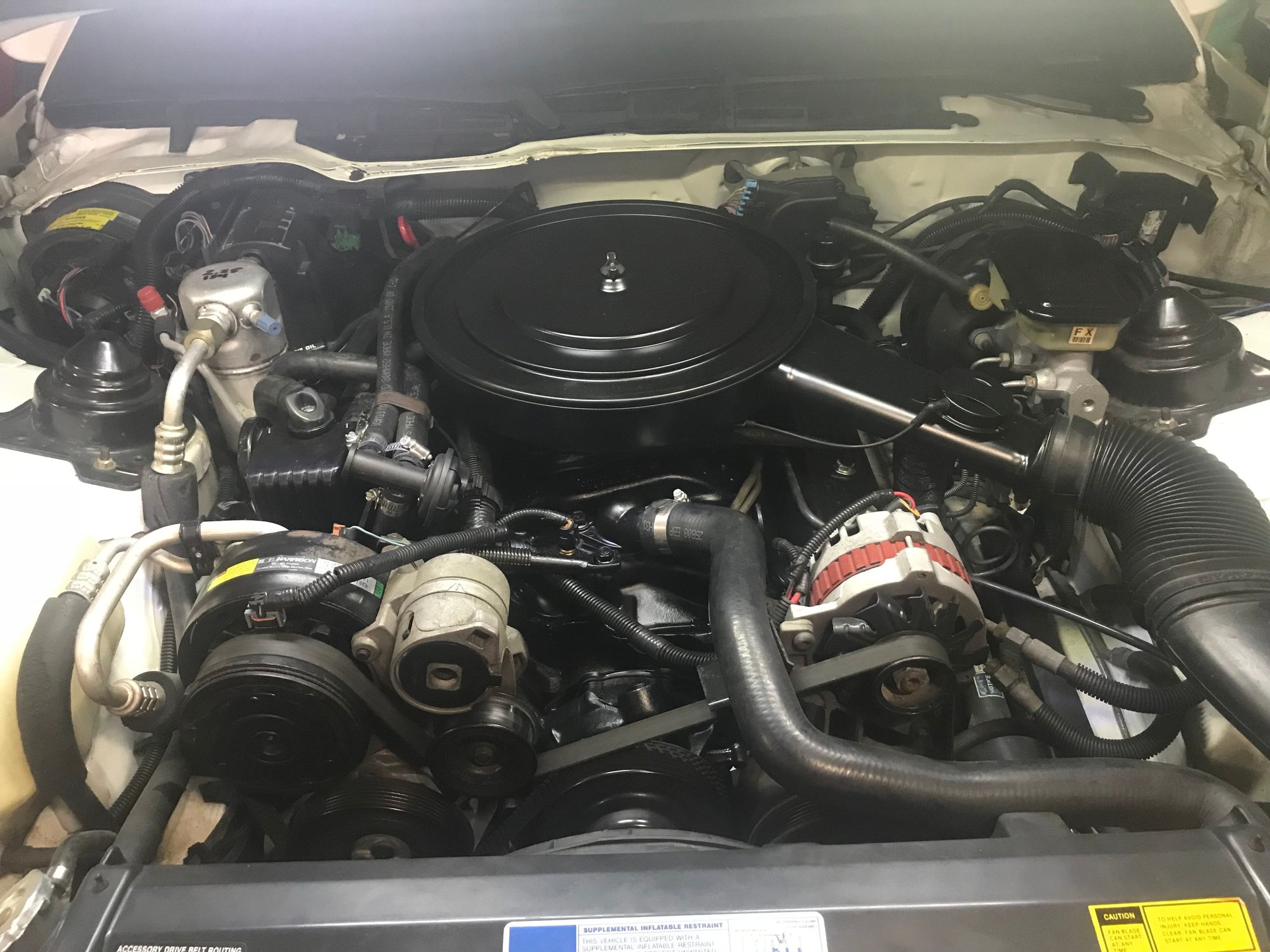

Ya me either but it’s not plated so I can’t drive it. There must be someone on here with the same engine that could grab me a picture on that side of their motor. I can’t use my TPI car for a template as it’s totally different. In this picture is there supposed to be a vacuum line coming off this thing?
That looks like the heater control valve. Yes there is hvac vacuum when heat is requested via the dash switch.
