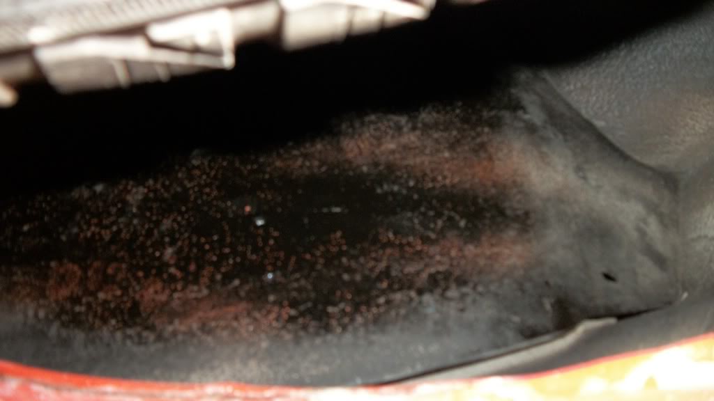

Old Sep 19, 2011 | 02:18 PM
travis401's Avatar
Joined: Mar 2007
Posts: 3,525
From: Arlington, Tx
Car: 91 Camaro RS
Engine: empty bay (for now)
Transmission: Built T-56
Axle/Gears: 3.42 stock posi disc
Re: how to remove my fuel tank
kinda hard to see, but that whole plastic panel there comes off and gives you access to the back side of the fuel filler door, and filler neck.
Old Sep 19, 2011 | 08:32 PM
TreeFiddy's Avatar
Joined: Jun 2005
Posts: 1,380
From: Sydney, Australia
Car: '86 TA
Engine: '74 350
Axle/Gears: 2.77
Thanks for the pic! However, it must be a Camaro thing, my 86 TA doesn't have it. I pulled the interior plastic back, and the filler door off, and it's solid sheet metal everywhere.

Im sizing up removing my fuel tank now too, im pretty sure my filler neck is leaking, ive been noticing the smell of fuel around the cap area for quite a while, so after investigating i saw this
looks pretty dark and wet right where the solder ends. I also want to fit a new fuel pump anyway for when i drop my 5.7 in so i might aswell do both jobs at the same time.

Wonder if it would be better to replace the fuel tank? The fuel has been in the auto 23 years. Then change the fuel lines to the carb.
