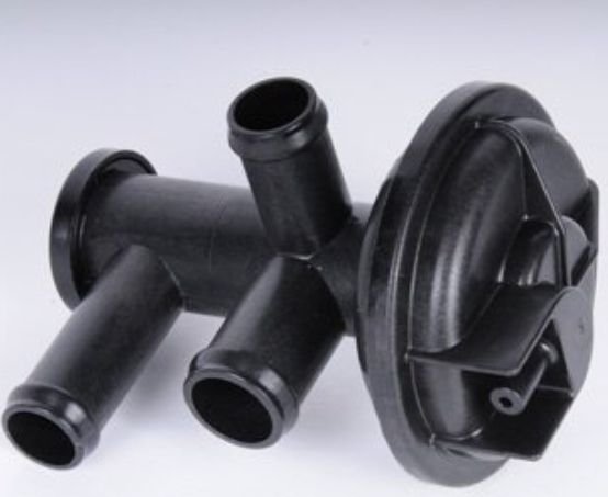

I sounds like the po removes a lot of things. If the heater valve is still there here is what it looks like.

Ahhhh mine doesn't have a heater control valve. Guess its time to get one.
