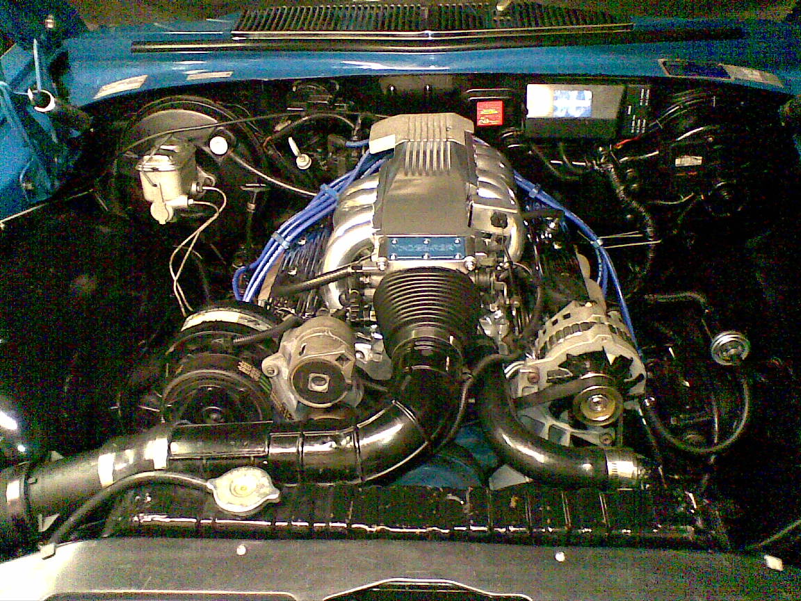

I have a TPI 305 and a TH700 in a 1975 model car (see my profile)
Would like to know, is a MAF or a Speed a better system ?
I have to buy a new Wiring Harness, this car will be driven regular, and there are no upgrades to the engine bar a set of custom headers.
AND Where would you recommend to get one ?
As im in Australia.
Thank you

Speed density, it is more reliable.
Go to the parts for sale forum here, There is a guy in Pennsylvania selling TPI stuff and he has a couple harnesses for sale right now.

Contact John, he has memcals ( computer chips) for a 350 swap.
https://m.ebay.com.au/itm/CHEV-CORVE...MAAOSwT6pVjJ5g

Looks like you might be running the 808 ecm ( mounted on the bulk head ?).a Holden speed density and maf ecm depending on the code being used.
