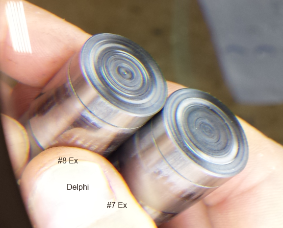

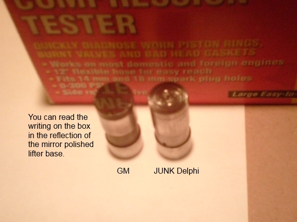

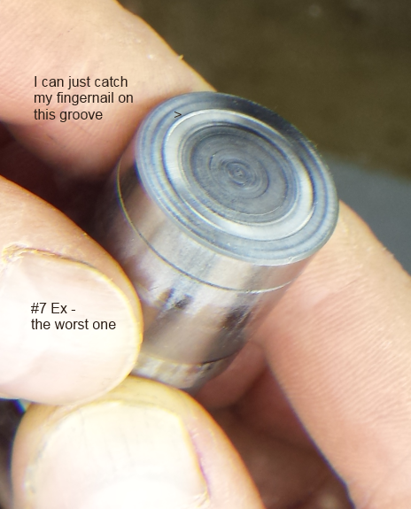

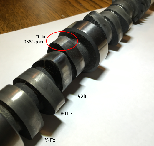

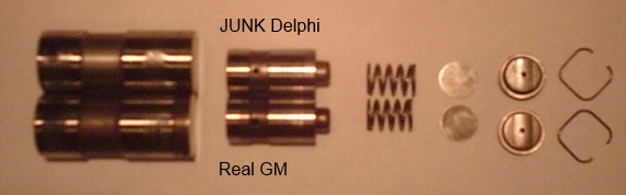

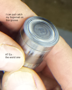

Great question. They are talking about these. Notice the hardface bases. They are a chilled iron alloy that is harder than the rest of the lifter body. They get spun-welded on.
You can find lifters that look like these on ebay and Skip White. DO NOT BUY THEM!
I can tell you a nightmare story about those lifters, but for now I will tell you that the Genuine GM brand of this lifter is great. The bases don't wear like some of the others.
Unfortunately, there are knockoffs out there. There are even people that buy the knockoffs and the GM ones, and throw the knockoffs back in the GM boxes and return them for a refund. Back on the shelf they go, and the next guy comes along and buys what he believes to be the Genuine GM. And he gets burned. Skip White guarantees that his lifters are genuine. THEY ARE NOT! Unfortunately a manufacturer can say "Made In USA" if their headquarters is on US soil. But the products are actually foreign made.
Below are some pics showing the difference between the GMs and the knockoffs that don't work.
The pushrod seat/cup does not have the correct dimensions, which renders the lifter's hydraulic "pump" useless and you get no oil to your rocker arms.
Another option is the lifters with the EDMed hole in the base that supplies a little extra oil to the cam lobe/lifter interface. Grooving the lifter bores is another option. ISKY also makes a great hydraulic lifter.
