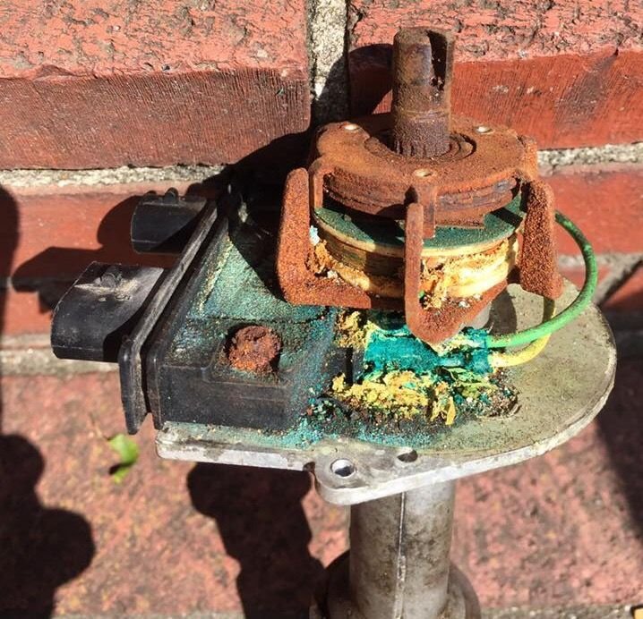

In case you forget, before you pull that distributor, get out your sharpie, and mark every wire, and every cap-terminal, and take a picture of the position of the rotor. Best to move the balancer to TDC position for the rotor-pic. Save yourself the headache.
Even if your distributor seems to be working fine but for the leak, be prepared to be confronted with something that looks like this when you fetch it out of there. This was mine. Still working when pulled.

Wow can't believe that dizzy was still working looks like it spent a couple years at the bottom of a lake.
