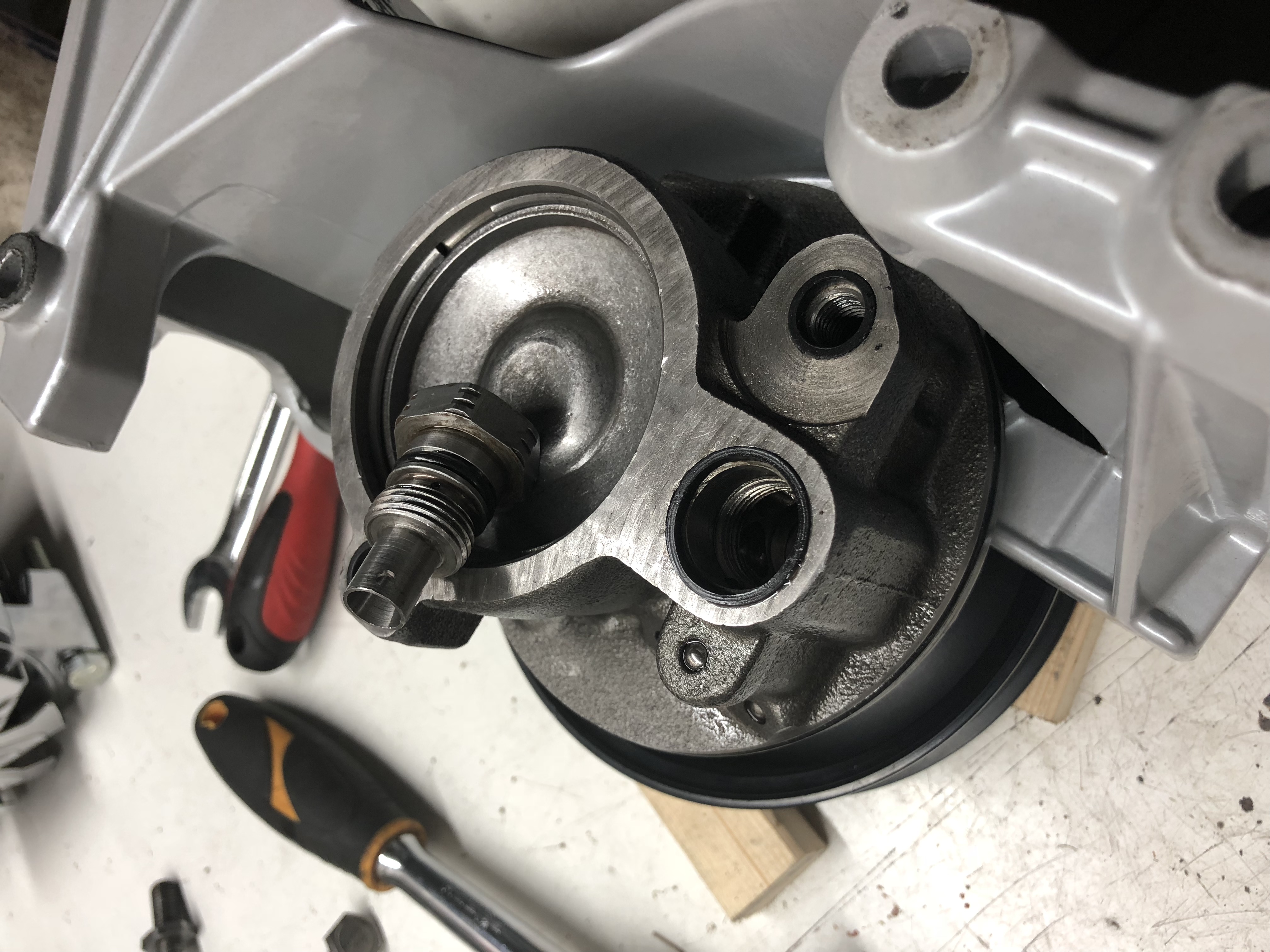

Today I took out the car for my first longish test drive after two and a half years In the making (have my build thread)
I was driving the car when suddenly I smellled like rubber from engine bay (windows down). Steering became rock hard.
Stopped and couldn't see anything unusual. Belt was turning fine. Pas pump had oil in it.
Drove back home and noticed that steering was hard on idle. Revving slightly the engine made it work normally. Was a pain to get the car back in the garage.
I suspected stuck valve so I removed the high pressure line and the large nut just to find out there is no spring and valve. Checked service manual and couldn't decode the diagram properly as it shows the valve like it is on the inside. I forgot how it was a year ago when I replaced the o rings.
So I removed the pump from the car and removed the reservoir but there is no sign of the valve ( picture attached).
Can someone tell me how these pumps work without a valve? Don't think it is on the inside where the vanes are.

Update. Just to be sure I also opened the plate exposing the vanes. No trace of a flow valve. How was it working without a flow.valve? Can I buy these separately? (flow valve and spring)
If I were to get a new pump, would the ones with a key on the shaft instead of press fit work on my car?

Wanted to give you an update...
Managed to source a flow control valve and spring from a used pump. Tried to drop in the valve just to notice it was sitting to high to compress the spring and screw the fitting.
Looked closer for the 100 th time and bingo..... I actually had a stuck valve. I could swear by the looks of it that there was no valve but the proportion of the valve body misled me to believe so.
Anyway ended up tapping the pump to get the stuck valve out. Will clean/Polish it and reinstall some time this week but all should be good.
